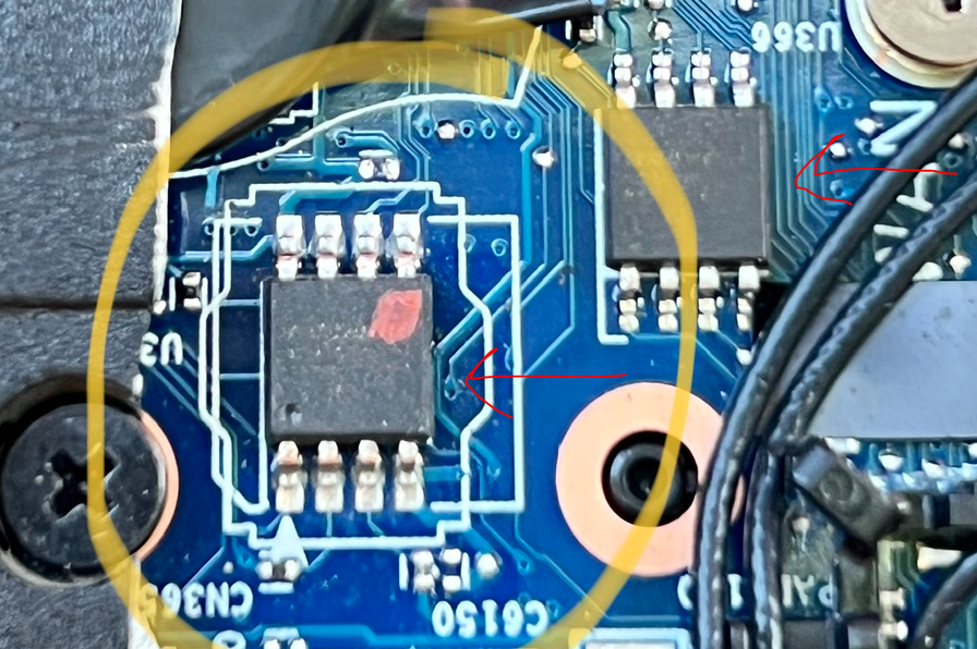

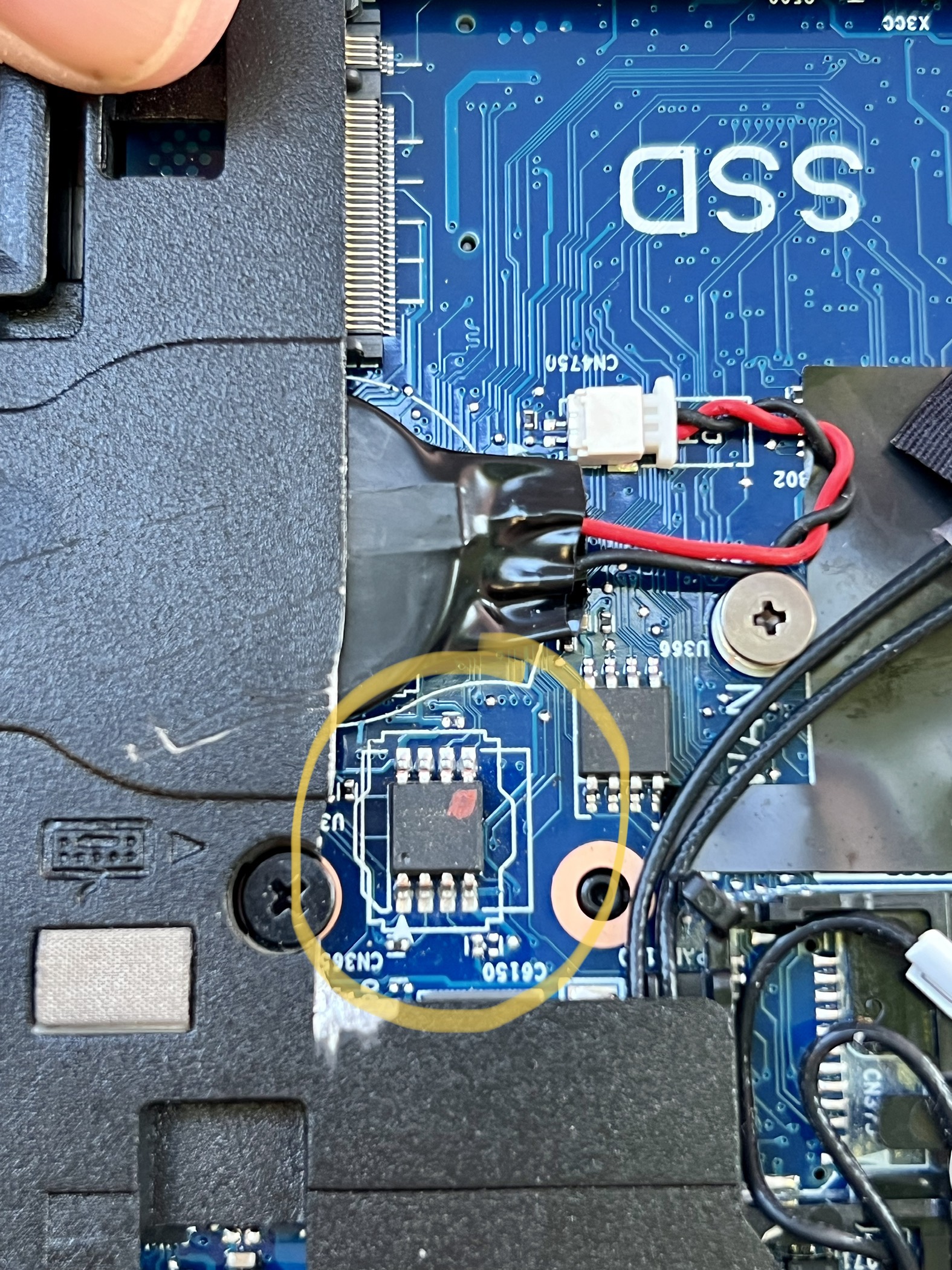

                  Good evening all
                  Got the rework station and going to desolder the chip from the HP Elitebook 850 G1.
                  A couple of things:
                  1. In the attached image is that the correct chip i need to remove.
                  2 is the CH341A programmer OK to read this chip.
                  then after i have read the chip do i just post here and hpoefully one of you guys can clean it up.
                  TIA
                  The NiNja

                    Take a clear image for both chips, we need to see what's written on them.

                      Re: Recovered 850 G1 Bios now the warning machine not in committed state
                      cant seem to get a close enough image with the camera but using a magnifying glass both chips appear to be the same
                      WINBOND
                      25Q128FVSG
                      1417
                      Does this correct
                      TIA
                        WINBOND
                        25Q128FVSG
                        1417
                        Does this correct
                        TIA
                        The NiNja
                        No, U366 is 2MB (16Mbit).
                        Upload the content of CN365 chip, the one you marked it by a circle (25Q128FVSG).

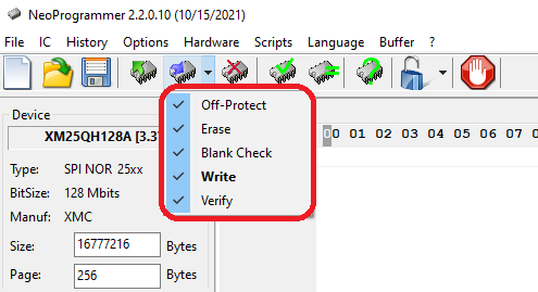

                                  Yes, you should erase the chip before the writing process.
                                  If you are using NeoProgrammer software, you can check these 5 options and press on the "Write IC" icon and it will do everything automatically.
                                  all donations are welcome,
