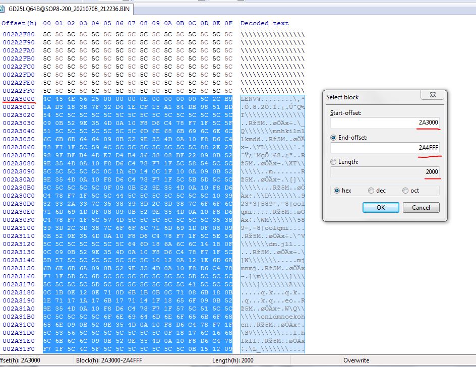

                Re: bios dump lenovo 330-15ast please
                hi please someone can help me i have the same problem i need to add dmi to 8UCN17WW.ZIP , OR JUST GIVE ME A LINK WHEN CAN I FIND INFO TO DO IT THANK YOU
                THIS IS MY BACKUP
                  • 22293
                  The dmi in this bios is crypted.Use a hex editor and use the text search,and look for the word LENV ,it will start at 2A3000. Select the block from 2A3000 - 2A4FFF ,copy and paste it into the new bios,by selecting the same block range.

                  • ismaelstepheno
                    • Jun 2020
                    • 234
                    • UE
                    Ok thank you very much my friend
                            HxD hex editor https://mh-nexus.de/en/hxd/
                            Thank you! Safed my Lenovo! Great job!
