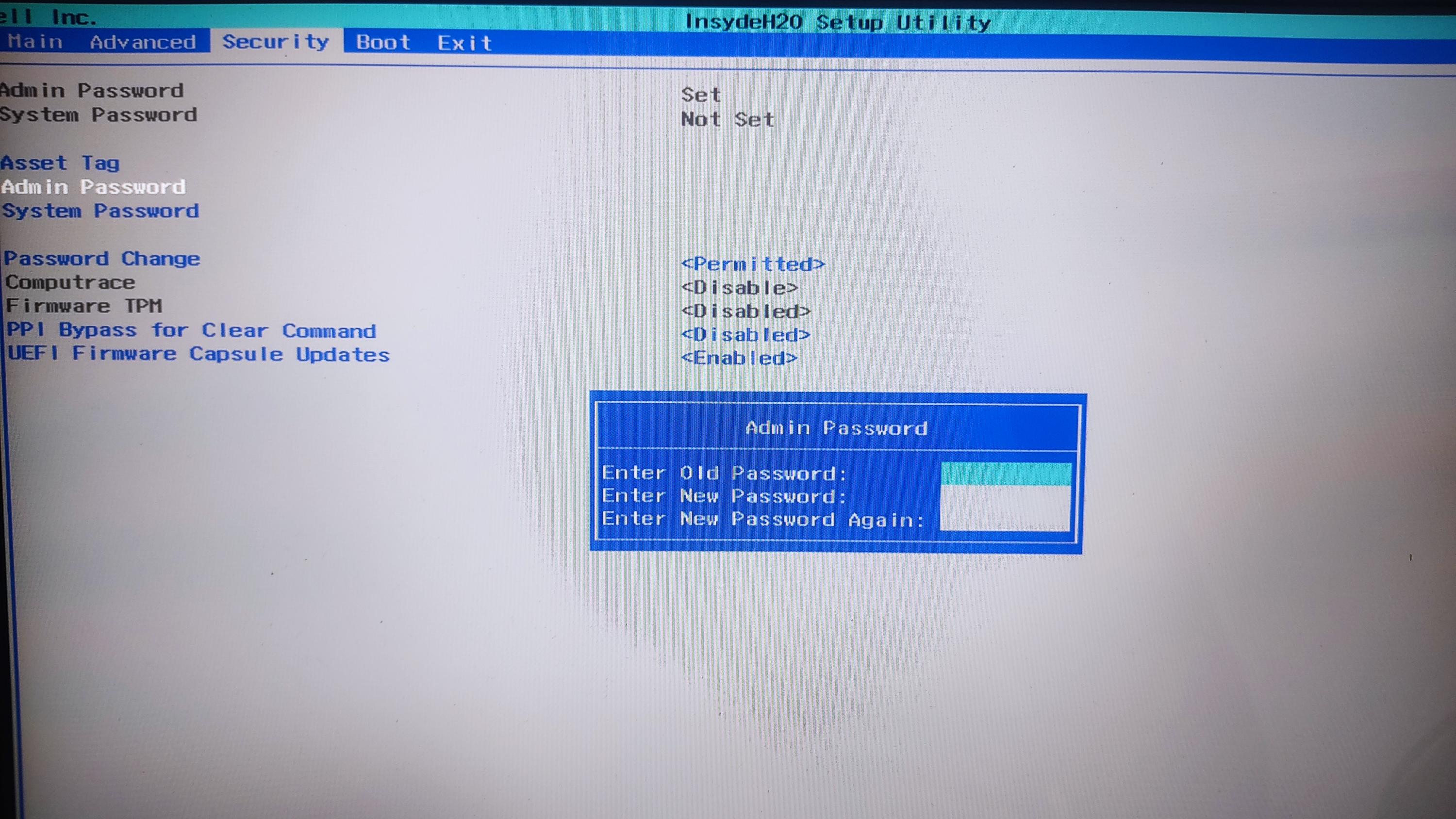

    Hi everyone.
    i have this laptop.
    this model is amd ryzen cpu.
    i want to this bios and saw this thread.
    https://www.badcaps.net/forum/showth...light=LA-F121P
    write bios but not clear bios password.
    i used unlock dell bios seller solution.
    but not clear it.
    if you know unlock this bios,please teach me.
    i attach my bios.
    thanks.

      Seems like this model uses System Disable 16-hex code.

        Re: DELL Inspiron 15-5575 CAL51 LA-F121P Unlock BIOS
        Thanks reply.
        oh inside password in kbc...
        I see 16hex code.
        gen code enter bios but not clean.
        (Change all menu but not password clear)
        show locked setup.can not use gen code.
          @Sato
          You just have to modify the instructions, CTRL-ENTER-ENTER (instead of just ENTER) as in Latitude and similar models.
          Type: 8-digit password + (CTRL-ENTER-ENTER)
            enter the 16hex 8digit code.
            admin password is not clear.
              enter password again for old password, and leave new password empty ( just press enter )
                Hi
                Enter password 8digit password.
                show password is incorrect.
                • Sato
                  • May 2017
                  • 34
                  • Japan
                  Thanks AAAC.Clear password.
                  set system password.
                  After press CTRL-Enter-Enter and 8-digit password.
                  Clear password.(Admin+system password)
                  Everyone thanks support!!

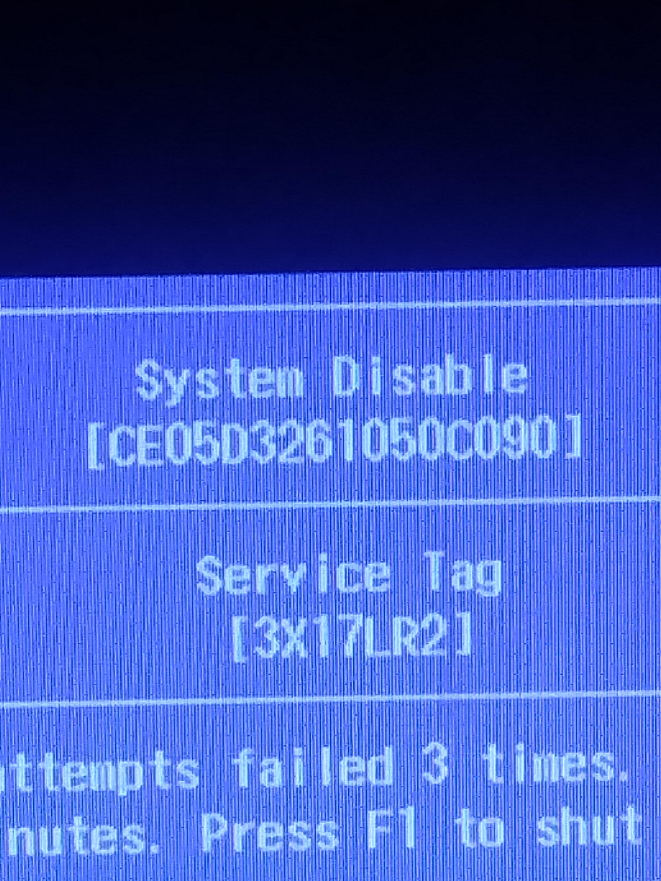

                    please generate a password for me
                    dell 16 digit hex bios password
                    428262F1F3F39528
                    Service Tag: GQB5242
                    thank you in advance.
                    • onizzbox
                      Banned
                      • Nov 2018
                      • 604
                      • Brazil
                      428262F1F3F39528
                      Password : 98231710
                      In laptop: Type the unlock password and press <Enter>.

                          • alexinquest
                            • May 2012
                            • 21
                            Looking for help with resetting password for Dell Insporon 15-5575.
                            • onizzbox
                              Banned
                              • Nov 2018
                              • 604
                              • Brazil
                              @alexinquest
                              Turn on the computer and enter the wrong password three times. This will lock the computer and display a "System Disable" key.
