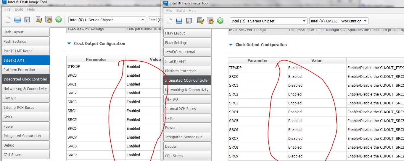

    I received this laptop, i dont know history of it .... it was turning on but fans were not working and no picture. I had all the voltages.... So...i found bios with cleaned ME and it was working perfect. I installed everything but cpu temperatures were much to high. So i put termal paste but it was not much better...then i read that new bios versions are better and more stable...so i tried to flash from asus flasher the newest bios 312 (this one is 306) but flashing new bios didnt go fine. After flashing no picture on the screen. Then i dissasembly laptop again and reprogram bios with same cleaned ME mentioned above...it was working again...but this time i noticed something else...if i change one thing in bios, for example fast boot from enable to disable it will be ok..but if i restore to default bios and save it... i am getting black screen.
    So, what is going on? i dont understand? Is something wrong with the bios?
    I attached in first attachment not working bios from laptop when i received it (althought it might not be original), and in second attachment it is bios which is working on laptop (only if i dont flash it or try to change it to default)
    Thx for help.

                                  • 21679
                                  Re: Asus g752vs strange bios problem
                                  Ok so your CPU is an i7-6820HK ,it has an unlocked multiplier,other G752VS models have the HQ.
                                  The original bios you posted and the working bios (from an G752VS OC Edition i assume) ,have some differences in the ME settings.The ME firmware version is the same but its got custom settings,usually its not a problem with asus and cleaning the ME FW is straightforward.
                                  Its the reason why cleaning your original bios ME FW didn`t work,or any other dumps.I suspect that the original bios had its ME FW cleaned before you got the laptop with some 3rd party software,or your bios region was merged with another dump.
                                  When you clean the ME using FIT (flash image tool) the settings that are set by the manufacturer are saved and the settings are then applied to the cleaned ME FW.
                                  See attached picture for some of the different settings between the 2 ME firmware versions,the working one is on the left.
                                  EDIT: its just my theory,i didn`t have a bios from another G752VS OC Edition or 60NB0D70-MB1140 motherboard to compare it with
                                      Sorry to bring this topic back but i believe someone will benefit from it. So, this laptop was finally fixed....the problem was cpu...but i waithed a lot to find a cheap and working i7-6820hk cpu to replace.
                                      history: ....this laptop was broken and finally was working with only one bios dump on the google i could find..and that was engineer bios dump i found on some foreign site, But if i tried to change anything in bios the laptop would not post. Also, if it would post i could see in windows and cpu-z program that it is running very hot like 98C, and voltage was arround 1,45 v. but even then it would freeze sometimes. The funny thing is that i used one program (i believe cpu-z) in windows to lower the voltage it would be ok...for days...but if i restart laptop it would not post again.
                                      On vcccore when working i have 1,45 volt...and when not...usually 0.8 v. and on this cpu 1,45 v is really high.
                                      Conclusion: this gaming laptop had overclocking option and i believe that option fucked cpu...the strange thing is it was semi working..but only on 1,45 volt?!
                                      I have never seen cpu to semi work/semi defekt.
                                      Replacing cpu ...fixed everything...now cpu is running on 0.8 volt, stable and cool.
