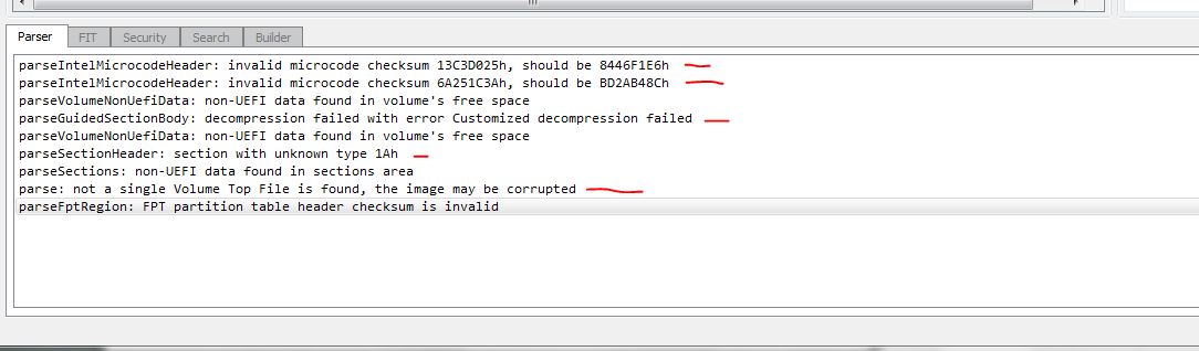

    hi, I'm looking for the bios for a hp 350 g2 L8B07ES, serial number 5CG6113FHM, Winbond chip 25Q128fv, it turns on and loads the system but with black screen, also tried external monitor

      this is the old dump, but the ch341a says: chip main memory with the contents are in desagreement

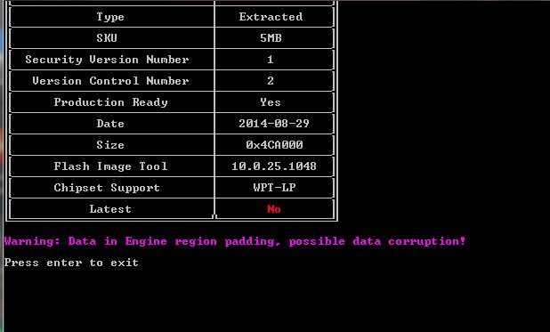

            Try AsProgrammer software,it works better with winbond chips.The CH341A software will often say its verified even when it hasnt written anything.If the virgin bios posted by @peste isn`t working then the problem is somewhere else.

                        The bios backup is corrupt.Maybe the bios chip is dying. Try another bios chip,and the virgin bios.If it doesn`t boot with a new chip and the virgin bios its not a bios problem.
