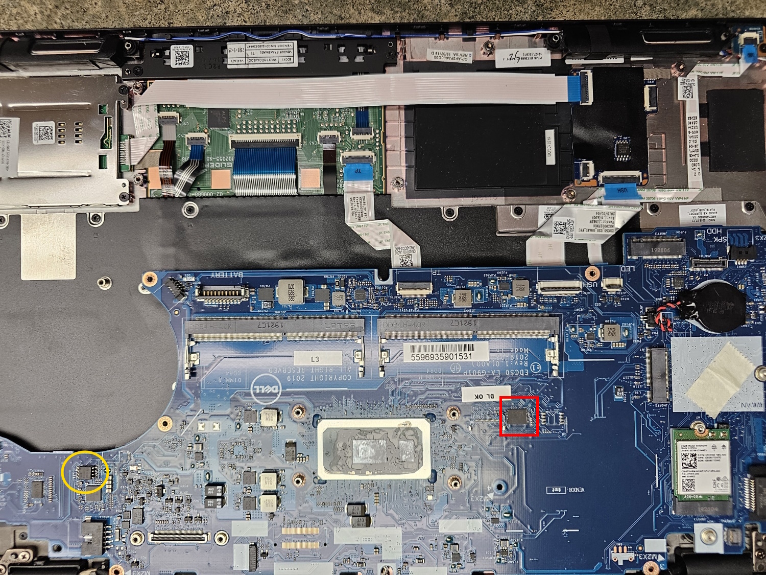

                                  I have a Dell Latitude 5500 with a BIOS password. Service tag is 6NV40R2. The motherboard is an LA-G901P Rev 1.0. Attached are the contents of the two EEProm chips on the board (25Q256JVEQ and 25Q80CSIG) read using an xgecu T56 programmer. Can someone remove the password or provide instruction to remove it?
                                  (edit: added pic of eeprom locations for those that come across this in the future)
                                  Last edited by brock-s; 08-21-2024, 02:27 PM. Reason: Add picture of eeprom locations
                                  • LatinMcG
                                    Old Soft Member
                                    • Jun 2015
                                    • 73
                                    • USA/Puerto Rico
                                    #337
                                    enter service tag and update bios after.

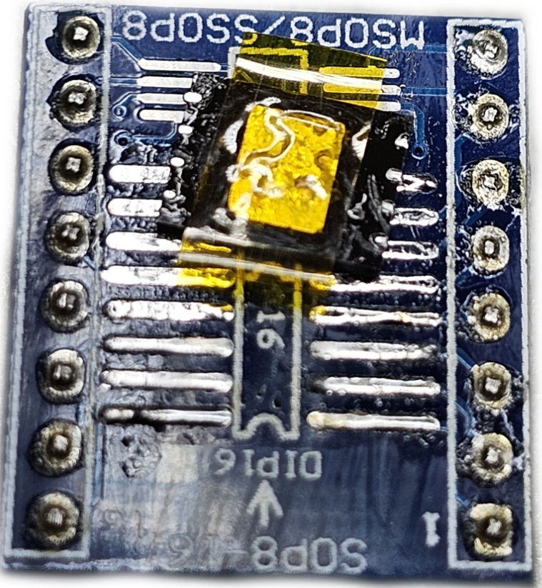

                                      Thank you! That worked
                                      For anyone that comes along at a later date and has problems reading the WSON (TDFN) eeprom chip, there is a large central ground pad on the bottom of the chip. At least on some programming adapters, this ground pad can contact the outer data/power pads. See attached pic's. (Note: I've put kapton tape over the central pad in this case to prevent unwanted connections). (please excuse the flux mess - should have taken pics after cleanup). Hope this helps someone.
                                      Last edited by brock-s; 08-23-2024, 08:29 AM. Reason: edit: upload better pictures
