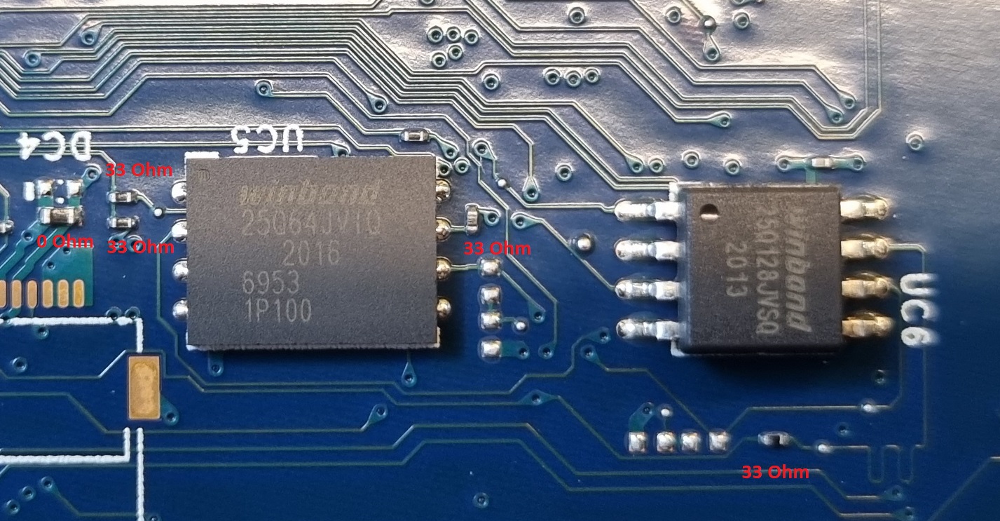

            Originally posted by myhamor
            Hi! can someone share photo of motherboard LA-G901P here? I need near main bios flash, to check if correct resistors are available?
            Hi, attached photo with described resistors.
            this one over uc5 undescribed is 0 Ohm.
