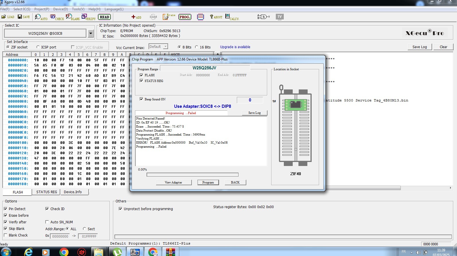

                                    #398
                                    programming failed
                                    • hoaca388
                                      • Jan 2022
                                      • 11106
                                      • Viet Nam
                                      #399
                                      Originally posted by horizonrdf
                                      programming failed
                                      Look the picture
Name:	2025-03-08 15_31_54-Mật khẩu Bios Dell Latitude 5500 - Badcaps.png
                                      Become a Badcaps supporter
                                      Thanks to all supporters.
                                      • horizonrdf
                                        New OLD
                                        • Apr 2019
                                        • 15
                                        • tunisia
                                        #400
                                        what you mean freind
                                        this is a TL866 plus this location in zif socket is correct
