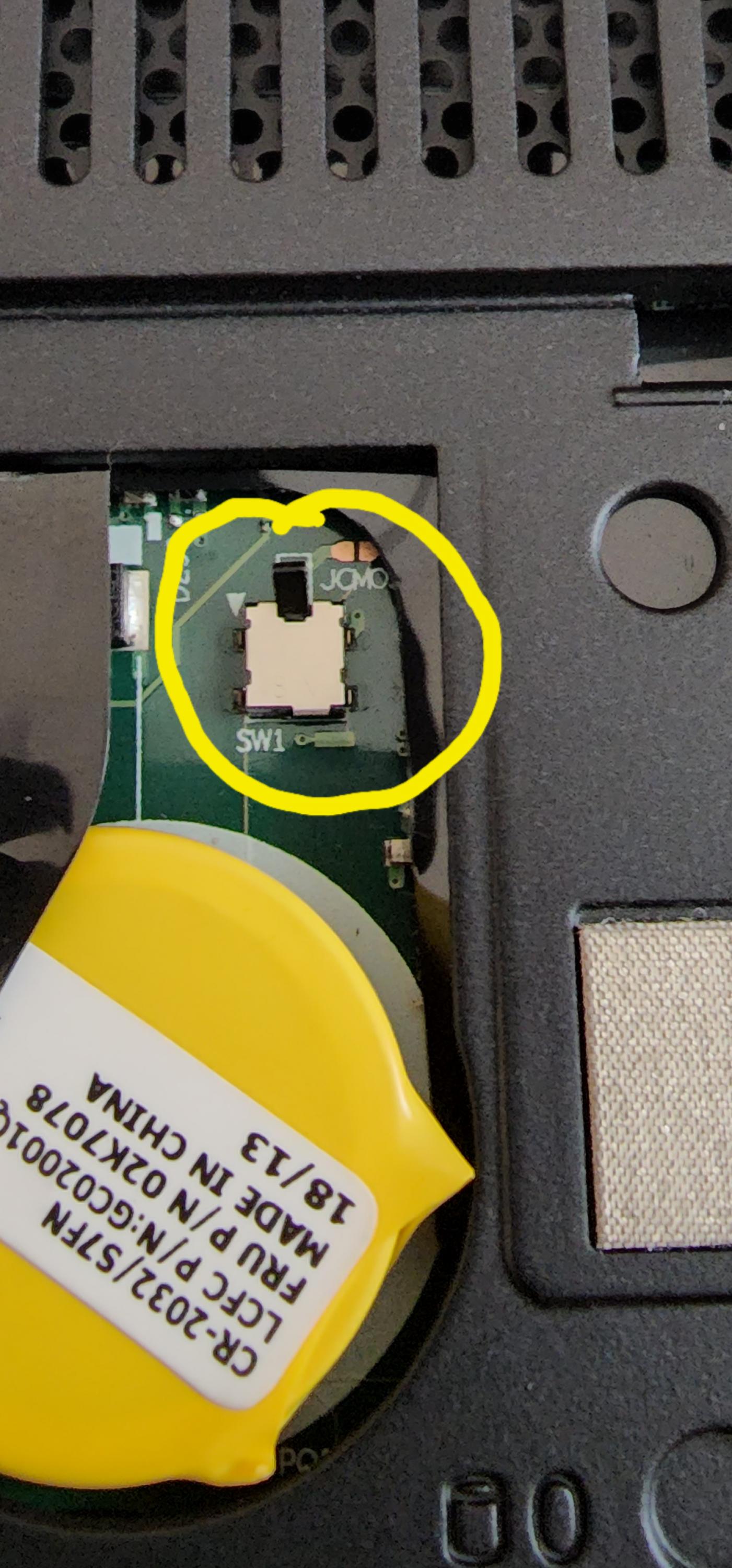

                                Regarding: Anti-tamper Switch
                                This is not an issue I have, but I have seen this mentioned before.
                                I googled "anti-tamper switch", but cannot any matching results, apart from switching on and off in the bios.
                                1. Where is this located on the physical computer?
                                2. Can you provide an image as an example?
                                Just need to know just in case I encounter that problem.
                                Thanks.

                                    #1737
                                    Re: LENOVO BIOS AUTO-PATCHER for Supervisor Password Removal
                                    Thanks.
                                    It's look like here :
