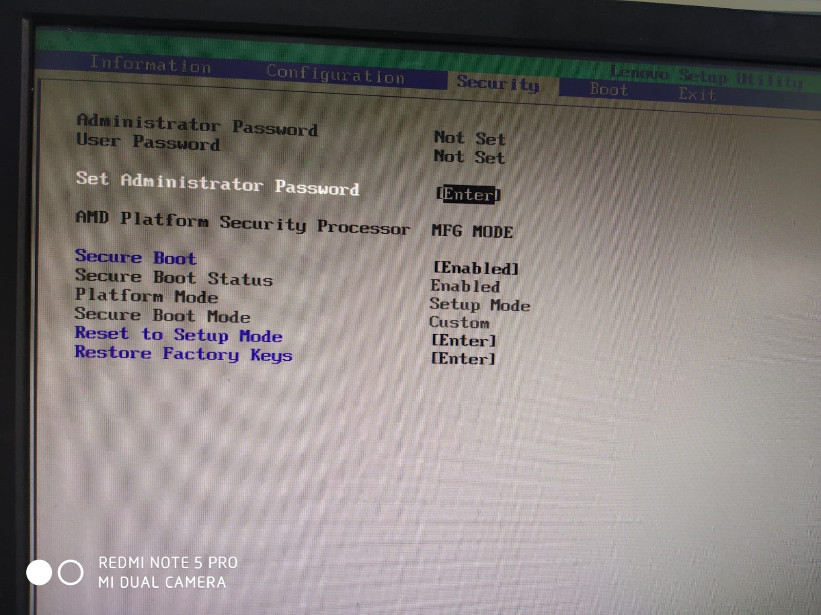

                                  Need Help to enable MFG model in lenovo
