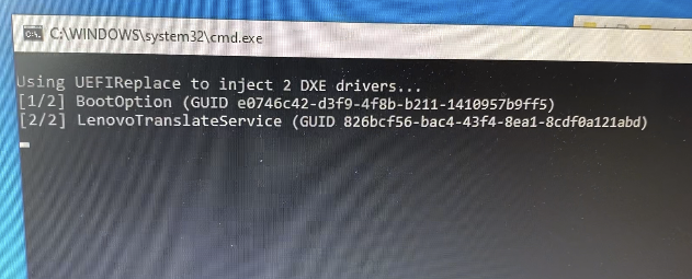

    Thanks. I tried but it shuts down at stage 2/2. Will try adjust size

      Re: LENOVO BIOS AUTO-PATCHER for Supervisor Password Removal
      Same thing-shuts at stage 2/2 when patching
        Just here:
          Originally posted by Serbentas
          Just here:
          Auto Patcher is not support for CPU gen 10th.

            #1585
            Aaa. Is there any solution for CPU 10th or 11th gen ?
              There are a few exceptions. Anyway,maybe this model isn`t supported,maybe somebody else knows.It could be the EC needs programming,then use the mantenance disk to add the DMI
