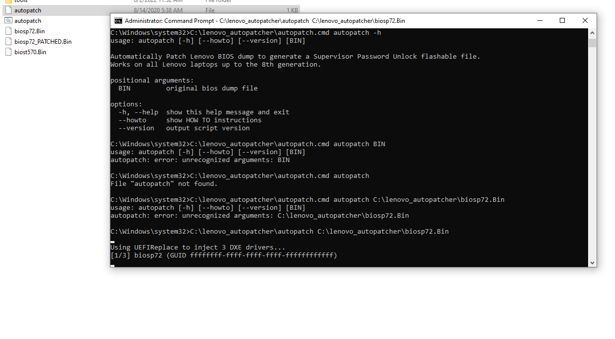

    thinkpad P72 and T570 need help to unlock supervisor password, because i cant get this patcher to work, can someone help me ,thanks !!!

      #1562
      Re: LENOVO BIOS AUTO-PATCHER for Supervisor Password Removal
      ok its working. I will request later !!!
      edit : is it stuck ? i waited more than 15minutes...but it is showing 1/3
