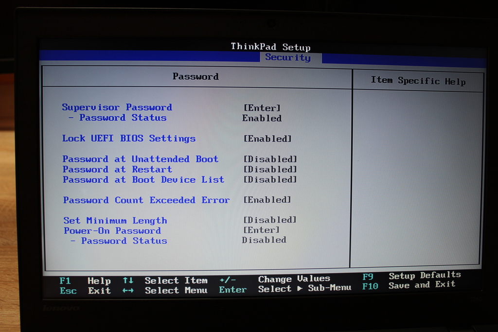

      Originally posted by ednar88
      thanks .. after returning the native bios opiate ask for a password....?
      Your picture is wonderful.
      Please read Post #1 for instructions then it will work too.
      Switch off the notebook and write back the original BIOS backup.
      This patch only removes the SVP password, it does not remove an HDD password.
      I have no idea what password you have now. 😁
