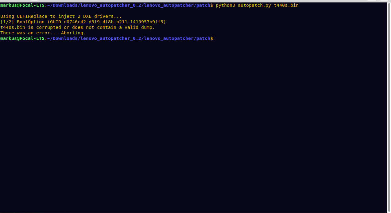

                          Re: LENOVO BIOS AUTO-PATCHER for Supervisor Password Removal
                          help unblock could not patch

                                    #457
                                    Hello, you know your original patch is corrupted?
