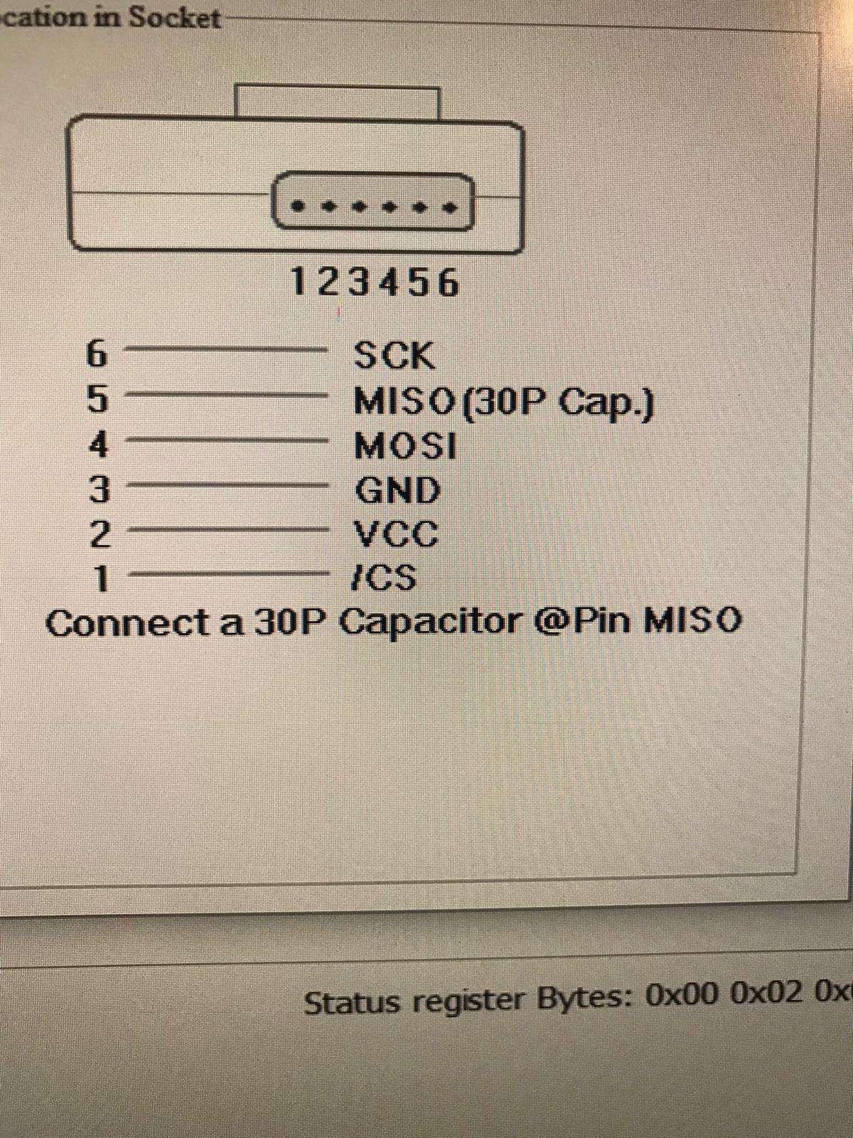

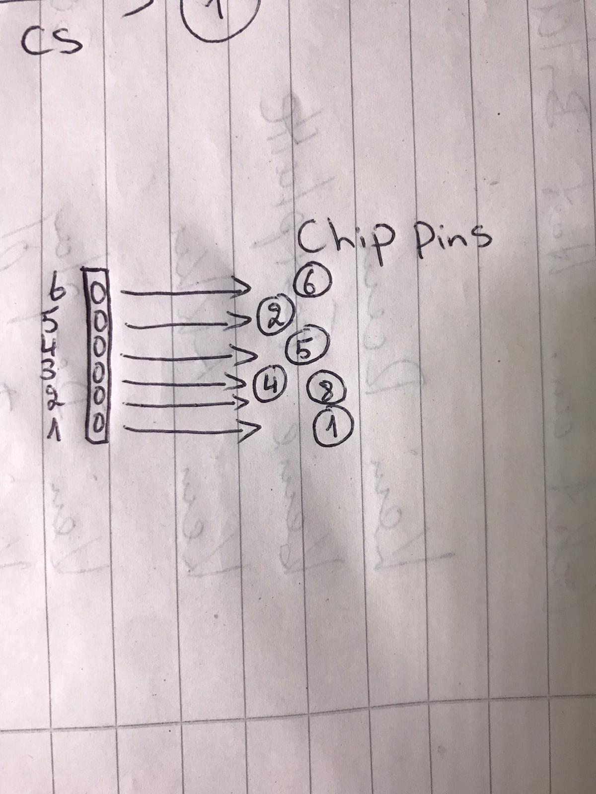

    Have you got the pinout for the clip please? as it's 8 pins and only got 6 wires?

      Re: LENOVO BIOS AUTO-PATCHER for Supervisor Password Removal
      here is the pinout for the clip. you need only 6 wires
        here is it again
          Originally posted by LenBios
          here is it again
          Absolutely brilliant! Thank you very much! Cheers!
