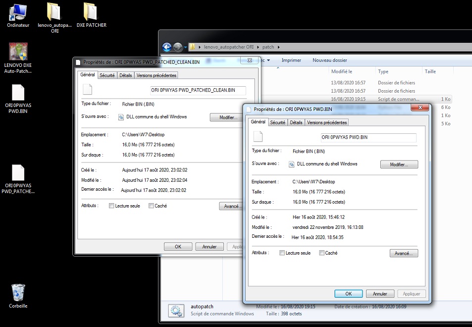

                        yes ok it's good, problem with python. I modified like that to select the file.
                        for windows test on w10

                          i tried this autopatcher with t460 password bios.
                          it output 32mb files with injected dxe driver & nvram data.
                          while original dump is 16mb.
                          one more thing autopacher not worked with python 2.7 in win7 spi x86
                          so i installed latest 3.8.5 now working ok.
                          thanks you guys for faboulous work for this utility

                                    Yes I have the same problem, output as 32mb when original is 16mb. see attached.

                                      There is an extra padding which causes the file size to double. I replace the body with an empty file but to no avail.

                                          However, I tried to use HxD to delete the whole chain of data (which should be that extra padding), trying to see if it works.
