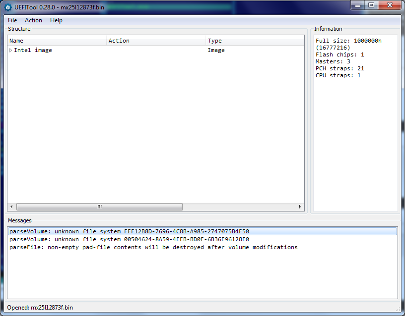

      Re: LENOVO BIOS AUTO-PATCHER for Supervisor Password Removal
      It seems my BIOS dump is corrupted (see a screenshot). Correct?
      But after reflash machine by original (corrupted?) BIOS I get machine with normally booting Win10.

        • Knucklegrumble
          • Jun 2020
          • 78
          • US
          #84
          I can't tell by the screenshot if it's corrupted.
          What model is it? Can you post your original bios dump?
          • alexxis
            • May 2020
            • 8
            • Russia
            #85
            Lenovo x1 Carbon 2nd Gen.
            • Maxpower3
              Bad Veteran
              • Feb 2018
              • 1262
              • France
              #86
              there is a 24rf08 on it no?
              the patch does not work on it
              edit:X1 Carbon gen1 (génération 2 et 3 utilisent MEC1633L )
              • alexxis
                • May 2020
                • 8
                • Russia
                #87
                No, there isn't. My machine has mx25l12873f scheme: https://www.macronix.com/en-us/produ...?p=MX25L12873F

                        • alexxis
                          • May 2020
                          • 8
                          • Russia
                          #92
                          Thank you very much for help to my dear friends Knucklegrumble and Maxpower3!
                          It seems all works properly now. But I did not find anti-tamper switch at my machine.

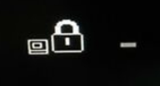

                                • Dr.Brown
                                  • Aug 2020
                                  • 3
                                  #96
                                  Are you sure you have supervisor password enabled?
                                  See the attached picture. I think this is the Supervisor password!?
                                  • Knucklegrumble
                                    • Jun 2020
                                    • 78
                                    • US
                                    #97
                                    Hard to tell some times with lenovo's... They have the same icons for boot and supervisor password... Can you boot into your os with original bios? Can you enter bios settings? If you can send a picture of the security section in bios

                                      • Dr.Brown
                                        • Aug 2020
                                        • 3
                                        #99
                                        Your're right, it was not the supervisor password.
                                        Sorry for wasting your time. Thank you very much :-)
