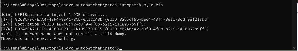

                                • Bios_fix
                                  • Dec 2020
                                  • 4
                                  #316
                                  Re: LENOVO BIOS AUTO-PATCHER for Supervisor Password Removal
                                  I got this error every time can any one help me ?
                                  • Ghamidi
                                    • Mar 2020
                                    • 303
                                    • France
                                    #317
                                    upload your bios dump and model
                                      plz patch this file
                                      • Bios_fix
                                        • Dec 2020
                                        • 4
                                        #319
                                        Thank you for your help
