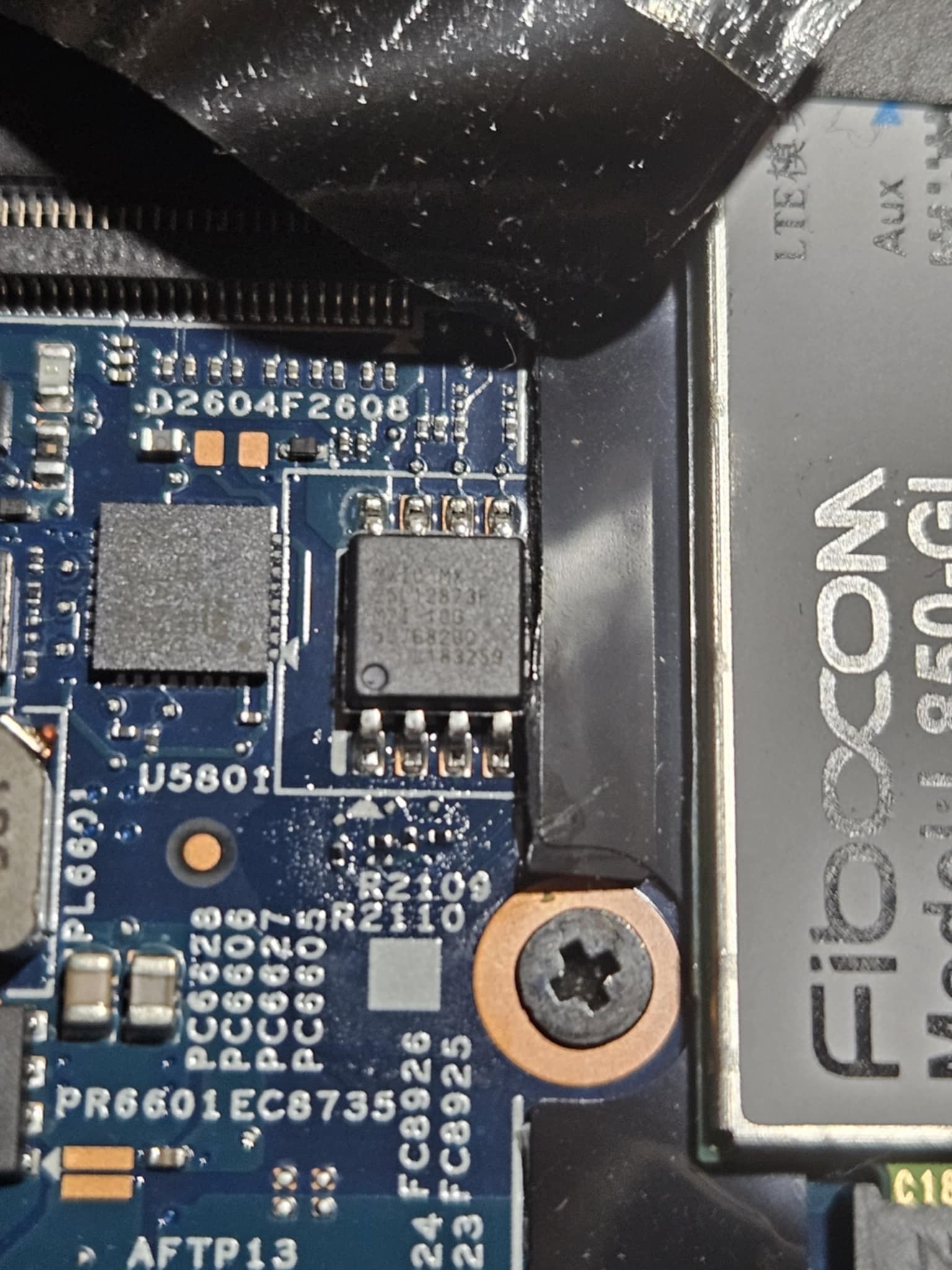

            • ofluffy
              • Aug 2025
              • 11
              • US
              #4006
              Originally posted by Stefan Steff
              I think RT809H is the best price/value in this category...in fact every programmer has good and bad things but to use it once or twice a year then RT809H is a good choice.
              In US you find a lot of RT809H programmers on Amazon or eBay. (ex. https://a.co/d/eUE6vcB)
              Look for RT809H not for RT809F !
              I can't find the chip I'm supposed to flash, not sure what I'm looking for. Could you send photos or any more details? Also, do I have to desolder an entire BGA chip to do this?

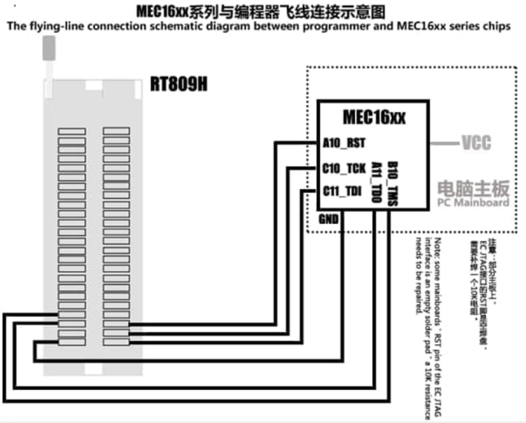

              • Stefan Steff
                • Mar 2024
                • 387
                • Romania
                #4007
                OK, You asked for
                Here are the details:
                The chip you are looking for is U23 (MEC1653) and you don't need to desolder the chip !
                Look on the first picture and find all soldering points for JTAG on your MB.
                The second picture is how to connect these points to your programmer. ( don't wire #RST )
                After connecting and checking all wires start your programmer software and select MEC1653 from EC List, connect the charger and read the chip it should be 290kb.
                Save the reading to a file and check with an hexeditor ... it must be all sort of random data not all FFs or E3s or whatever single byte type...
                Erase the chip and write the file back.
                Swap back the R8796 to R8797 position before restart !
                You will lose your laptop's data such as serial number, model, etc. like:
                2200: Machine Type Invalid and Serial Number are invalid.
                2201: Machine UUID is Invalid
                2202: Product Name is invalid
                2203: System configuration is invalid.
                2204: System configuration data is invalid.
                Don't worry that can be restored from the sticker (I hope is intact...if not then ..."Houston, We have a problem").
                Use ThinkPad Config Information Update Utility v1.11 (attached) and an empty USB stick :
                -Extract and run "usbfmtpw.exe" this will format your USB and copy the files over.
                (check that the files copied after format. if not manually copy them to the root of the USB).
                -Insert to laptop and boot to USB FDD it is EFI not Legacy (USB you just created).
                -Now go to main menu and choose initialize EEPROM, this clears all keys plus UUID and now the overflow error wont happen.
                -Now go 1, then use 1 to add new info, enter C0 then Enter.
                -Now enter serial and model in long form will start with 1S so (1STTTTMMMMCCSSSSSSS like described below)
                -Enter and Key is stored.
                -If you like can add more or go back and use option 3 for a few more config details. (I set my brand name there)
                -Once all info is set go to assign UUID, and say Yes.
                (once you generate the UUID you cannot edit the serials unless you initialize and do them all over again.
                -Reboot and check bios screen your info should be there no more beeps on boot.
                Product ID: TTTT-MMMMCC
                Serial#: SS-SSSSS
                TTTT = Machine Type
                MMMM = Model Type
                CC = Country Code
                SSSSSSS = Serial Number
                ...so yours will be 1S20HGS14D00PC0PTLL4
                As a final advice before you try to flash your MEC1653:
                Check and re-check every component around the BIOS chip and try to rewrite your saved dump with the new programmer because is far,far better then the CH341A.
                Good Luck!

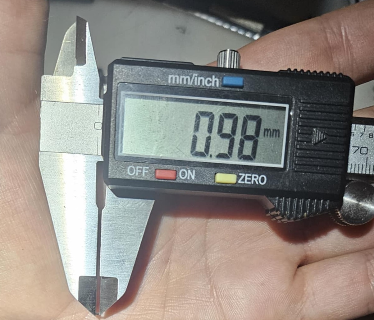

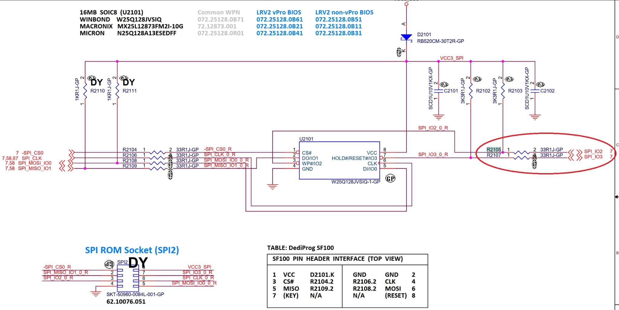

                • spink90
                  • Sep 2025
                  • 8
                  • Poland
                  #4008
                  This may not be super relevant, but it happened while unlocking BIOS using clip.
                  Resistors next to the BIOS (33 ohms).
                  I'm attaching a snippet of the schematic with the resistor code.
                  It might be useful to someone.
                  These are SMD resistors 0201 or 0402 33R1J(33Ohm 5%).
                  0201 - ~0.6mm long.
                  0402 - ~1mm long - they are a bit too big, but they can be soldered.
                  Symptom is that the laptop is unresponsive.
                  After applying power (with the BIOS and laptop batteries disconnected), the power button (white LED in the button) blinks three times.

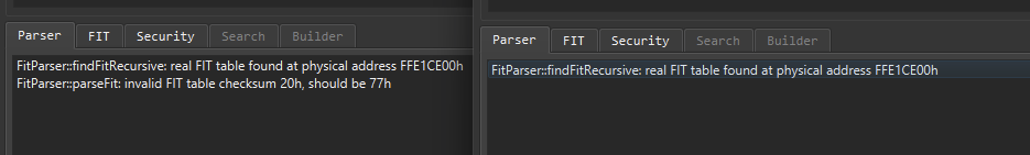

                            • Maxpower3
                              Bad Veteran
                              • Feb 2018
                              • 1356
                              • France
                              #4014
                              Originally posted by hitman473
                              Unfortunately, that doesn't work either. Now I'm getting two sets of five beeps and no display, then the notebook shuts down.
                              try
                              Originally posted by pdblues2231
                              hi, there try this..
                              Click image for larger version  Name:	image.png Views:	0 Size:	15.5 KB ID:	3730540
                              FIT table checksum bad
                              checksum here
