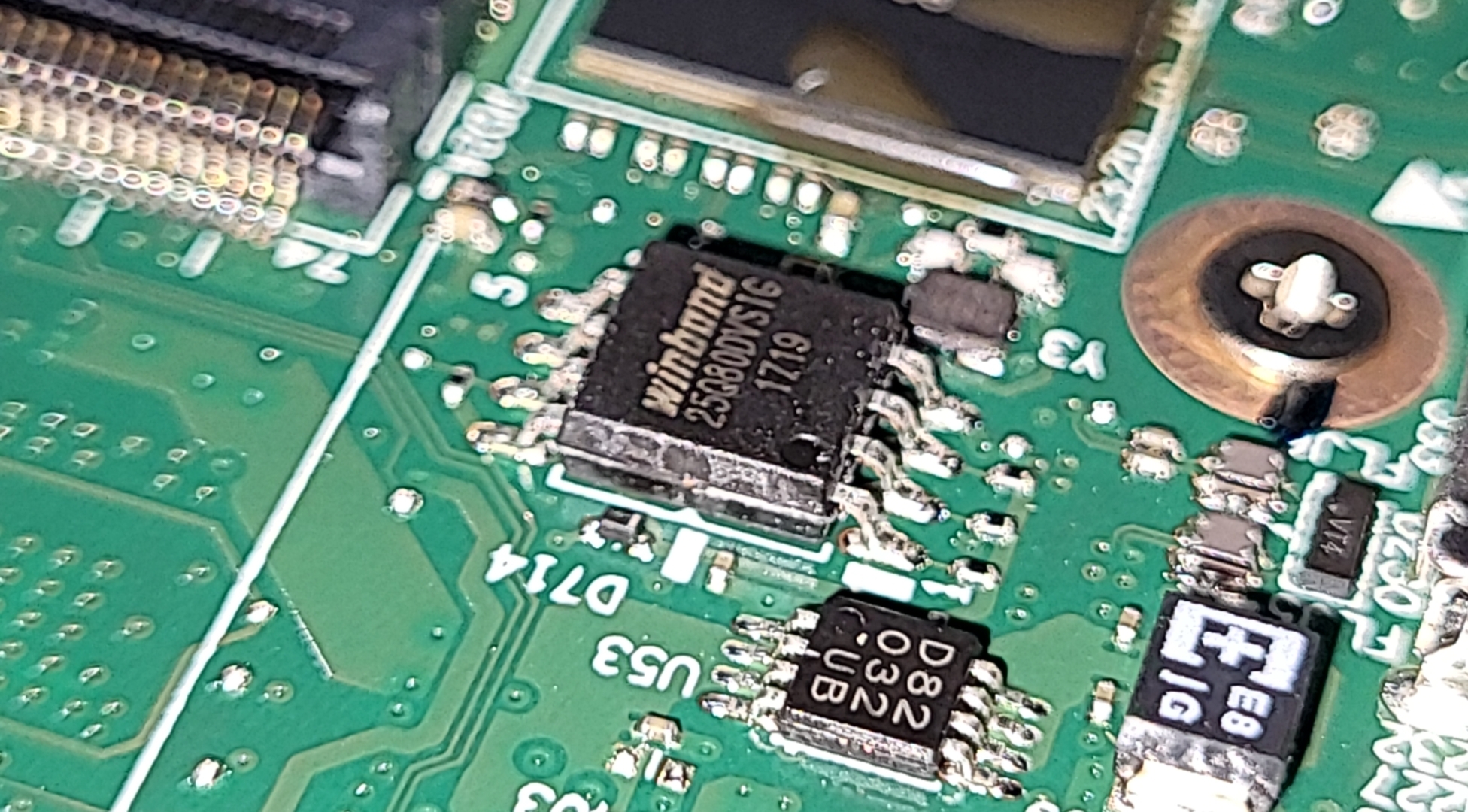

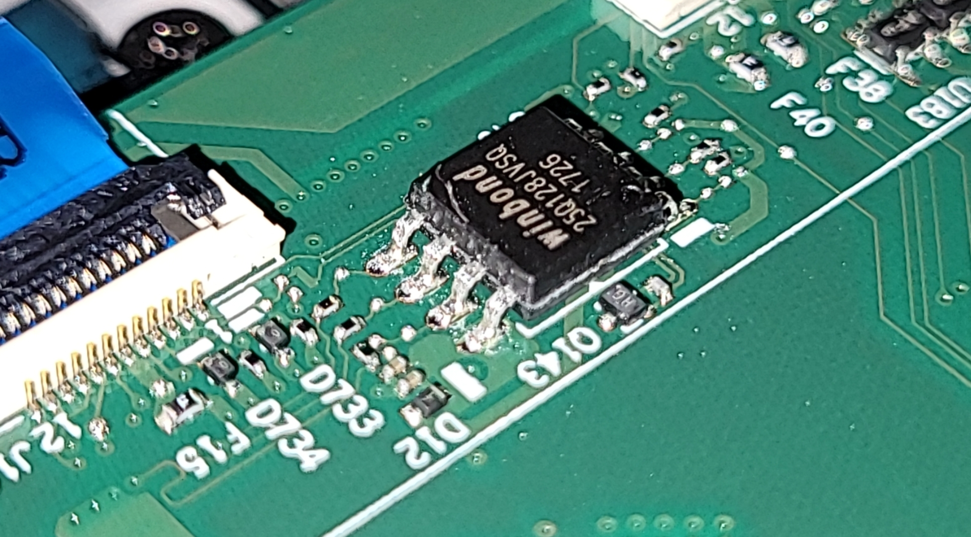

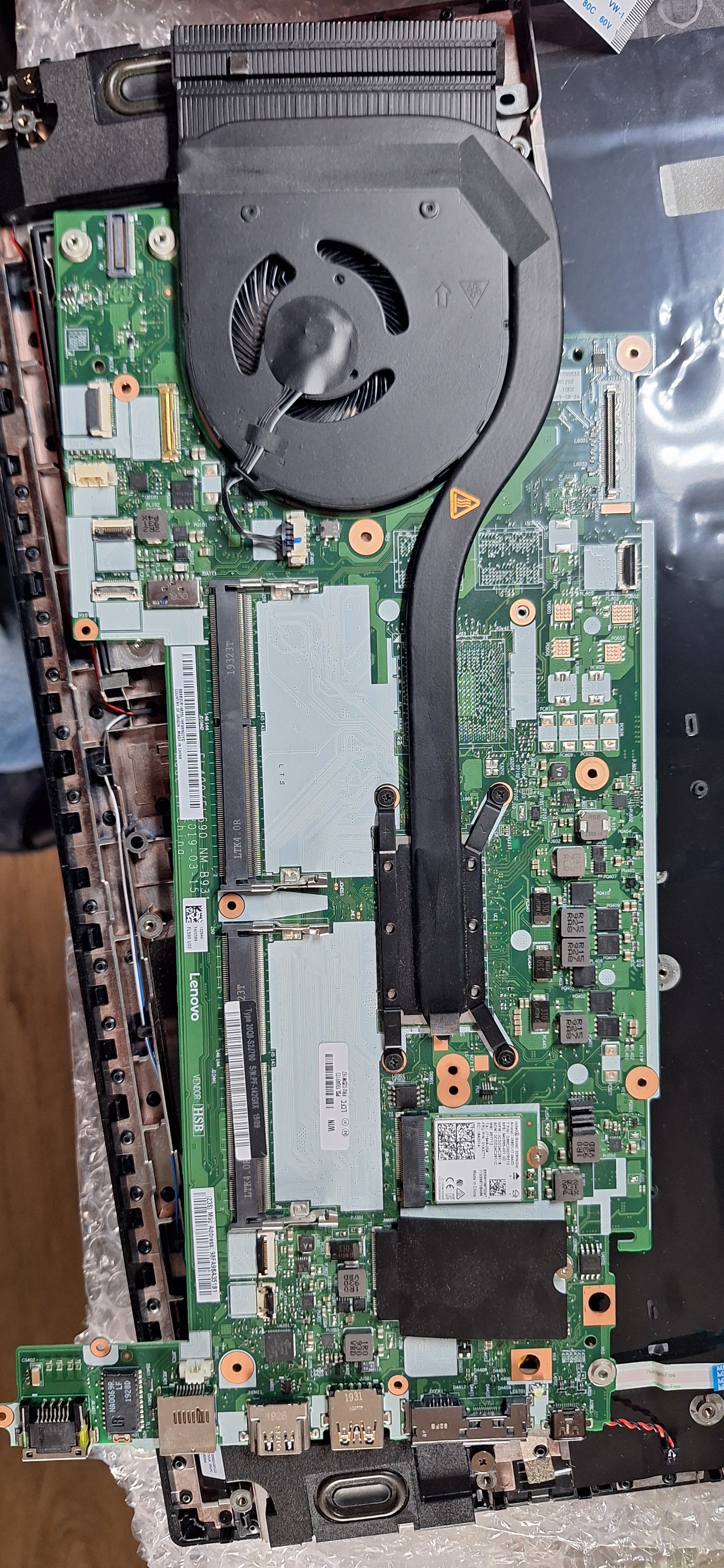

                    #3969
                    This has bricked my T470s, great. Now the power button and keyboard flicker and it won't come on fully at all.
                    • ofluffy
                      • Aug 2025
                      • 9
                      • US
                      #3970
                      Flashing both chips back to their original states doesn't even fix it, it no longer boots at all after trying the PXE driver injector method...
                      • Stefan Steff
                        • Mar 2024
                        • 357
                        • Romania
                        #3971
                        Please provide a serial number and model number.
                        Let's try to fix your laptop
                        • ofluffy
                          • Aug 2025
                          • 9
                          • US
                          #3972
                          It's a 2017 T470s
                          I think the original serial number stickers were replaced, all I can find is:
                          Type 20HG-S14D00 and S/N PC-OPTLL4 17/09
                          • Stefan Steff
                            • Mar 2024
                            • 357
                            • Romania
                            #3973
                            It's a 2017 T470s
                            OK, that's good. (PC0PTLL4 with "zero" after letter C.
                            The 25Q80 chip is your PD controller SPI so must be untouched and write it back as is.
                            Write the content from the attachment and tell me if it works or not.
                            It's tested by me on several T470s laptops.
                            • ofluffy
                              • Aug 2025
                              • 9
                              • US
                              #3974
                              I flashed it just now, it still does the same thing. The keyboard and power button light up briefly then it shuts off. This happens once when power is plugged in, then it is unresponsive until unplugged and plugged back in once more.

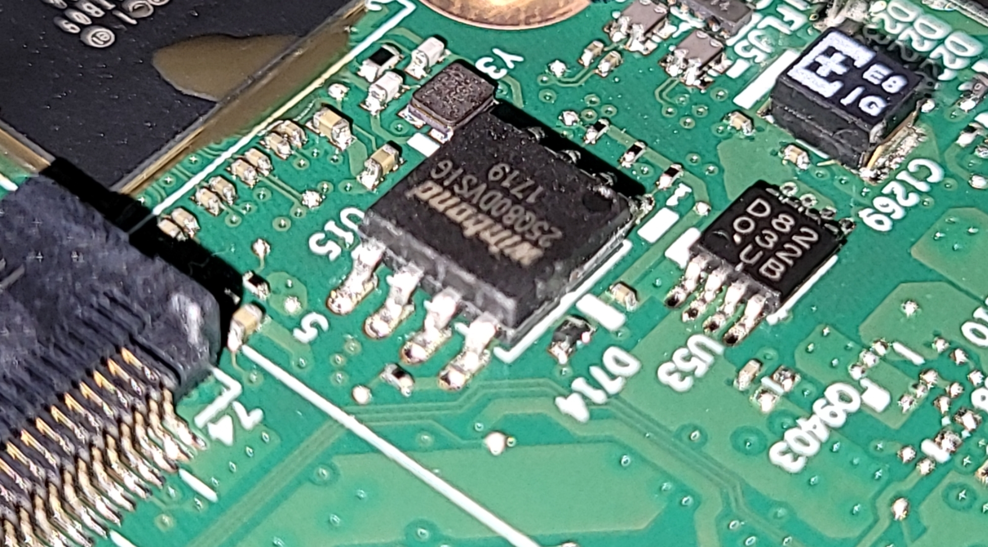

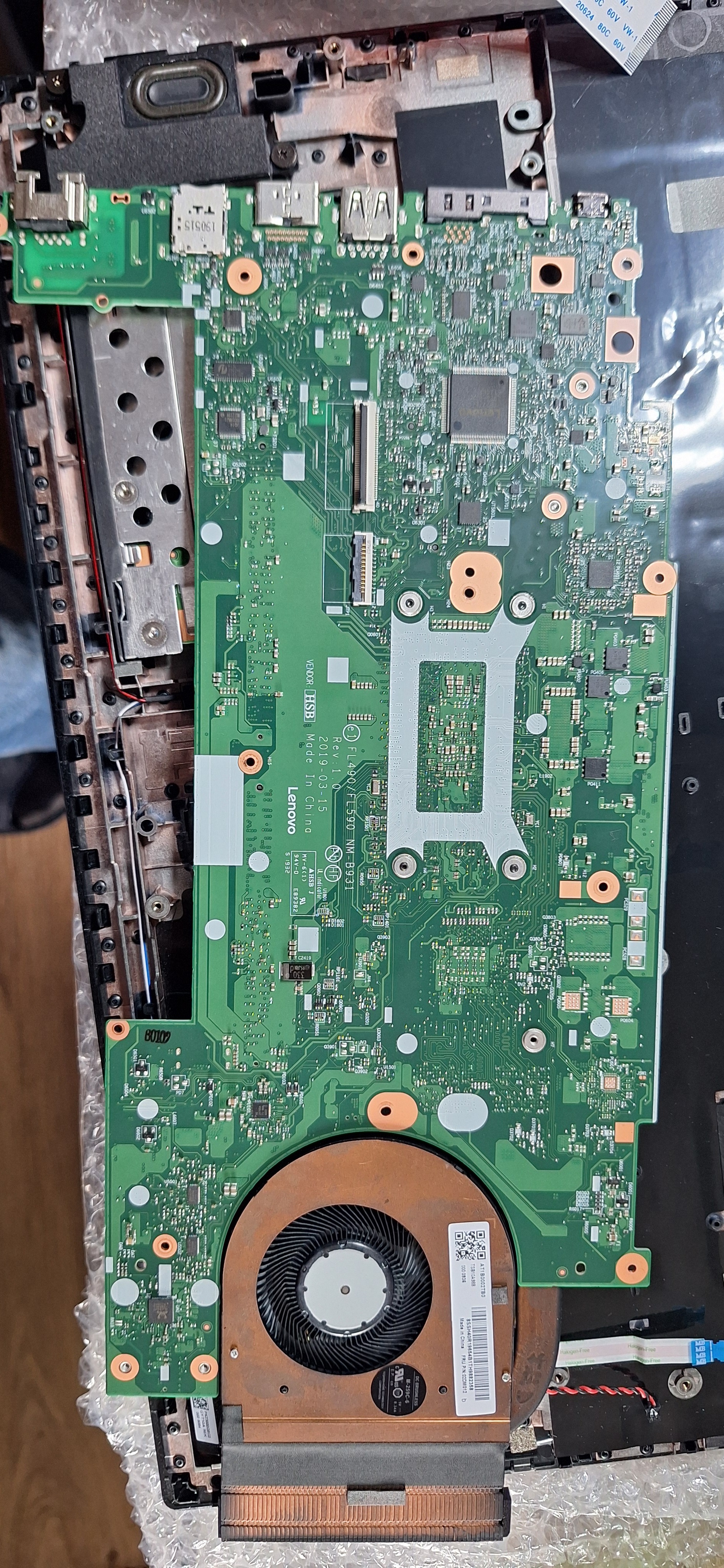

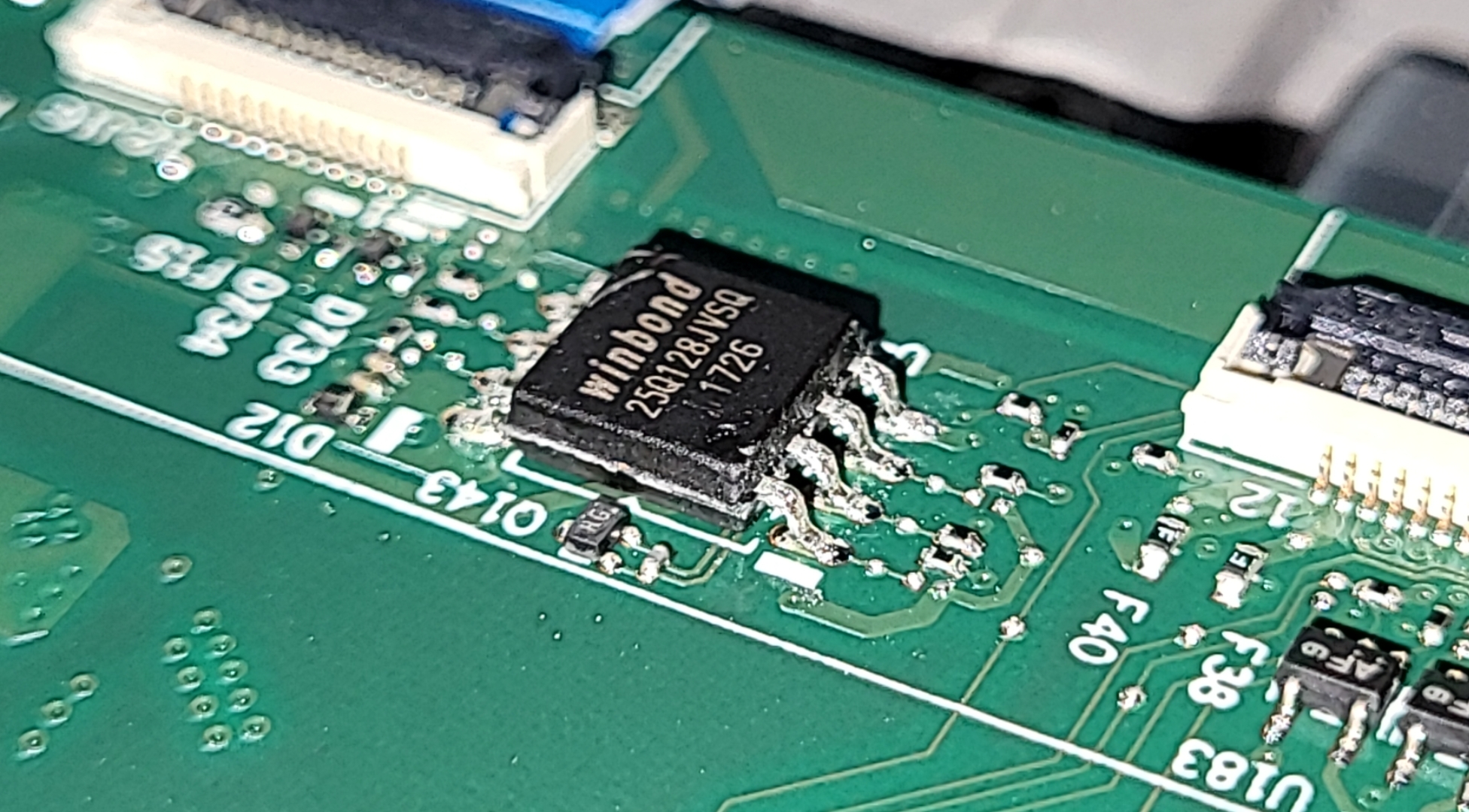

                              • Stefan Steff
                                • Mar 2024
                                • 357
                                • Romania
                                #3975
                                OK.
                                I see some differences between your PD Controller backup and what I have saved on my PC.
                                So here is mine to try.
                                • ofluffy
                                  • Aug 2025
                                  • 9
                                  • US
                                  #3976
                                  OK.
                                  Flashed that to the pd chip, same result... Not sure what on earth is going on. This all started after trying to use the auto patcher...
                                  • Stefan Steff
                                    • Mar 2024
                                    • 357
                                    • Romania
                                    #3977
                                    Do you use clips to flash the chips or you desolder them ?
                                    Check for missing or damaged components near the BIOS chip.
                                    If programming different versions of BIOS did not result in different behavior most likely you have a hardware issue...
                                    • ofluffy
                                      • Aug 2025
                                      • 9
                                      • US
                                      #3978
                                      Yes I used SOIC8 clip with CH341a programmer. Didn't happen until I went through the bios unlock process listed on the lenovo autopatcher. It showed the usual PXE driver screen, turned off, I flashed the original like it said to, then it wouldn't turn on. I'll inspect the board.
                                      After looking, I don't see any damaged connections or missing pieces, or any significant activity on thermal camera. However, I did just notice that once powered on, the fan continues to spin and stop, over and over like it's continuously trying and failing to boot. I've attached pictures of the rom chips, maybe I missed something.
                                      • Stefan Steff
                                        • Mar 2024
                                        • 357
                                        • Romania
                                        #3979
                                        It's very tricky to use clips...must be careful and check the reading/writing at least 2 or 3 times to be sure it's done correctly...
                                        As a last try ... here is the EC content.
                                        I hope you can and know how to use JTAG to read/write the MEC1653. (You find plenty of examples here on badcaps how to prepare the MB and use the JTAG to read/write MEC chips...
                                        An example: https://www.badcaps.net/forum/troubl...lock#post74632)
                                        I don't know about the MEC1653 but the MEC1633 has an internal 2Kb EEPROM in witch is the password stored so if this is true for MEC1653 then rewriting the EC content may help to bring your laptop back to life.(without clearing the password...)
                                        Also, I don't use CH341a (I use SVOD4 and before SVOD I used JTAG programming with RT809H) so I don't know if it supports JTAG programming...
                                        In conclusion, what I would do:
                                        1.- Write the 25Q80 with the original backup content
                                        2.- Write the 25Q128 with Thinkpad T470s-Type 20HG.bin
                                        3.- Write the MEC1653 with T470s_MEC1653.bin via JTAG (attached)
                                        If it's starts then patch the Thinkpad T470s-Type 20HG.bin file and follow the instructions.
                                        Write back your saved BIOS backup file or write back the Thinkpad T470s-Type 20HG.bin and make a BIOS update.
                                        Good Luck!
