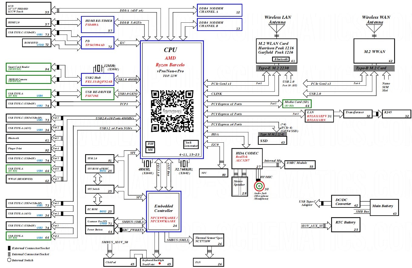

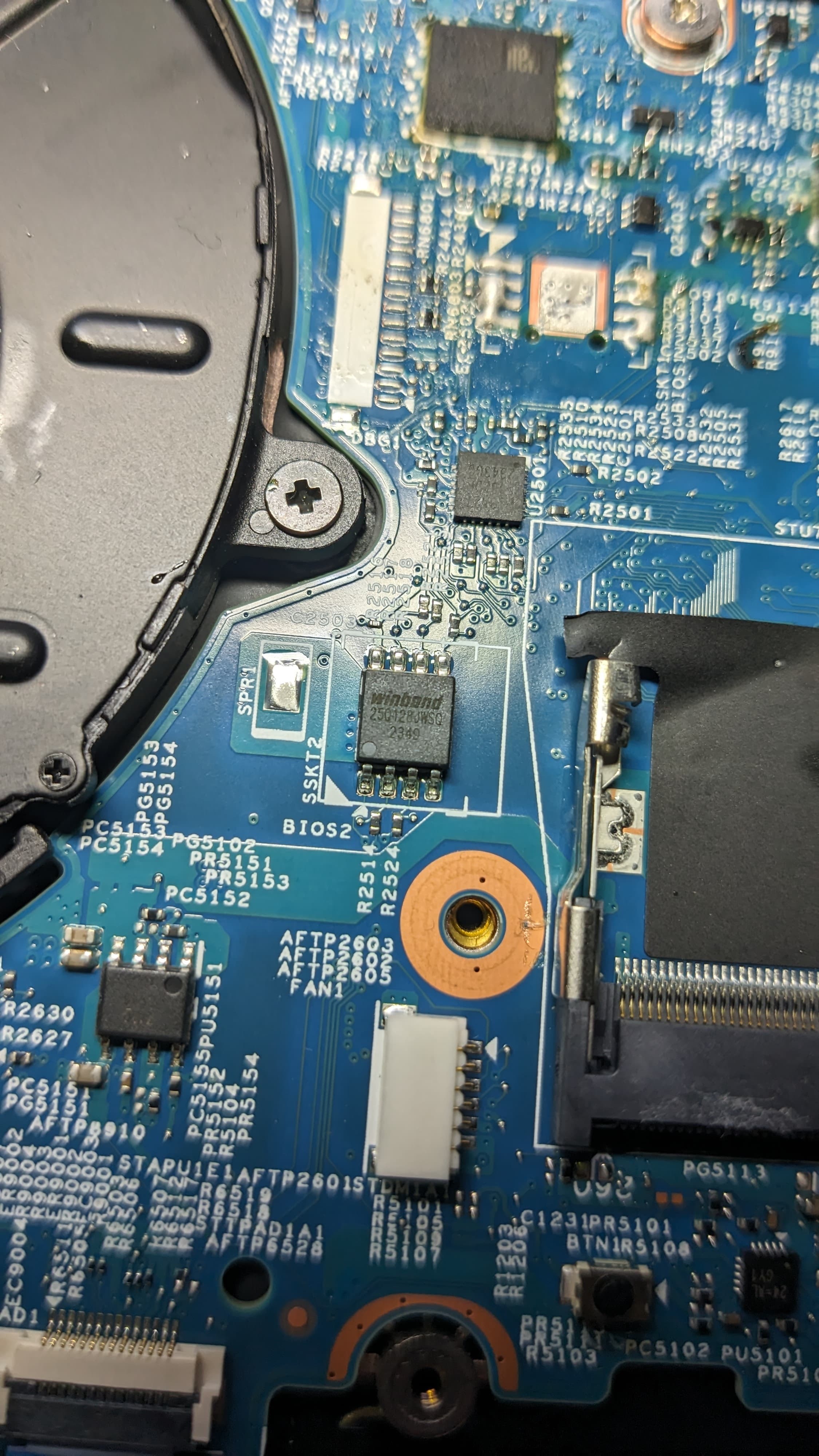

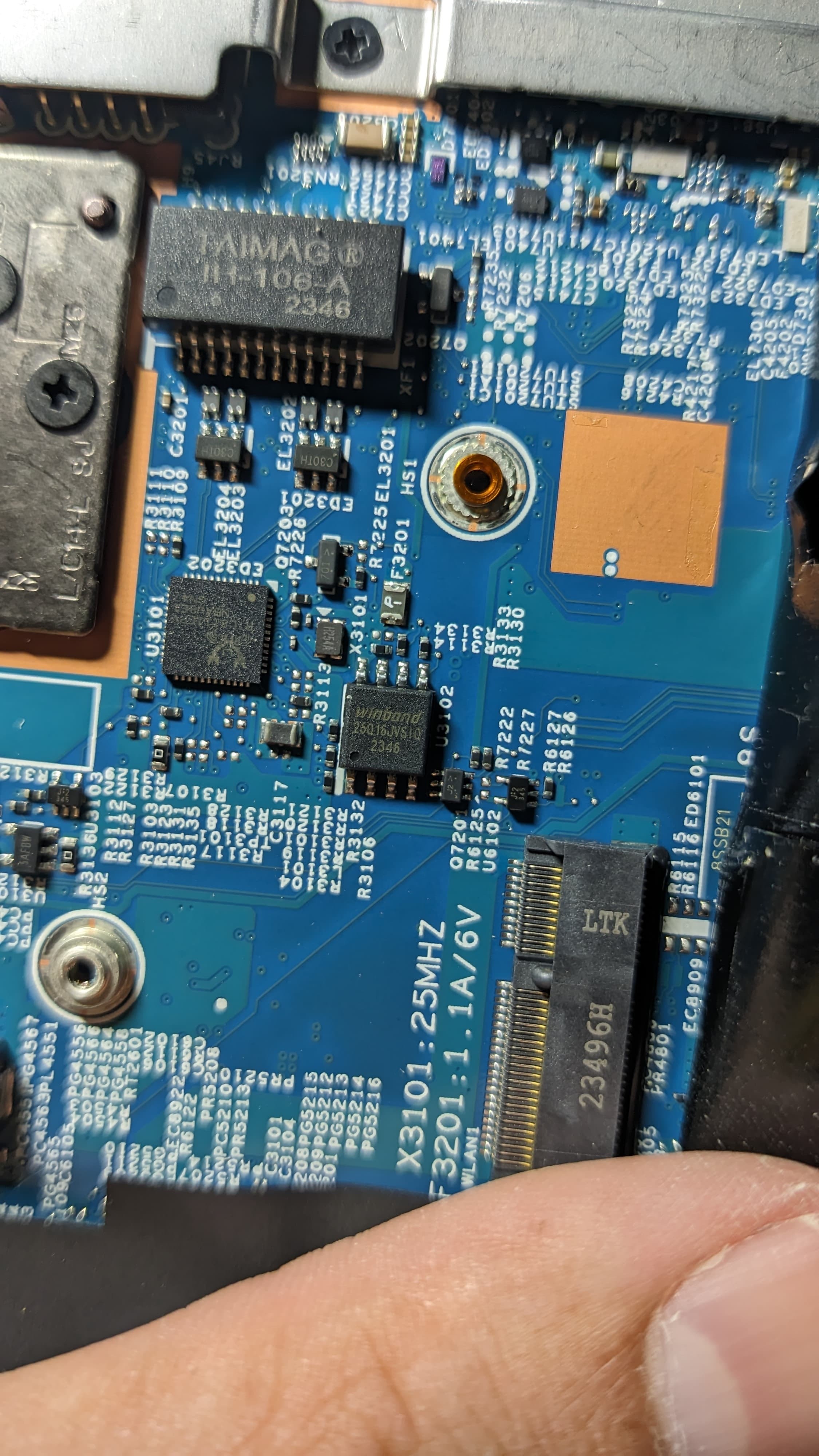

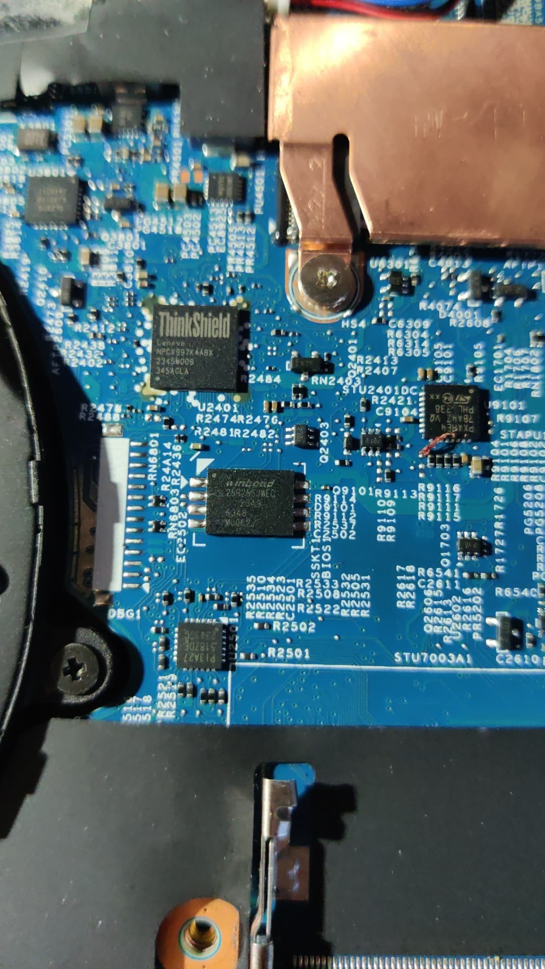

                Hi! Newbie here. I have a Thinkpad L14 gen 4 (21h6). After hours can take a dump from W25Q256JW (1.8). When I try to pass the dump to the auto-patcher, I get the "is currupted or does not contain a valid dump."
                I use a CH341 (black) with the 1.8 adapter. Programmer NeoProgrammer 2.2.0.10, was the only programme that auto detect the IC.
                Any suggestion?
                Model: L14 GEN 4
                Serial: PW-0B7NFN 21H6
                Attached the dump, if its required. Thanks.

                  #3808
                  KnonicaL
                  I tried to patch your Posted dump and it shows me the same errormessage...
                  Did you create more than 1 dump? (i did 4 dumps in series and compare them using sha256sum Checksum of each dump, to get sure there are identical...
                  one dump can fail, a second dump maybe too.. But if you get 3 or more dumps and all have the same checksum it would be a "good dump"...
                  In this case you can choose only one to patch...
                  So try to dump again, more tan one time...
                  Good luck..

                    #3809
                    Any suggestion?
                    Model: L14 GEN 4
                    DoCNC Thanks for reply.
                    I did many dumps, all same checksum, same values no one worked. The programmer and the CH341B do not have any problem at auto detect the IC, soo I assume are correctly.
                    I will update a little bit more I have the board lg4 lt5 2 amd 8l gen4 pcb svt2 and have a W25Q128FW (1.8) marked as BIOS2. Tried to dump too but didn't work with the patcher too. it's the W25Q128FW the EC?
                    I don't what to do.​

                      #3810
                      KnonicaL at first make sure you dump the correct chip... - I dont know your board.. Maybe get the Schematics for your board and compare the chip you dumped...
                      In my case (T480) it is U49.. Make sure you clamp in the right direction...
                      If anything failed you have to detach the Chip from the board.. Some boards can interrupt your dump..
                            Any suggestion?
                            Patcher doesn't work, BIOS 32MB, only 16MB.
                            And Gen4 certainly requires EC reading.​

                                        #3819
                                        Thanks for reply.
                                        So How can I identify the EC? Have this chips W25Q16JVSIQ, W25Q128JW, 25R256JW.
                                        I'm using the CH341B and I think it's not working properly with this chips.
                                        I will make a update. I find the EC its NPCX997KAABX. So, I do not how process now. Had any way to clean the supervisor pass?
