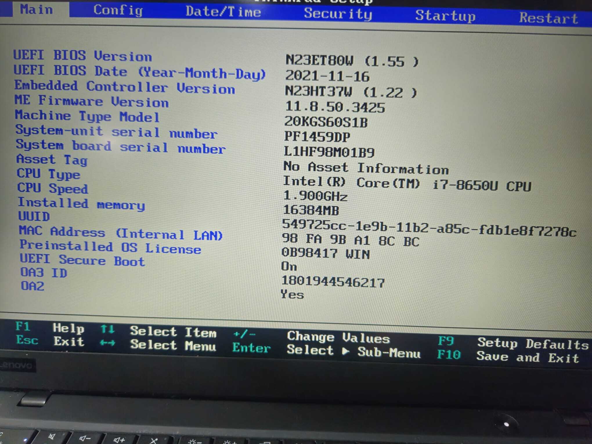

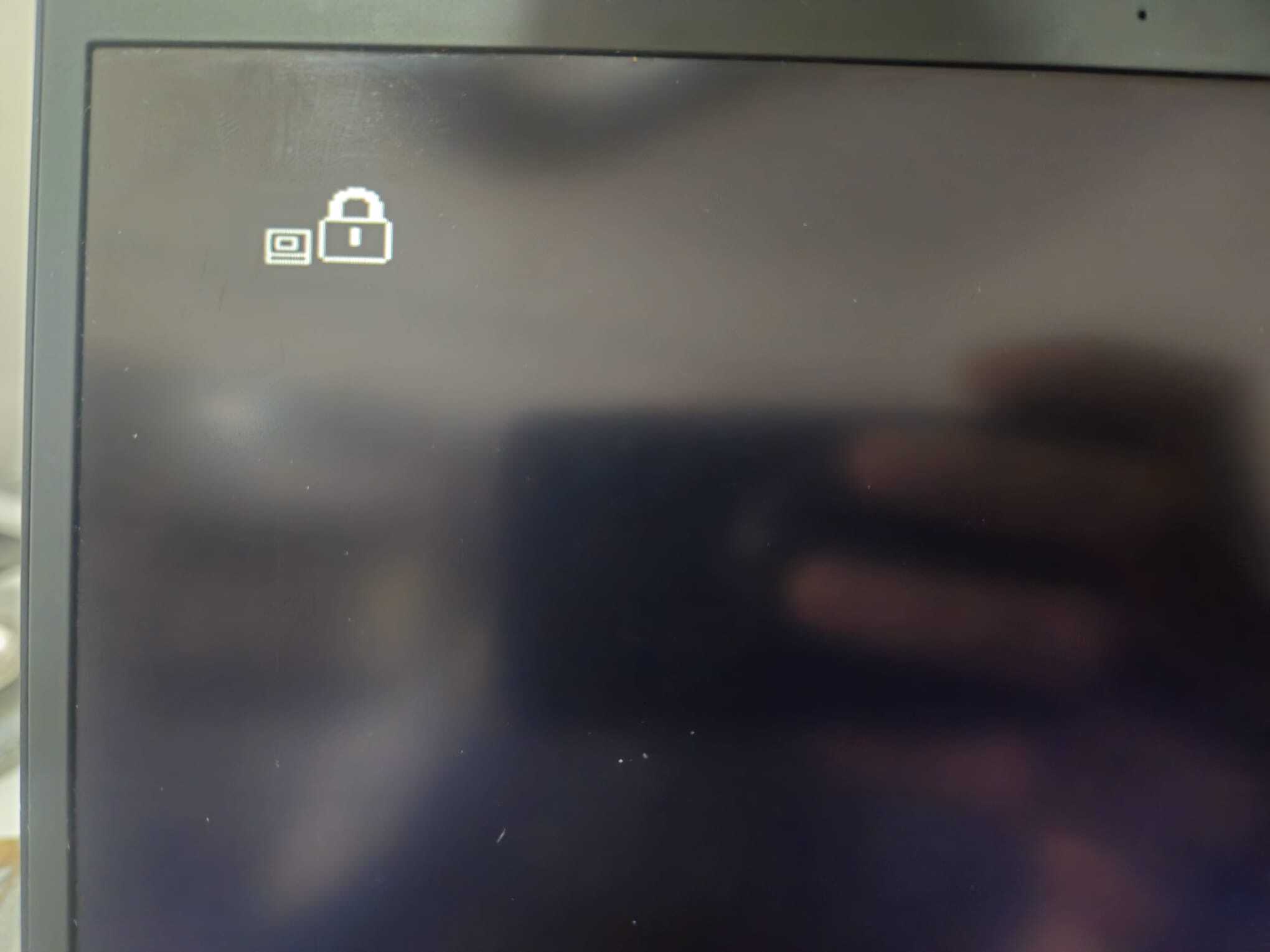

            Hi, can you remove the password of my ThinkPad device? Since I was not sure what information was required, I also added the bios image. Thanks in advance.
            Model: 6th Gen ThinkPad X1 Carbon 20KGS3W813
            Serial: PF18BC5H

              I had to double post because I couldn't edit my previous post, I'm sorry. Even though it was late, I was able to notice the patch file. After following the commands exactly, the password was removed. Thank you.
