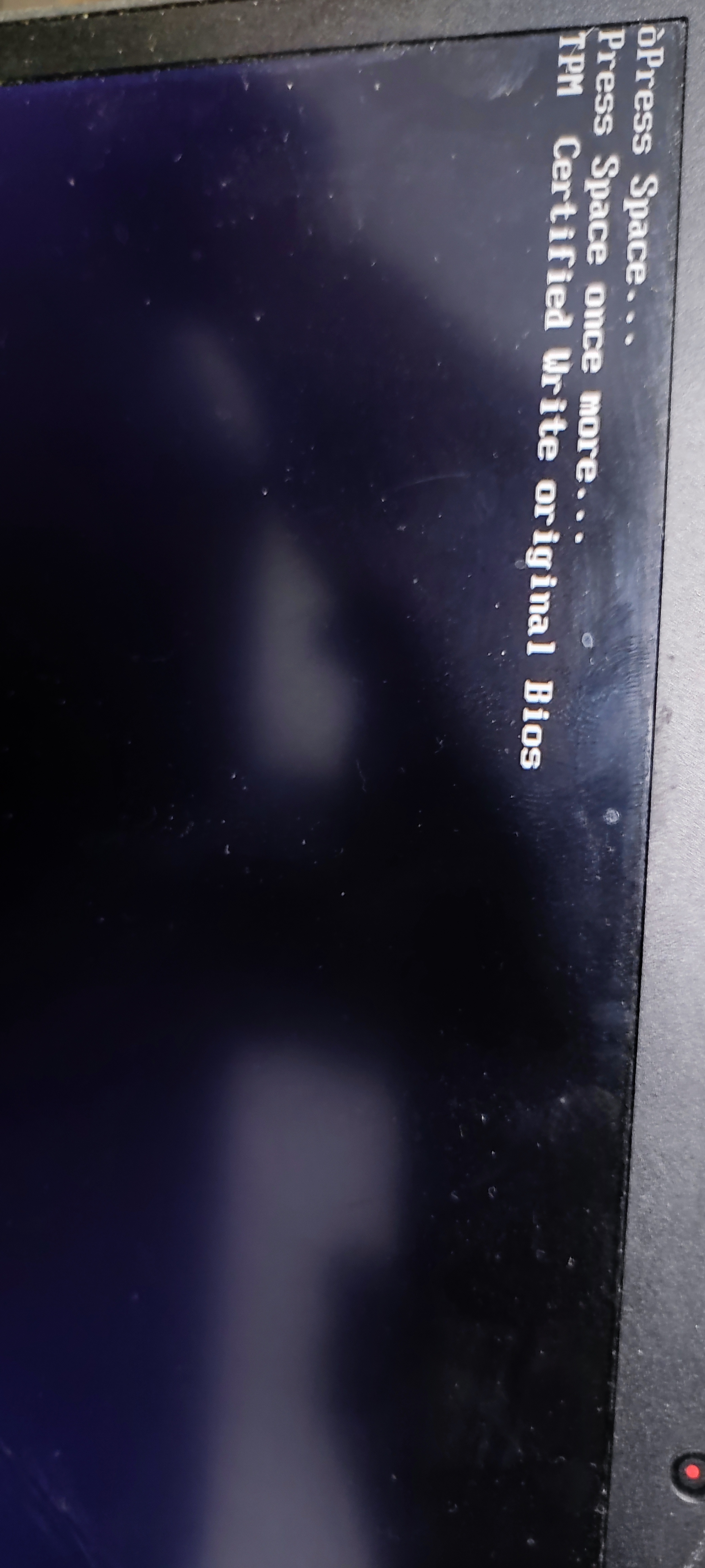

    Hi Everybody! Until now I have been able to unlock a couple of Thinkpads thanks to this system which I think is quite easy and straight-forward.
    Anyway now I came across a P50, and it seems that autopatcher is NOT working: if I patch the BIOS, laptop boots up for 5/6 seconds but then it shuts OFF. NO video screen, NO beep codes.
    What I did: dumped the file using a clamp (dumped twice, checked using certutil and generated same hash file so I moved on); patched with autopatched, loaded new BIOS. tried 3 times, same results...
    Can it be because of the MACRONIX chip? That is the 1st one I am finding (previous ones were Winbond). Attacched original DUMP.
    Type: 20EQS28U03
    S/N: PC0K6ER2 17/03
    Bios MACRONIX MX25L12873F
    Bord # BP500 NM-A451 Rev 1.0 2015-11-06​

      #3082
      S.N:- PC0K6ER2
      STEP 1: Flash given patch file
      STEP 2: Boot the machine
      STEP 3: Enter in BIOS settings
      STEP 4: Enter any character when asked for Supervisor Password
      STEP 5: Press enter when it shows Hardware ID
      STEP 6: Press space bar 2x when asked
      STEP 7: Turn off machine
      STEP 8: Restore original BIOS (write your old backup bios)
      STEP 9: Reset BIOS settings to factory default

        NOPE... Unfortunately same behaviour as before: laptop does boot automatically once connected to AC, stays on for 4/5 seconds (fans 1/2 seconds), then turns OFF automatically. DOES NOT reboot. If I try to power-it on manually (power button) it starts, again for 5/6 seconds, then OFF. NO video, NO beeps. On the laptop I have video, ram (1 slot), keyboard, nothing else (NO CMOS, no battery, no ssd).
        If I switch back to original BIOS (not patched) everything works normally (but with password). :-(

                                      I did the whole process but the password is still on the bios
                                      STEP 1: Flash and replace current BIOS with the generated patch file
                                      STEP 3: Press ENTER/F1/etc. to enter BIOS settings
                                      Can someone advice please ?
                                      step8. Do I need to erase chip and flash with original bios , right ?​
