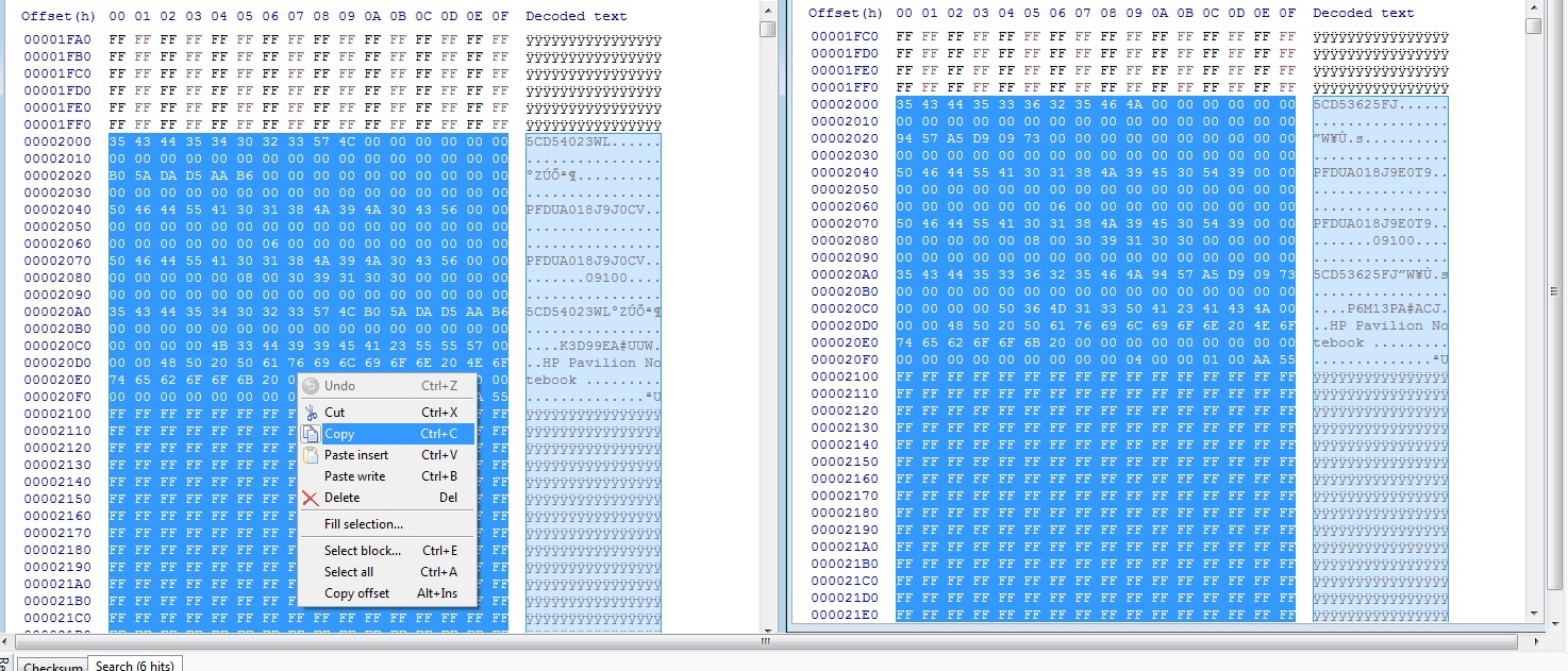

    Hey guys!
    I think my BIOS is corrupted. I tried installing a BIOS that I found on Badcaps for this motherboard but it didn't boot. I think I need for my specific model.
    Specs
    HP 15-ab112no
    DA0X21MB6D0 Rev D.
    Serial: 5CD54023WL
    I'll also post what I think might be my corrupted BIOS.

          I managed to install a BIOS from this thread that's meant for another laptop and it worked!
          Now I need to transfer the DMI. Any tips?
            • 22286

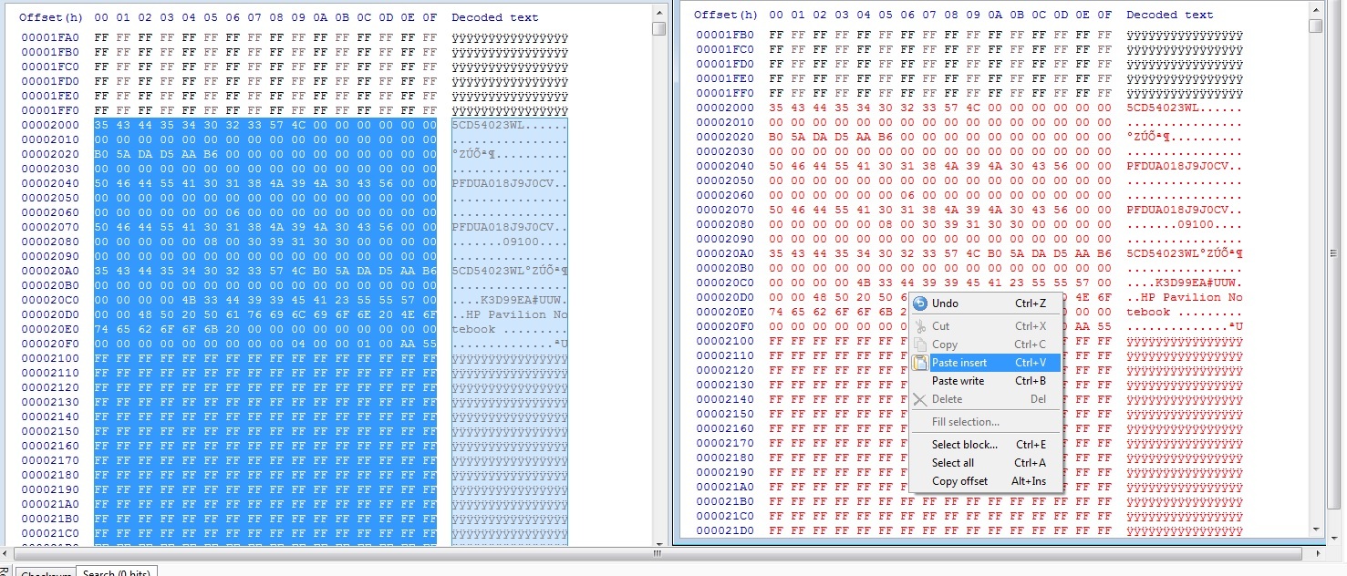

            Offsets 2000 - 503F
            HxD Hex editor - https://mh-nexus.de/en/hxd/

              Brilliant. It worked excellent. I'm gonna make sure to donate 5 dollars right now
