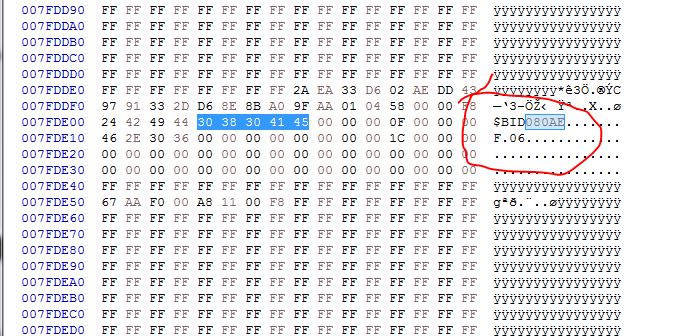

                            • 22279
                            Re: da0x21mb6d0 rev d bios
                            Originally posted by anis81
                            this my old bios hp 15-ab032ax da0x21mb6d0 rev: D
                            bid080ae
                            dmi 1000 - 503f
                                HP 15-ab031ax mobo code isA0X21MB6D0 REV orignal file is attached ........notebook turns on with no post ...its using AMD cpu and AMD graphic
                                  • 22279
                                  Your BID is the same as the bios at post #14 .Use that bios,copy your DMI over from your backup to the new one with a hex editor, the offsets are at post #14,and in the picture.Copy from your backup and paste-insert using the same offsets in the new bios
                                  HxD hex editor https://mh-nexus.de/en/hxd/
