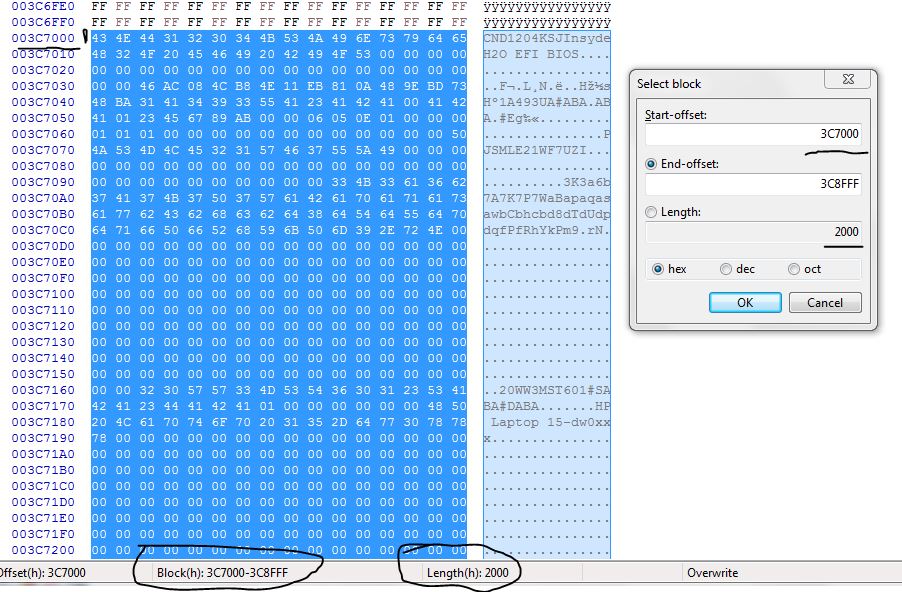

                085F5 is working but it is possible to incorporate the data (DMI) of my dump on that file? thanks.
                  • 21047
                  Re: HP Fpw50 la-h321p rev 1.0
                  Can you use a hex editor to copy the DMI yourself ?
                  DMI 3C7000 - 3C8FFF
                  WIN 3C5000 - 3C503F
                  • salawayon
                    • Nov 2012
                    • 573
                    • philippines
                    DMI 3C7000 - 3C8FFF
                    WIN 3C5000 - 3C503F
                    thank you very much for the help.. it's now ok...
                      • 21047
                      You`re welcome. All the hp`s that have an insyde bios will usually have the DMI in one big block,and if there is a windows key present it can be seperate. The off-sets can be in different areas though.Search for the word notebook or the laptop model number to find the DMI (text search) ,and for the win key search for hex 01 00 00 00 00 00 00 00 01 00 00 00 00 00 00 00 1D 00 00 00
