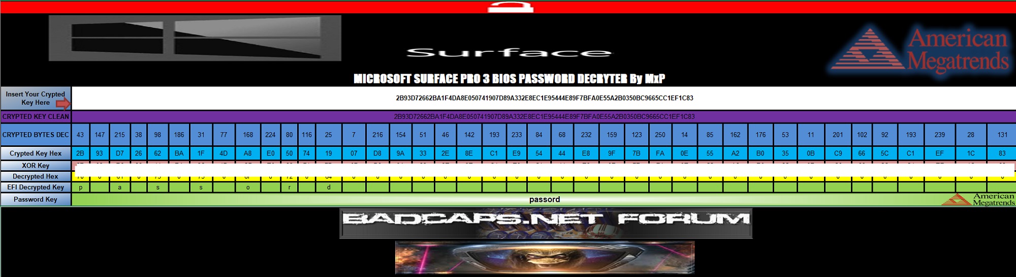

                              Re: Surface 3 Clean Bios? (noob)
                              Just bumping if anyone has a few minutes that can decrypt my bin or help me decode the dump. I think Ive found the data for password under AMITSESetup, but I'm unable to get to the next step. I think XOR key is: 0x935b, but that might be wrong. Any guidance on how to get from where I am to password would be greatly appreciated! Cheers!
                              2B93D72662BA1F4D
                              A8E050741907D89A332E8EC1E95444E8
                              9F7BFA0E55A2B0350BC9665CC1EF1C83
                              • AAAC
                                • Jan 2020
                                • 459
                                • Mexico
                                #35
                                @itZaZkrit
                                try: passord
                                • itZaZkrit
                                  • Jul 2020
                                  • 3
                                  • no countries on mars
                                  #36
                                  thank you AAAC!!!! that worked!!!!!

                                    #37
                                    Originally posted by AAAC
                                    @itZaZkrit
                                    try: passord
                                    how you decode this ?

                                      #38
                                      @keczuk
                                      Just Google search for “Recovering the BIOS password from a Panasonic CF-U1 mk2”, you'll find a GitHub post with details.
