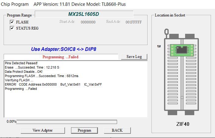

        hello all, i also have a black screen problem on the 5536 model, i have already tried the reflow both on the northbridge and on the southbridge but nothing.
        I wanted to try to flash the bios but with my TL866 I have problems flashing.
        In reads I have to uncheck "verify id" otherwise it won't read me anything.
        When I go to program instead it gives me this:

          Re: Acer 5236/5536 BIOS issue?
          Clean bios pad and try again
          • resistor83
            • Oct 2018
            • 127
            • Italy
            yes I have already tried, I have also tried to change chips taken from another motherboard always the same

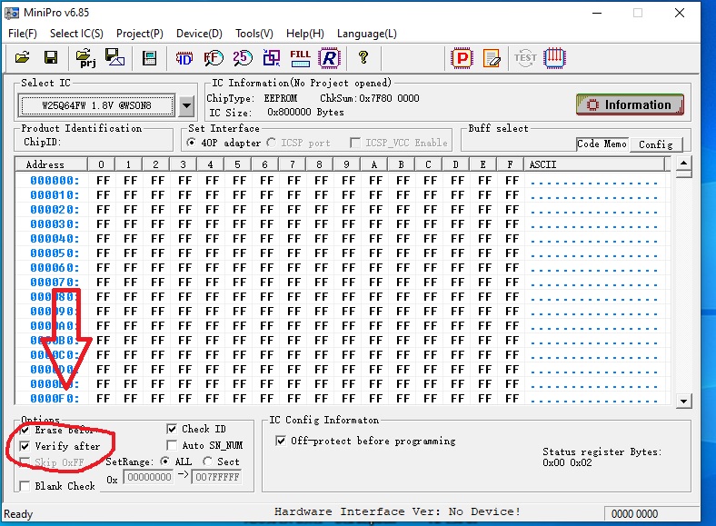

              Try disable verify after
              • resistor83
                • Oct 2018
                • 127
                • Italy
                thank you, now its work!
