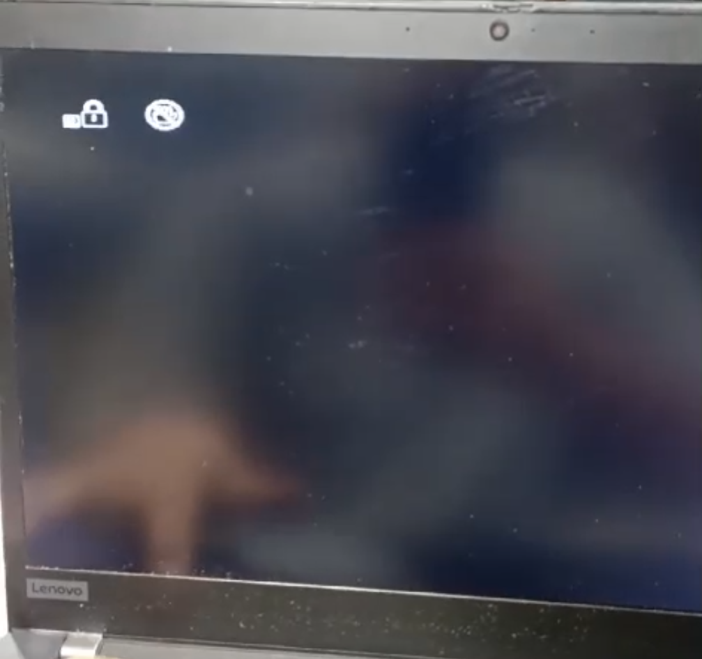

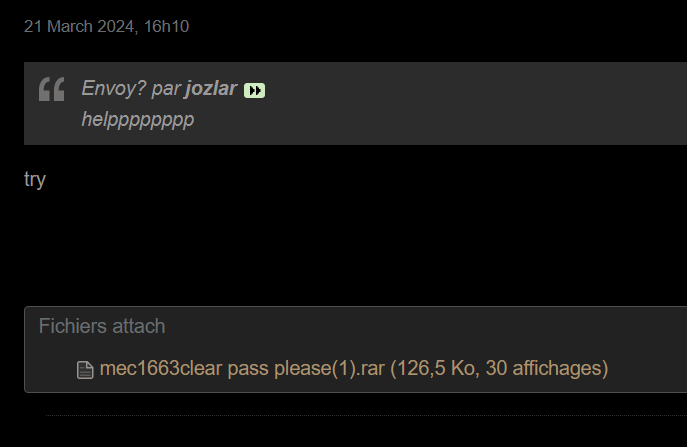

Supervisor password on Lenovo T490 and T490s
  • techrecycle
    replied
    Originally posted by ivanescu
    Good morning, I need help to unlock SVP in a t490s, I was tried with lenovo_autopatcher but it only beeps when I boot it.
    S/N: PC1PPZ1P
    Type: t490s 20NY
    Motherboard: FT491/FX390 NM-B891
    I found the SVP in a mail. Thanks
    TRY THIS AND UPDATE,,
    Leave a comment:
  • Qwerty987
    replied
    Originally posted by benjas11
    Hello , I hope someone can help me. I have an Lenovo T490 with motherboard FT490/FT492/FT590/FP531 NM-B901 Rev:1.0 2018-12-28. This laptop looks to have an bios supervisor password because if i type enter it shows bios information but I cant edit anything. My question is if this is posible to clear that password. And it some one can tell me the steps if posible. Thank you!
    Hey, did you ever get this sorted. I have the exact same issue and I keep going round in circles as a noob, thanks
    Leave a comment:
  • ivanescu
    replied
    Good morning, I need help to unlock SVP in a t490s, I was tried with lenovo_autopatcher but it only beeps when I boot it.
    S/N: PC1PPZ1P
    Type: t490s 20NY
    Motherboard: FT491/FX390 NM-B891
    I found the SVP in a mail. Thanks
    Last edited by ivanescu; 05-12-2025, 05:12 AM.
    Leave a comment:
  • lint4u
    replied
    Originally posted by qwerty4512
    PLEASE HELP ME
    Password on MEC1663 IC
    Pls Use Veryanov or RT809H to unlock the passoword
    Leave a comment:
  • qwerty4512
    replied
    I need your help, can anyone help me open the locked bios file? I've tried several dumps here and there is no power
    TYPE: T490
    CODE:NM-B901
    S/N:PF1VJMDX
    THANK YOU​
    Leave a comment:
  • jomerfx28
    replied
    Originally posted by juanespty
    Hi.
    I have a Lenovo T490 (S/N PF-1DN15F / Type 20N3-S1J700) laptop that requests fingerprint authentication or password when powered on:
    Why is it not working? 🤔
    Maybe you could try to follow this guy's Mec1663Clearpassword dump.
    https://www.badcaps.net/forum/troubl...e4#post3203421
    Using Mec1633_256K, you can't used auto detect IC on that, because its a MEC1663
    Last edited by SMDFlea; 12-12-2024, 11:38 AM. Reason: edit full quote
    Leave a comment:
  • benjas11
    replied
    Hello , I hope someone can help me. I have an Lenovo T490 with motherboard FT490/FT492/FT590/FP531 NM-B901 Rev:1.0 2018-12-28. This laptop looks to have an bios supervisor password because if i type enter it shows bios information but I cant edit anything. My question is if this is posible to clear that password. And it some one can tell me the steps if posible. Thank you!
    Leave a comment:
  • melchizedek
    replied
    hello guys,
    I have a lenovo t490 i7 notebook.
    is there a way to change the password on the lenovo t490 without soldering the motherboard?
    At least a procedure to try before soldering motherboard...
    Thanks for your reply.
    Leave a comment:
  • juanespty
    replied
    Hi.
    I have a Lenovo T490 (S/N PF-1DN15F / Type 20N3-S1J700) laptop that requests fingerprint authentication or password when powered on:
Name:	fingerprint.png
Views:	1119
Size:	388.6 KB
ID:	3492388 Click image for larger version
Name:	password.png
Views:	1112
Size:	402.1 KB
ID:	3492389
    I've tried to unlock the laptop by following the instructions posted here and here, but so far I've had no luck.
    I bought an RT809H programmer and:
    • Installed the iFix Programmer Software version 20240116
    • Disassembled the laptop and removed the motherboard
    • Removed the CMOS Battery
    • Moved the 10K resistor to a new location
Name:	resistor.jpg
Views:	967
Size:	156.6 KB
ID:	3492391
    • Soldered 5 wires (TMS, TDI, TDO, TCK, GND) from JTAG1 in the motherboard, to the RT809H programmer
Name:	motherboard 1.png
Views:	974
Size:	3.11 MB
ID:	3492392 Click image for larger version
Name:	motherboard 2.png
Views:	953
Size:	453.1 KB
ID:	3492393
    • Connected the Laptop A/C Adapter to the motherboard so that it has power (I don't try to "turn the laptop on" by pressing any button)
    • Tried to read the chip from the Programmer software using the SMSC MEC1633_256K Partnumber (Also tried MEC1633 #ISP)
    Whenever I try to read the chip from the programmer, I get this error:
Name:	sofwtare.png
Views:	963
Size:	173.6 KB
ID:	3492390
    MEC Chip ID: 0xFFFFFFFF
    ID verification error.​
    Also, If I try to auto detect the chip, I get:
Name:	autodetect 1.png
Views:	1106
Size:	17.9 KB
ID:	3492394 Click image for larger version
Name:	autodetect 2.png
Views:	959
Size:	65.1 KB
ID:	3492395
    Why is it not working? 🤔
    Leave a comment:
  • Kind_Drop
    replied
    Have you tested this method on P53s 20N6 Serial number PF292CDY? I can't find the schematics for this motherboard, and it seems different from the P53. Thank you!
    Leave a comment:
  • Maxpower3
    replied
    Originally posted by jomerfx28
    why do all that, when a clean of Mec eprom enough, without having used the lenovo utility
    and already unlocked​
    Cliquez sur l'image pour la voir en taille r?elle   Nom : 		image.png  Affichages :	0  Taille :		21,2 Ko  ID : 			3342881
    Last edited by Maxpower3; 09-03-2024, 09:51 AM.
    Leave a comment:
  • jomerfx28
    replied
    Originally posted by jozlar
    please help mec unnlock
    Follow this steps i made
    https://www.badcaps.net/forum/troubl...e4#post3342869
    Leave a comment:
  • arif3203
    replied
    Originally posted by Rexer Anthony
    Re: Supervisor password on Lenovo T490 and T490s
    LENOVO THINKPAD
    T490 T590 FT490 FT492 FT590 FP531 NM-B901 REV 1
    this main supports all the models above and the MEC is also unlocked.
    tested bios display but cannot to change serial number with lenovo uone/lenovo golden key,or maintenance disket 1.89,any solution for change serial number? thank you
    Leave a comment:
  • jomerfx28
    replied
    Help for a Lenovo Thinkpad T490s Bios Password or supervisor password, the original bios file, even though a shorts the contacts for tamper protection, it doesnt go off
    S/N PC1CX7GV
    Lenovo thinkpad t490s
    FT491/FX390 NM-B891 Rev 2.0
    Leave a comment:
  • techrecycle
    replied
    hello everyone
    please help me to remove svp, file is attached, THANKS
    serial number : PC19K3GL
    Leave a comment:
  • EGUG
    replied
    @abelkakraba: You only have to write back your original saved Bios. After that it will restart with the same status as before using the Lenovo patcher.
    Leave a comment:
  • abelkakraba
    replied
    Originally posted by AAAC
    Re: Supervisor password on Lenovo T490 and T490s
    @mgjini
    In my experience, when you erase the EC chip to reprogram it, is when the internal EEPROM contents are erased too, that EEPROM memory hold the Supervisor Password among other data like Model Number, Serial Number, TYPE, etc.
    So depending on the programmer you are using the next step is to reprogram the EC chip with the exact file you saved from EC, then use the software utility (ThinkPad Maintenance Utility) that is in another post to program the ThinkPad DMI information.
    I've verified the EC file you uploaded, version N2IHT39W, with the corresponding BIOS/EC update downloaded from Lenovo and it is an exact copy; I just had to delete the header from the EC update (first 32-bytes) and the tail starting from 40000h all the way to the end, then I could do the comparison of both files.
    I have really learned a lot reading your post, and i am grateful for having kindhearted people like you here. Instead of working on the Jtags to clear my supervisor password on my ThinkPad T490 i mistakenly used the Lenovo patcher with my bios file of 32mb. Afterwards i am not getting any display, can you assist me to get the machine working again.
    Leave a comment:
    commented on 's reply
    Thread merged with existing topic. Read the rules,the laptop serial number must be posted https://www.badcaps.net/forum/troubl...before-posting
  • Macdonald
    replied
    Originally posted by AAAC
    @Macdonald
    I've downloaded and extracted the same EC update version as in your file, trimmed the 32-byte header from the EC update version N2IHT42W, here's the complete file (262,144 bytes or 256kB). Check your programmer and select a chip size of at least 256kB or greater and try, it should work.
    Hie i tried it but still its not working the machine is only powering orange light on power and nothing else
    Leave a comment:
  • bobans1983
    replied
    Locked bios please unclok. Thanks in advance .
    Leave a comment:
  • AppleLover123
    Lenovo Yoga X380 22LH Supervisor Password removal
    by AppleLover123
    Hey guys,
    have a laptop here that has a supervisor Password (dump in Attachements).
    Before i write the Serial NR.etc i wanted to say that strangely after flashing with 3 different Bios dumps and one from lenovos site
    the laptop works but everytime it wants me to type a supervisor password i never set.
    I thought the supervisor password is stuck in the ec bios but no it isn't either because after replacing the ec chip from one of another board it still has the supervisor password.
    Anyway i wanted to ask what of the two chips is the ec bios because on the left...
    04-17-2025, 03:42 PM
  • baaligoga
    Help needed in unlocking BIOS Supervisor password - Lenovo X1 Yoga 5th Gen
    by baaligoga
    Good day, everyone!
    I'm encountering an issue with my Lenovo X1 Yoga 5th Gen laptop related to the BIOS supervisor password. I'm seeking assistance and guidance from the knowledgeable members of this community in resolving this problem.
    I am no expert and cannot perform soldering or unsoldering of the chip from the board. Therefore, I attempted to use an EZP 2023 programmer with a clip to extract the BIOS bin file without removing the BIOS chip from the motherboard. The BIOS chip has the following letters imprinted on it: "Winbond 25Q80DVNIG 2026". I used the...
    05-20-2023, 09:48 AM
  • Andreasandreou
    Lenovo Thinkpad T14s GEN 4 Supervisor Password Bypass
    by Andreasandreou
    Hello, I have Lenovo Thinkpad T14s GEN 4 serial number GM-0FK2ER laptop. It was brought to me by a customer to reinstall windows. The problem is it is locked with a superviser password. Can anyone please give instructions on how to reset the bios or bypass the supervisor password? Thank you.
    09-02-2025, 09:45 AM
  • vijayppatel017
    Lenovo Thinkpad X13 Gen 6 BIOS Supervisor Password Remove
    by vijayppatel017
    i have Lenovo Thinkpad X13 gen 6. with supervisor password enable. anyone know how to remove it. as i am starting this thing first time so dont know. but i am good in solder.
    10-12-2025, 09:04 AM
  • Pusher
    Lenovo P16 Gen1 Supervisor Password from factory
    by Pusher
    Hi, I bought a Lenovo P16 Gen1 from a private seller. The box was still originally sealed but when I want to enter the BIOS a supervisor password is required. Is it possible that the notebook was delivered by Lenovo with a password? What can I do to reset the password? Unfortunately, I no longer have contact with the seller.
    11-08-2023, 12:14 PM
