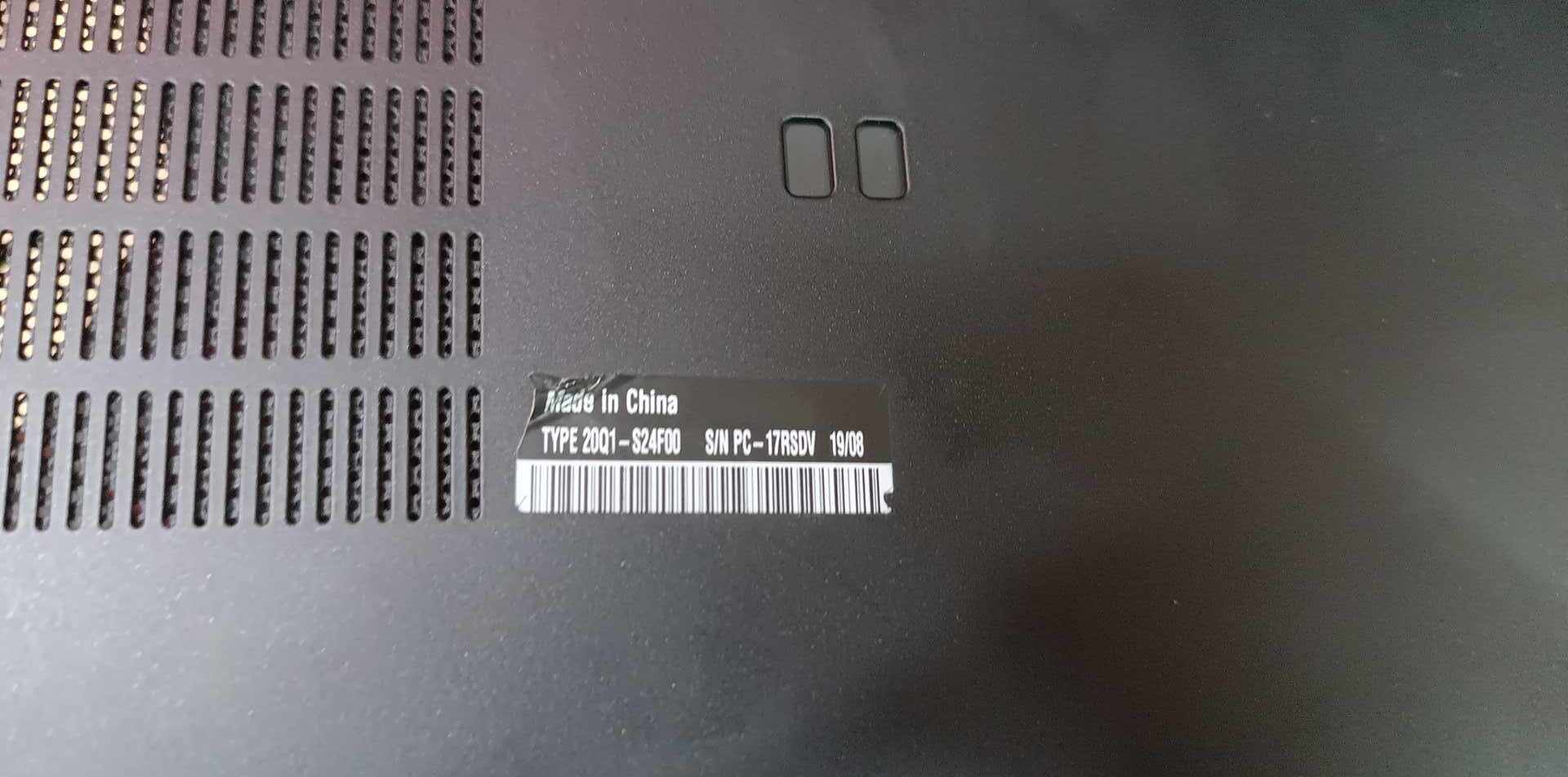

Supervisor password on Lenovo T490 and T490s
  • AAAC
    replied
    @Macdonald
    I've downloaded and extracted the same EC update version as in your file, trimmed the 32-byte header from the EC update version N2IHT42W, here's the complete file (262,144 bytes or 256kB). Check your programmer and select a chip size of at least 256kB or greater and try, it should work.
    Leave a comment:
  • Macdonald
    replied
    hie i have a Lenovo t490 with supervisor password
    i tried to read the MEC1663 using RT809H programmer JTag connection i manged to read the file it with a total size of 192kb the challenge i am getting is when i write it back the file its not switching on
    i read my file using MEC1633 #ISP but my my chip is MEC1663
    From others i discovered that the file size is 288kb
    Serial number
    PF-25657G
    Type Number
    20N3-S7YA06
    I am sending the file read
    can someone help me thank you
    i am using an RT809H programmer
    Leave a comment:
  • Deniz
    replied
    Originally posted by rex98
    Re: Supervisor password on Lenovo T490 and T490s
    LENOVO THINKPAD
    T490 T590 FT490 FT492 FT590 FP531 NM-B901 REV 1
    this main supports all the models above and the MEC is also unlocked.
    Firstly, thank you. How do I connect jtag to write MEC. Can you help?
    Leave a comment:
  • danito
    replied
    need many try, look video for timing and procedure
    yes, I didn't succeed. in the end, with the old method of moving the resistance, I succeeded.
    Leave a comment:
  • Maxpower3
    replied
    Originally posted by danito
    Lenovo T490 had supervisor password.
    After I made it short, I can't enter the bios because it's the user password. Can you help me please?
    need many try, look video for timing and procedure
    Leave a comment:
  • danito
    replied
    T490 or 490S?
    try
    https://www.badcaps.net/forum/troubl...ss#post3237235
    T490 NM-B901 LPC PORT
    Cliquez sur l'image pour la voir en taille r?elle  Nom : 		T490 NM-B901 LPC PORT .jpg  Affichages :	0  Taille :		253,8 Ko  ID : 			3239704
    Thinkpad T490s - NM-B891
    Click image for larger version  Name:	Thinkpad T490s - NM-B891 LPC PORT.jpg Views:	0 Size:	163.5 KB ID:	3239706
    Lenovo T490 had supervisor password.
    After I made it short, I can't enter the bios because it's the user password. Can you help me please?
    Leave a comment:
  • Maxpower3
    replied
    Originally posted by jozlar
    helpppppppp
    try
    Leave a comment:
  • Maxpower3
    replied
    T490 or 490S?
    try
    https://www.badcaps.net/forum/troubl...ss#post3237235
    T490 NM-B901 LPC PORT
    Cliquez sur l'image pour la voir en taille r?elle   Nom : 		T490 NM-B901 LPC PORT .jpg  Affichages :	0  Taille :		253,8 Ko  ID : 			3239704
    Thinkpad T490s - NM-B891
Name:	Thinkpad T490s - NM-B891 LPC PORT.jpg
Views:	2330
Size:	163.5 KB
ID:	3239706
    Last edited by Maxpower3; 03-21-2024, 06:29 AM.
    Leave a comment:
  • techrecycle
    replied
    thanks i tried but not display
    Leave a comment:
    commented on 's reply
    Off topic,this thread for T490 and T490s
    commented on 's reply
    https://www.badcaps.net/forum/troubl...64#post1864864
  • techrecycle
    replied
    lenovo T490s admin passwords please unlock thanks
    sn :PC19K3VK
    Leave a comment:
  • iori1881
    replied
    hello everyone ,
    i need to unlock bios password for lenovo thinkpad T490
    Serial number : PF-1K1XYW 19/16
    TYPE : 20N2-0009UK
    FT490/FT492
    FT590/FP531
    NM-B901 REV: 1.0
    THANK YOU.
    Leave a comment:
  • jozlar
    replied
    Originally posted by SMDFlea
    • The serial number, make, full model number, motherboard model and revision (except QR codes) must be written/typed at your request as per the rules. Not as a picture, part of the file name and so on.
    TYPE 20Q1-S24F00
    S/N PC-17RSDV
    X390
    FT491/FX390 NM-B891 REV 2.0
    Leave a comment:
    commented on 's reply
    Is it so difficult to type the serial number ?
    replied
    Originally posted by jozlar
    helpppppppp
    • The serial number, make, full model number, motherboard model and revision (except QR codes) must be written/typed at your request as per the rules. Not as a picture, part of the file name and so on.
    Leave a comment:
  • jozlar
    replied
    helpppppppp
    Leave a comment:
  • Maxpower3
    replied
    Originally posted by jozlar
    please help mec unnlock
    need serial number, read rules
    clear 300 to 33F
    Leave a comment:
  • Vesko356
    commented on 's reply
    RULES UPDATE for BIOS requests/offers AVOID BANNING, READ BEFORE POSTING
    https://www.badcaps.net/forum/troubl...before-posting
    You MUST:
    • Provide the full machine model number, serial number (or Service tag, SNID) and the board model number (see https://www.badcaps.net/forum/showthread.php?t=88758 ) ,The serial number, make, full model number, motherboard model and revision (except QR codes) must be written/typed at your request as per the rules. Not as a picture, part of the file name and so on.
  • jozlar
    replied
    please help mec unnlock
    Leave a comment:
  • AppleLover123
    Lenovo Yoga X380 22LH Supervisor Password removal
    by AppleLover123
    Hey guys,
    have a laptop here that has a supervisor Password (dump in Attachements).
    Before i write the Serial NR.etc i wanted to say that strangely after flashing with 3 different Bios dumps and one from lenovos site
    the laptop works but everytime it wants me to type a supervisor password i never set.
    I thought the supervisor password is stuck in the ec bios but no it isn't either because after replacing the ec chip from one of another board it still has the supervisor password.
    Anyway i wanted to ask what of the two chips is the ec bios because on the left...
    04-17-2025, 03:42 PM
  • baaligoga
    Help needed in unlocking BIOS Supervisor password - Lenovo X1 Yoga 5th Gen
    by baaligoga
    Good day, everyone!
    I'm encountering an issue with my Lenovo X1 Yoga 5th Gen laptop related to the BIOS supervisor password. I'm seeking assistance and guidance from the knowledgeable members of this community in resolving this problem.
    I am no expert and cannot perform soldering or unsoldering of the chip from the board. Therefore, I attempted to use an EZP 2023 programmer with a clip to extract the BIOS bin file without removing the BIOS chip from the motherboard. The BIOS chip has the following letters imprinted on it: "Winbond 25Q80DVNIG 2026". I used the...
    05-20-2023, 09:48 AM
  • Andreasandreou
    Lenovo Thinkpad T14s GEN 4 Supervisor Password Bypass
    by Andreasandreou
    Hello, I have Lenovo Thinkpad T14s GEN 4 serial number GM-0FK2ER laptop. It was brought to me by a customer to reinstall windows. The problem is it is locked with a superviser password. Can anyone please give instructions on how to reset the bios or bypass the supervisor password? Thank you.
    09-02-2025, 09:45 AM
  • vijayppatel017
    Lenovo Thinkpad X13 Gen 6 BIOS Supervisor Password Remove
    by vijayppatel017
    i have Lenovo Thinkpad X13 gen 6. with supervisor password enable. anyone know how to remove it. as i am starting this thing first time so dont know. but i am good in solder.
    10-12-2025, 09:04 AM
  • Pusher
    Lenovo P16 Gen1 Supervisor Password from factory
    by Pusher
    Hi, I bought a Lenovo P16 Gen1 from a private seller. The box was still originally sealed but when I want to enter the BIOS a supervisor password is required. Is it possible that the notebook was delivered by Lenovo with a password? What can I do to reset the password? Unfortunately, I no longer have contact with the seller.
    11-08-2023, 12:14 PM
