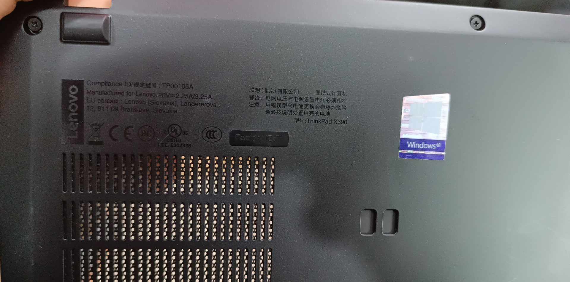

    • jozlar
      • Mar 2022
      • 59
      • tbilisi
      #63
      Originally posted by SMDFlea
      • The serial number, make, full model number, motherboard model and revision (except QR codes) must be written/typed at your request as per the rules. Not as a picture, part of the file name and so on.
      TYPE 20Q1-S24F00
      S/N PC-17RSDV
      X390
      FT491/FX390 NM-B891 REV 2.0
        SMDFlea commented
        Editing a comment
        Off topic,this thread for T490 and T490s

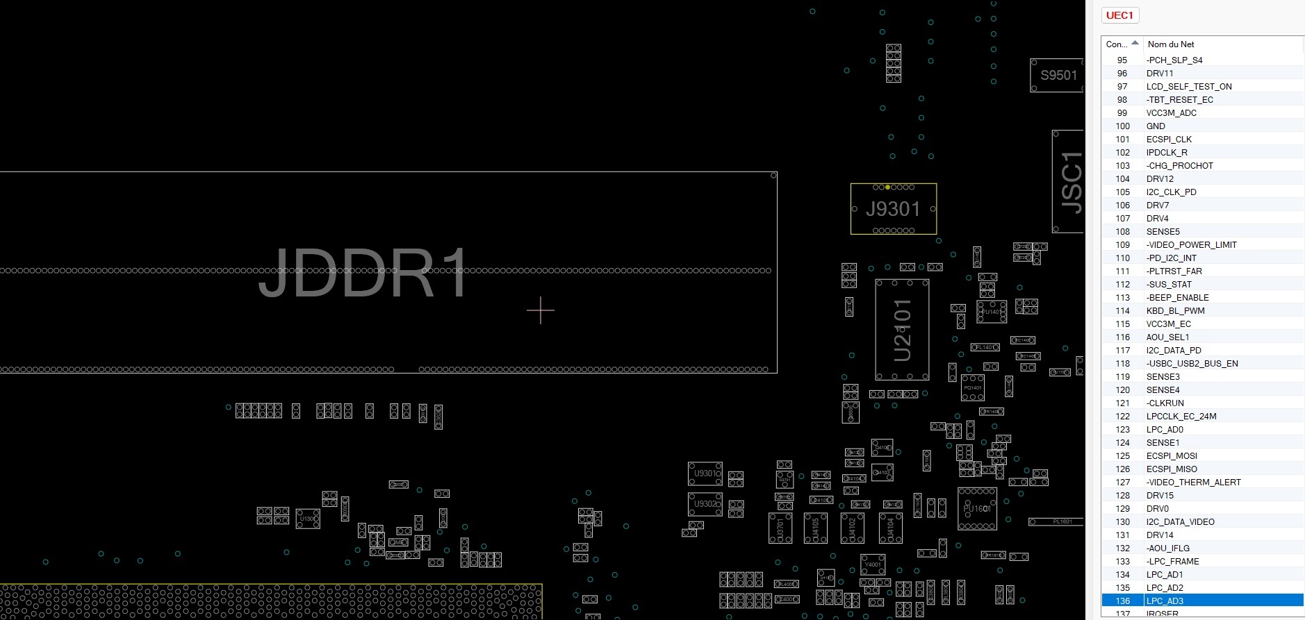

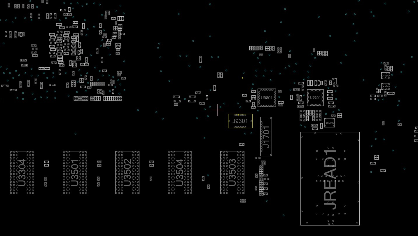

          #67
          T490 or 490S?
          try
          https://www.badcaps.net/forum/troubl...ss#post3237235
          T490 NM-B901 LPC PORT
          Cliquez sur l'image pour la voir en taille r?elle   Nom : 		T490 NM-B901 LPC PORT .jpg  Affichages :	0  Taille :		253,8 Ko  ID : 			3239704
          Thinkpad T490s - NM-B891
Name:	Thinkpad T490s - NM-B891 LPC PORT.jpg

            • danito
              • Jun 2016
              • 1056
              • Romania
              #69
              T490 or 490S?
              try
              Click image for larger version  Name:	Thinkpad T490s - NM-B891 LPC PORT.jpg Views:	0 Size:	163.5 KB ID:	3239706
              Lenovo T490 had supervisor password.
              After I made it short, I can't enter the bios because it's the user password. Can you help me please?
              • Maxpower3
                Bad Veteran
                • Feb 2018
                • 1316
                • France
                #70
                need many try, look video for timing and procedure
                • danito
                  • Jun 2016
                  • 1056
                  • Romania
                  #71
                  yes, I didn't succeed. in the end, with the old method of moving the resistance, I succeeded.
