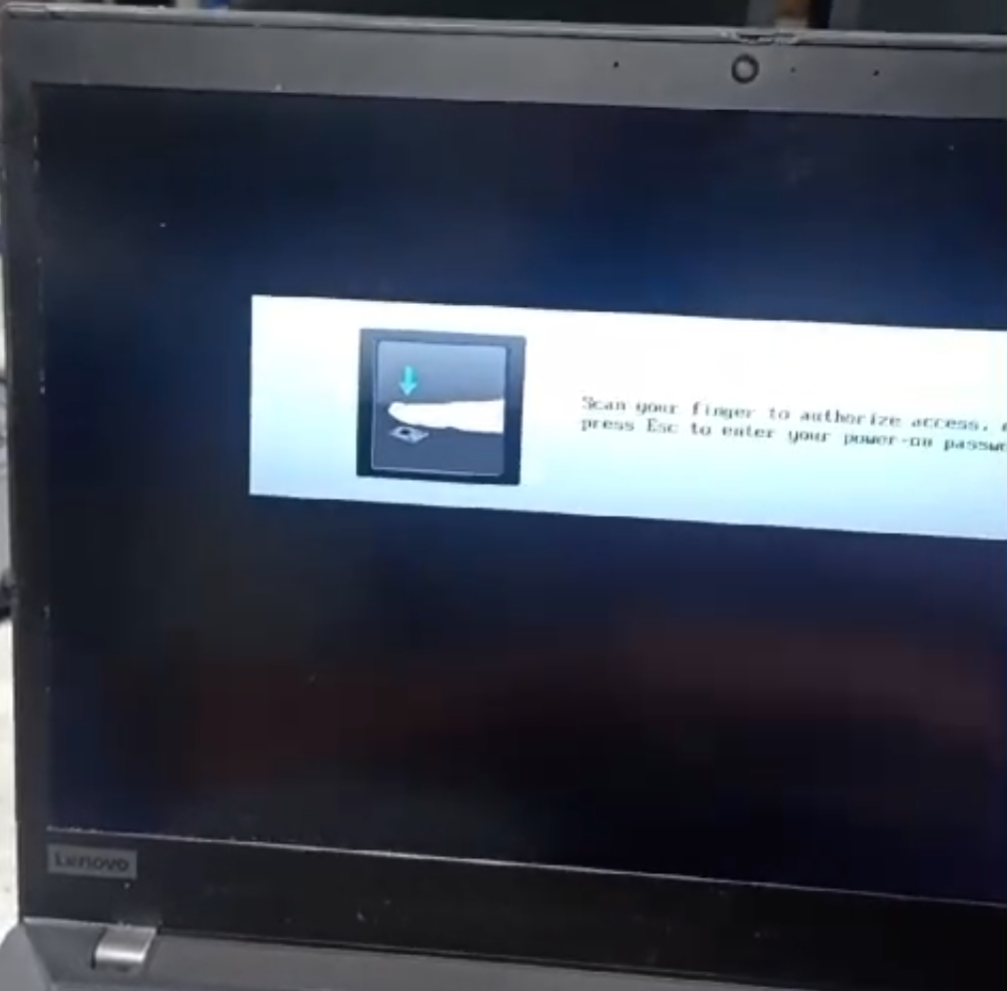

            #85
            Hi.
            I have a Lenovo T490 (S/N PF-1DN15F / Type 20N3-S1J700) laptop that requests fingerprint authentication or password when powered on:
ID:	3492388 Click image for larger version
            I've tried to unlock the laptop by following the instructions posted here and here, but so far I've had no luck.

            • Connected the Laptop A/C Adapter to the motherboard so that it has power (I don't try to "turn the laptop on" by pressing any button)

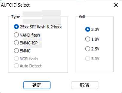

            • Tried to read the chip from the Programmer software using the SMSC MEC1633_256K Partnumber (Also tried MEC1633 #ISP)
            Whenever I try to read the chip from the programmer, I get this error:
            MEC Chip ID: 0xFFFFFFFF
            ID verification error.​
            Also, If I try to auto detect the chip, I get:
ID:	3492394 Click image for larger version
            Why is it not working? šŸ¤”

                  #88
                  Originally posted by juanespty
                  Hi.
                  Maybe you could try to follow this guy's Mec1663Clearpassword dump.
                  https://www.badcaps.net/forum/troubl...e4#post3203421
                  Using Mec1633_256K, you can't used auto detect IC on that, because its a MEC1663
