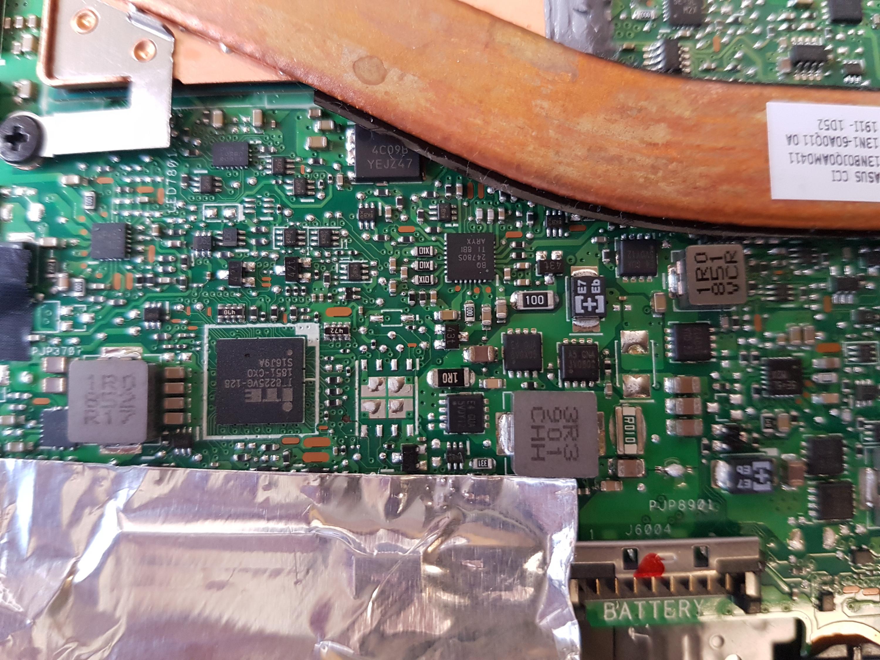

              After all the flashes, soldering, desoledering, computer dosent power on with orginal bios(original had a password), power led on, no cpu vcore, ram voltage, just 5v, 3v, 1.05v, 1.8v is available, suggestions?

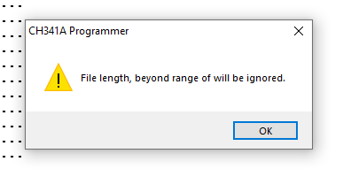

                Try this bios . You can rename it first to bios.bin ,that will stop the error message (post #5) , the CH341A software doesn`t seem to like anything with numbers, dots and dashes in the filename.Erase the bios first, then blank check,write, read and verify
                Edit: The bios at post #4 is corrupt.

                      checked votages, i got :
                      19v on screen connector
                      1.05v
                      1.82v
                      3.30v
                      5.02v
                      EDIT :
                      Maybe someone got this motherboard by the hand? i need 1 value of resistor.

                        What is the serial number on the base cover,and part numbers on the white/green stickers on the board .

                          there's no serial number on cover. sticker on motherboard says
                          PN:60NB0JR0-MB1421 (221) UX433FA 18407902
                          PT:K626NBCV00K6VPMB 69N15ZM14C11(01)
                          On mainbord printed :
                          UX433FN MAIN BOARD
                          REV. 2.2

                            I really need this resistor value, because he's missing from my board :/

                              I answered your post in the schematic requests , No schematics,no boardview available .

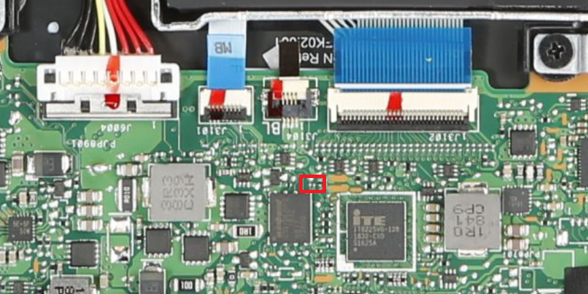

                                I have the really same problem, UX433FN, locked bios, reflashed / NTB power on without video. Put back originbal locked bios / NTB powered without video.
                                Its possible brick EC with bad Bios flash ?
                                PCB picture in attachment, (broken trace from SPICLK repaired ). I have missing component asked in previous question too..
                                Thanks Martin
                                  Working ! Thanks Friend
