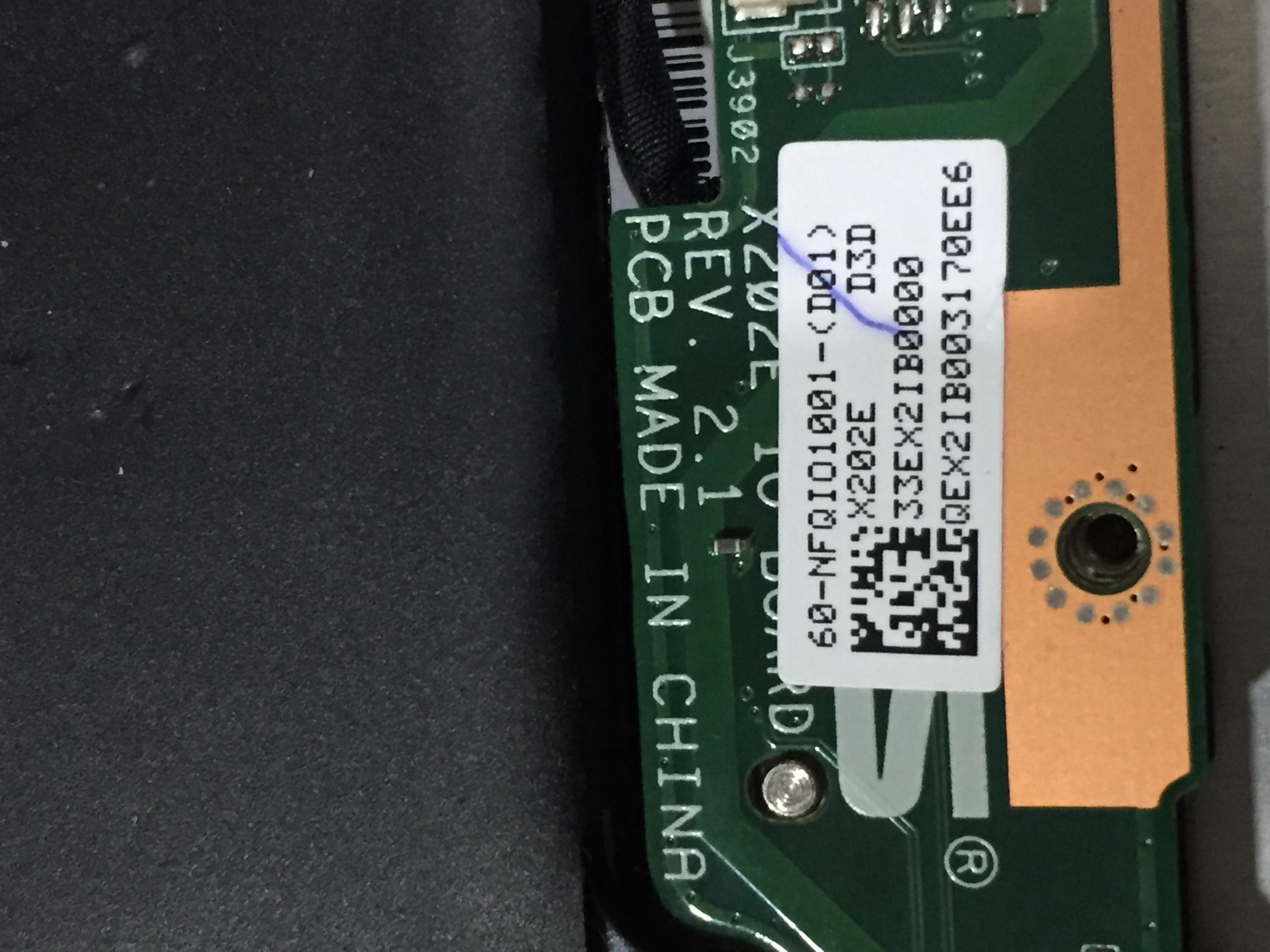

            Re: Asus x202e stuck at asus logo
            here it is
              • 21679
              Thats on the IO daughter board, i meant the ones on the motherboard.

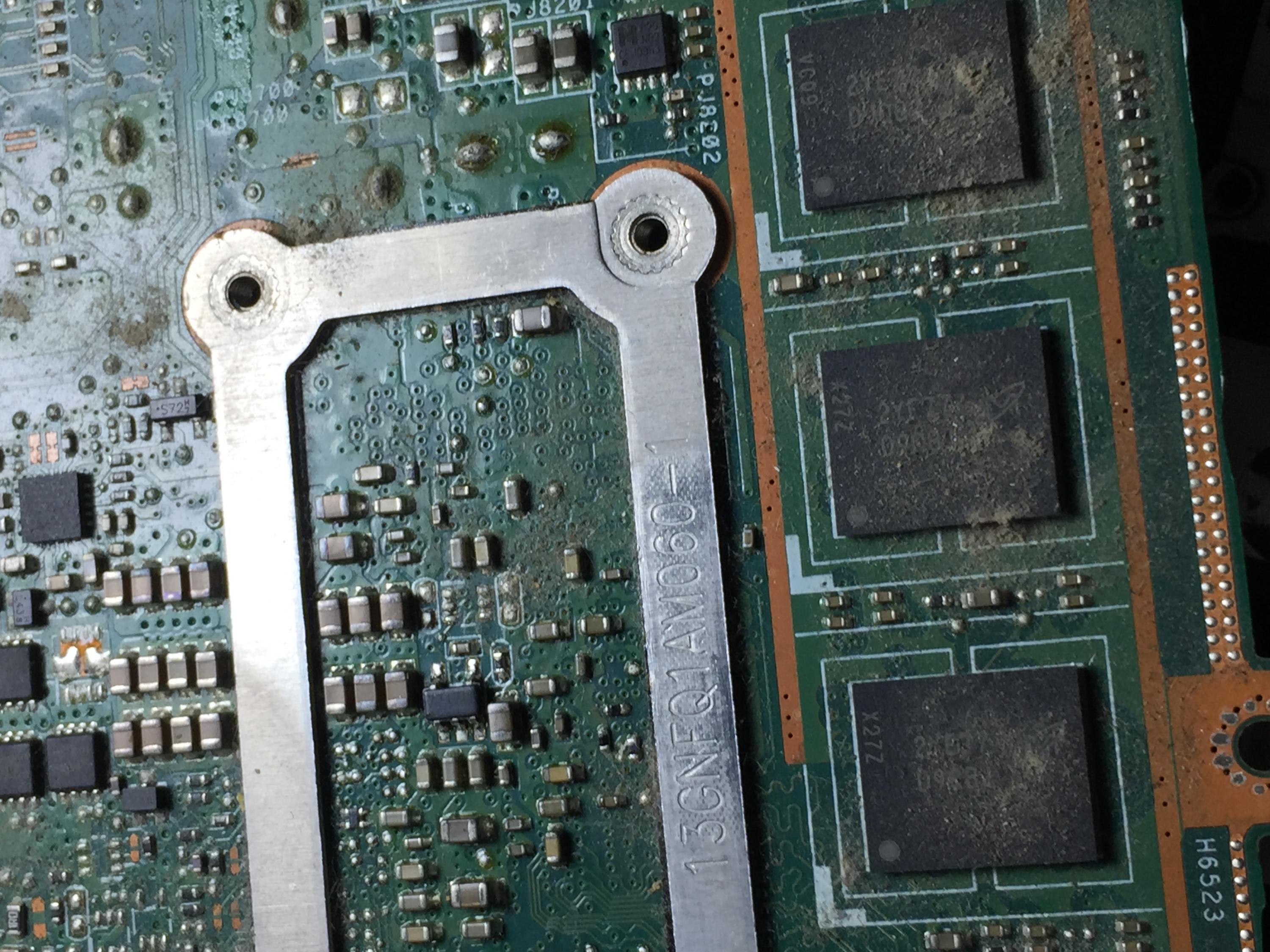

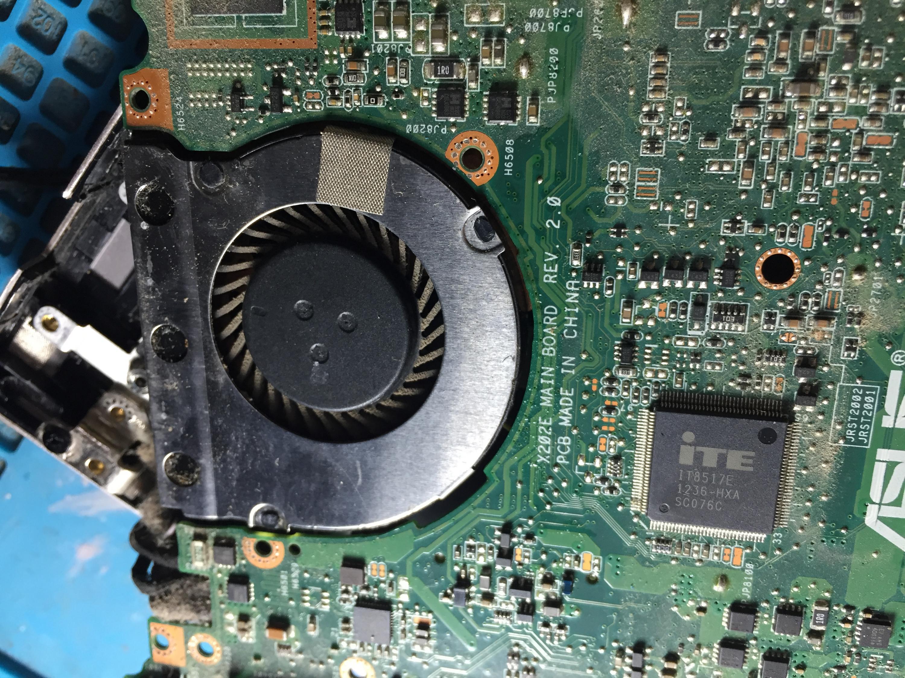

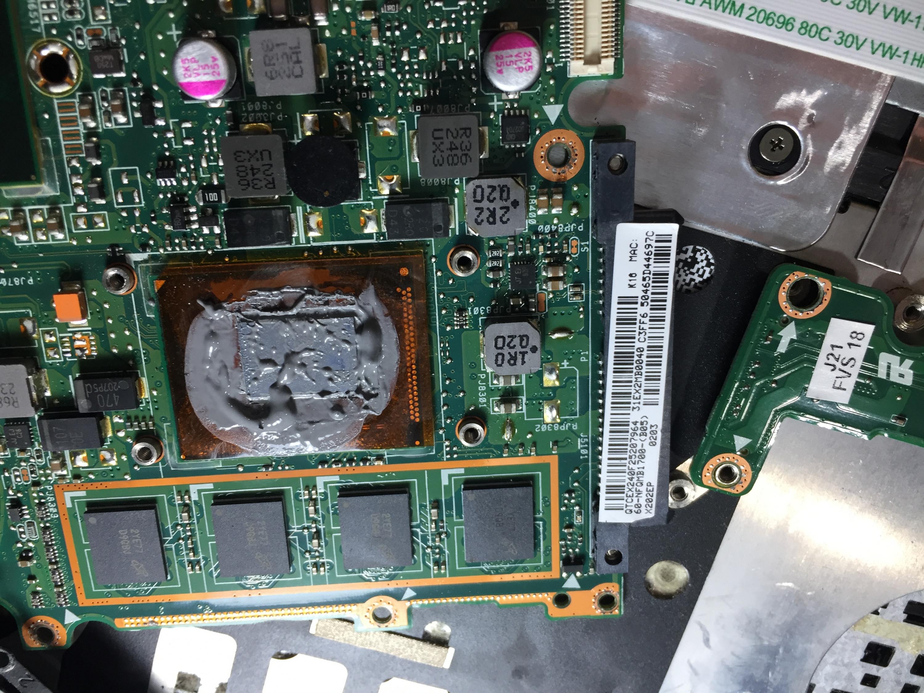

                ok here it is i pullout the board
                  • 21679
                  Is there a sticker on the RAM slot "What part number do you have on the white/green stickers on the motherboard and on the base."
                  Post a picture of the sticker on the RAM slot,if there is one, and the sticker on the Base cover with the serial

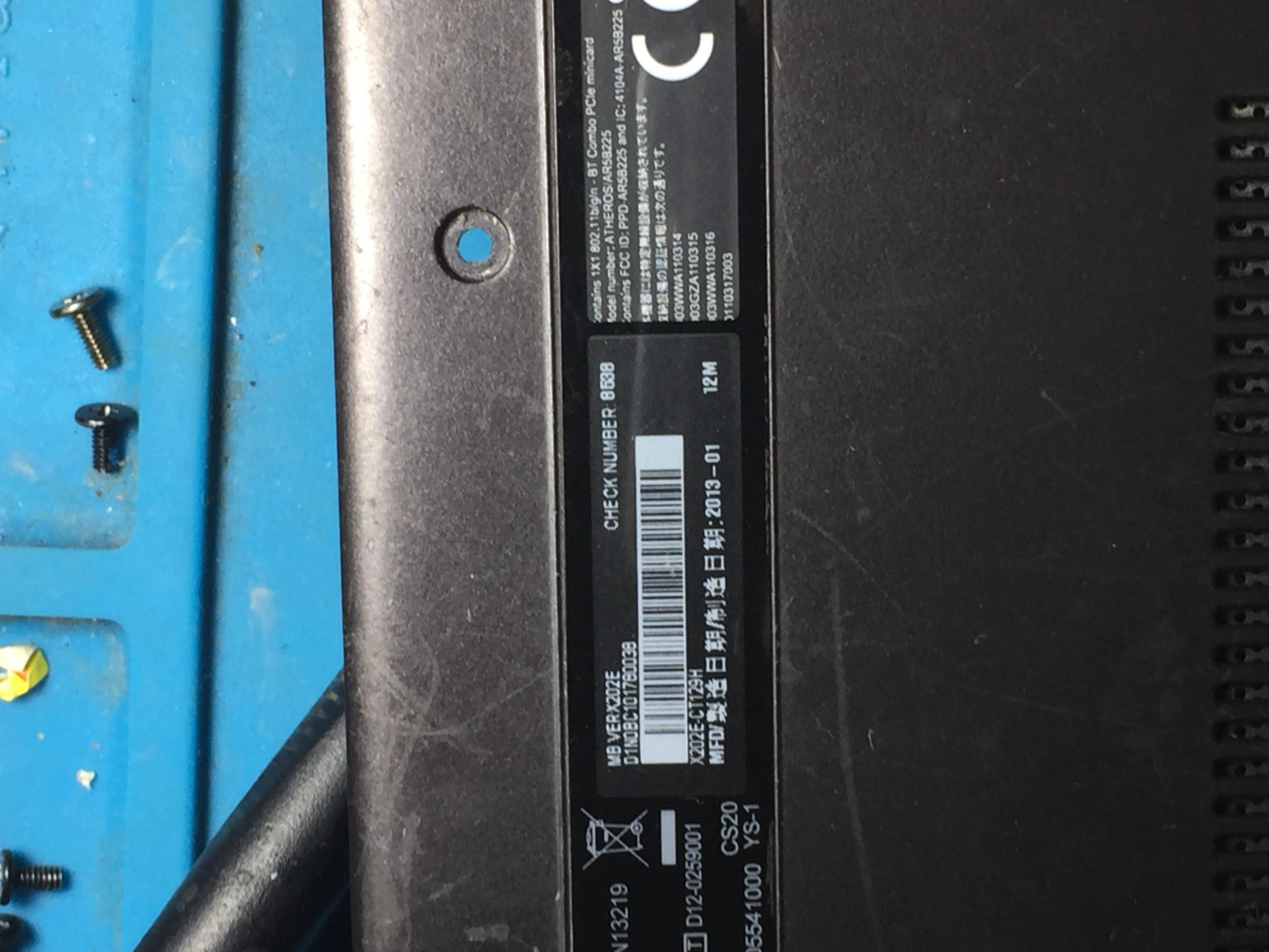

                    no sticker on the ram slot because its onboard, here is another info i took a pic
                    • String2016
                      • Nov 2015
                      • 2238
                      • philippines
                      on the back cover

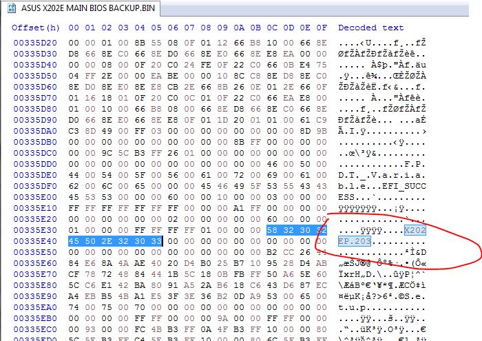

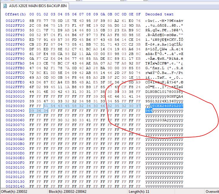

                        • 21679
                        Ok, so the white sticker at post #10 says X202EP and the serial matches the one in the bios,so it is the original bios,the bios by @peste didn`t work so you need to merge the asus X202EP bios update and copy the DMI info and win key .
                              x202ep repaired file with your info and win key.
                              try and report

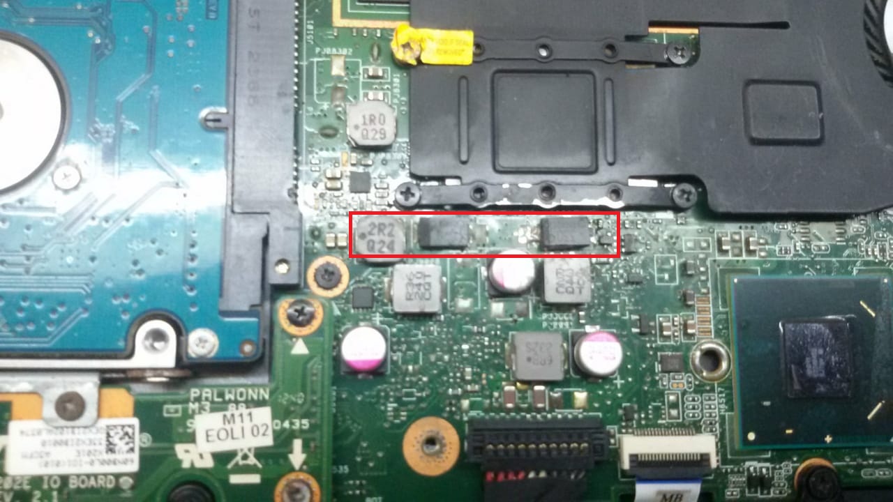

                                    • Bonzas
                                      • 472
                                      • Indonesia
                                      Originally posted by Mulong2019
                                      tried both still the same issue could it be cpu is the prob of this?
                                      Have you checked this capasitor sir ?
                                      i've got a few days ago with same problem, first think bios or hdd problem. but after tried with another hdd & flash other bios problem not solved.
                                      i replaced 220 capasitor with 330, that solved my problem
                                      sorry for my english
                                        @martha februarini thank you for the idea i will try to replace. did you replaced two capacitor to 330uf?
