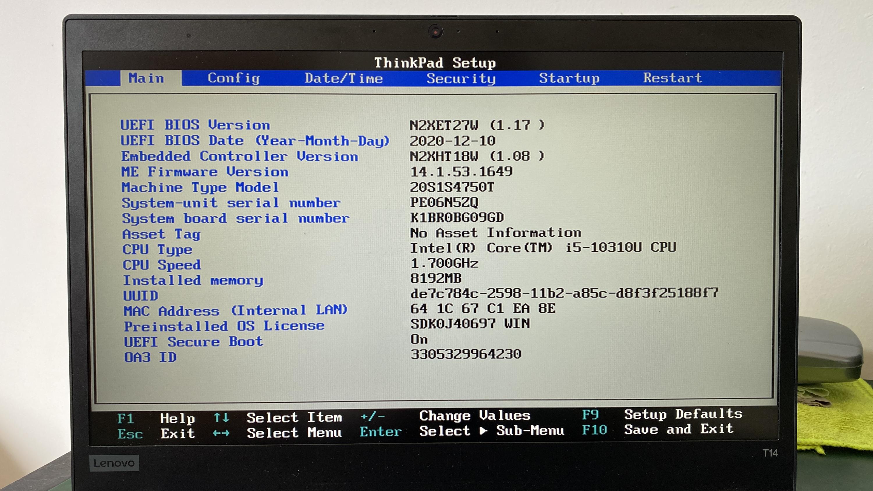

      Originally posted by 69d0b913
      After a lot of persistence I managed to remove the T14 bios password! I believe that few here know how to do it and no one shares it, I understand that certain types of information are not shared and are sold! But I persisted, and I come to inform you that the (Thinkpad T14 1st 20S1) was unlocked by an RT809H the only programmer I have, as I don't have access to a vertyanov. Here are the photos in the attachment, now I just need to invert the bios information, but I had taken a photo before.
      you shold be 290K zise of MEC1663 and you see the HXD the information in the last 2k
      • 69d0b913
        • Mar 2018
        • 146
        • BR
        #163

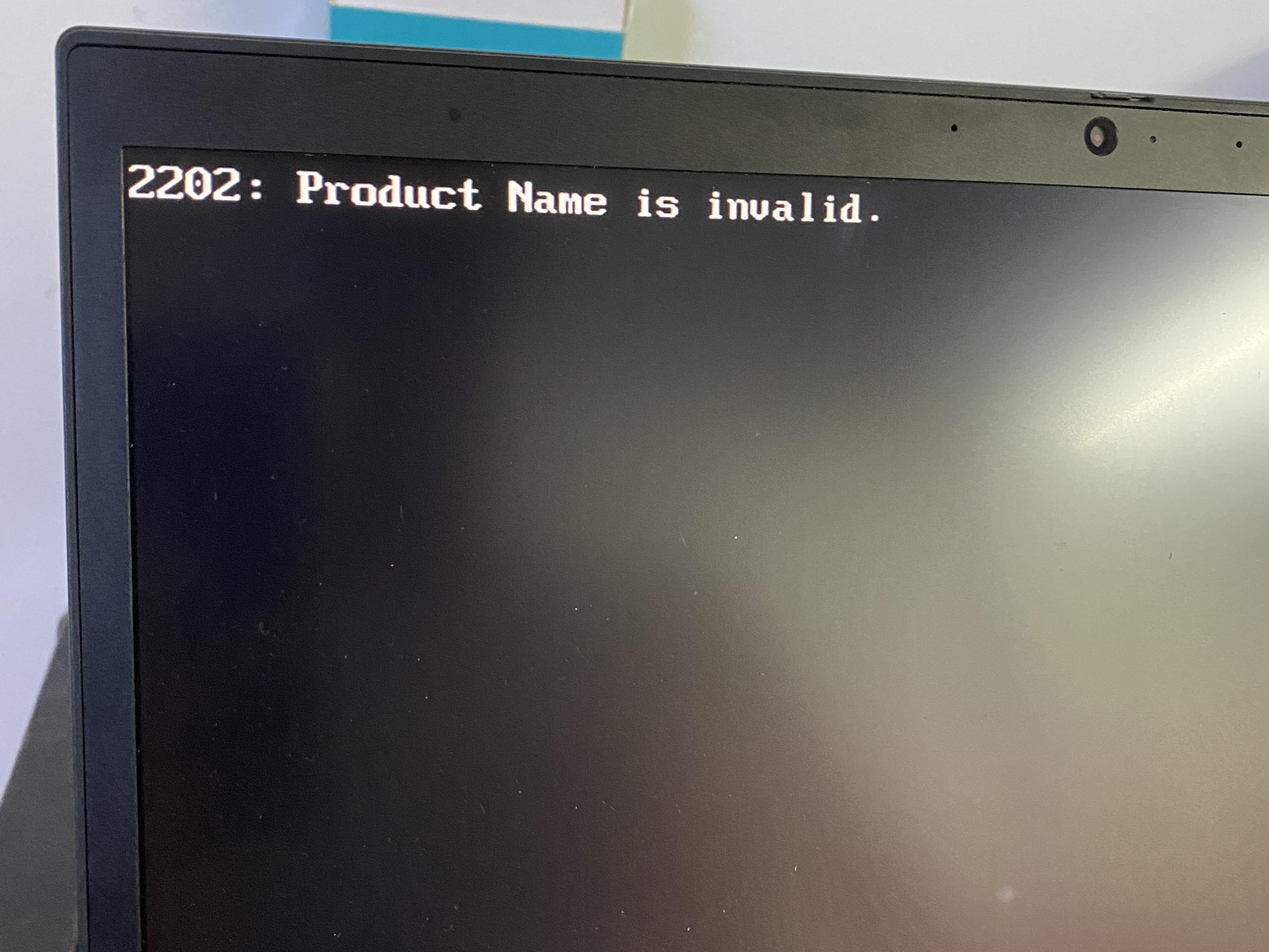

        Re: mec 16xx dump with info block
        Now I have another problem, I already corrected all the information in the T14 bios, but now I have an error at startup (2202: Product Name is Invalid) I tried with lenovo maintenance utility v1.08, 1.11, 1.89 and it is not working, does anyone know how to fix?
        • 69d0b913
          • Mar 2018
          • 146
          • BR
          #164
          Finally, I managed to solve this damn T14 again. Now it works perfectly without a password and without computrace.
