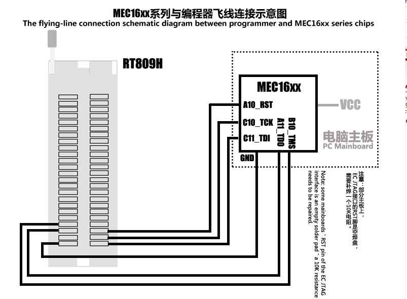

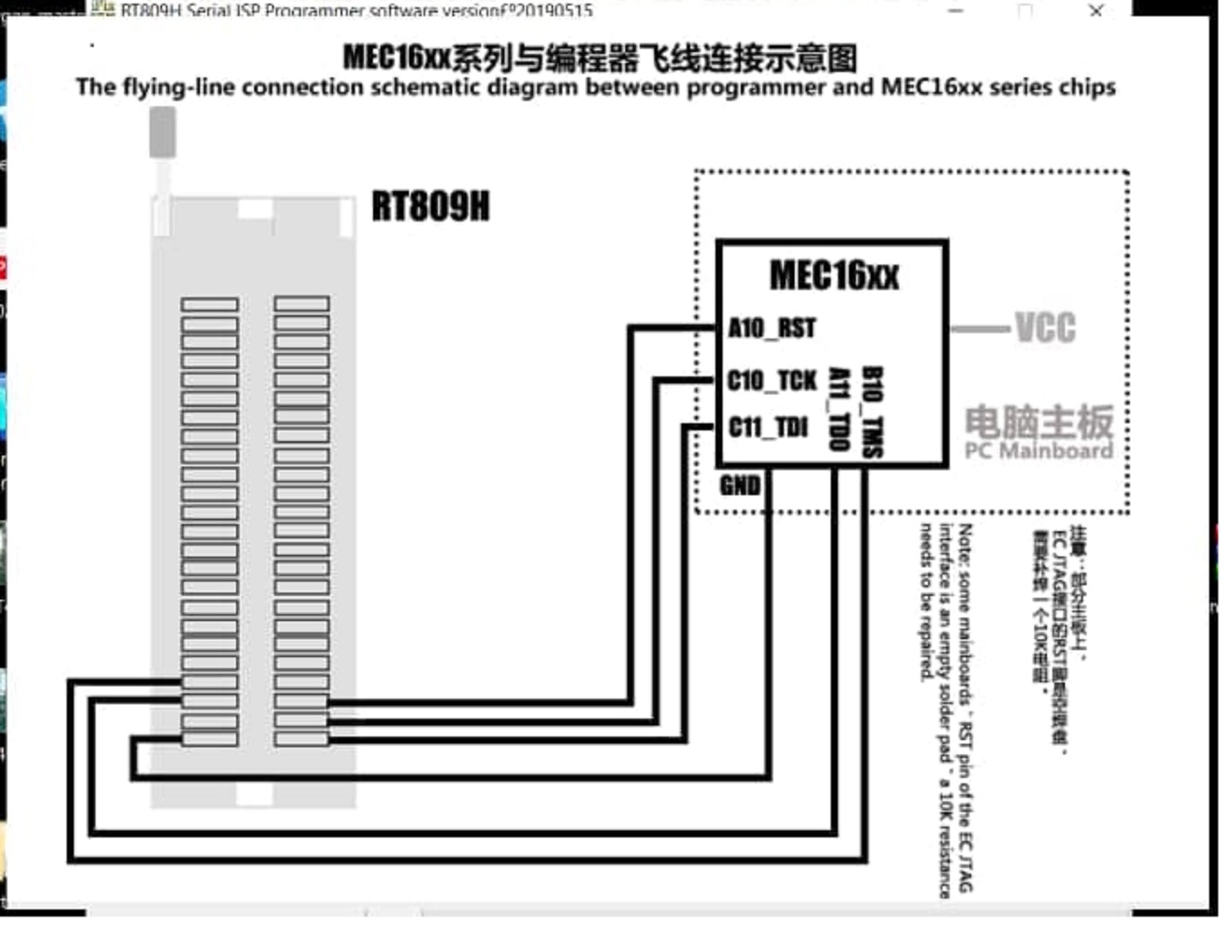

      #142
      Re: mec 16xx dump with info block
      Originally posted by 69d0b913
      Thanks for the answer, but it doesn't seem to be that simple, everything is in place, everything is checked, choosing MEC1633 256kb or MEC1653 should do the reading normally, but this is not happening, if you haven't seen the video I posted I suggest you take a look and watch the full video, I've had this machine for 8 months, it's been 2 months since I bought an rt809h and for 1 week I've been trying to read the MEC without error, and I get the message shown in the video I made.
      did you connect the wire like this to the programmer?

        • LenBios
          • 122
          • Ker
          #144
          just select the chip MEC1653 manualy double click MEC1653, do not click smart identity smartID
          • 69d0b913

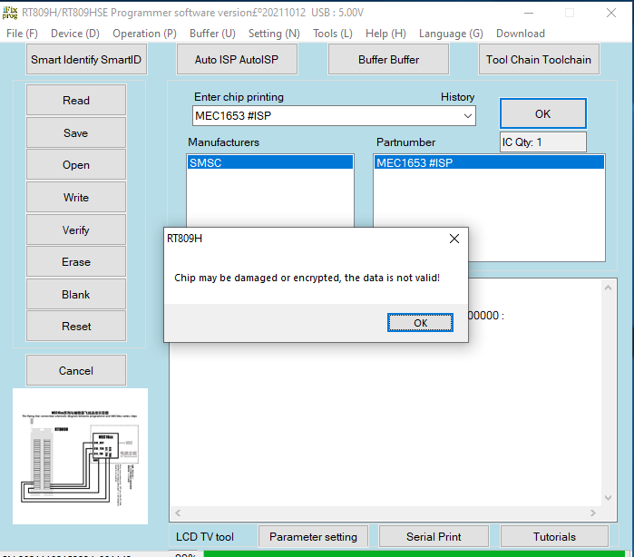

            #145
            I think you didn't understand the video. I made the video to show all the ways I tried and nothing works. I've already selected all the MEC16xx chips and it doesn't work, it reads with error, if you watched the whole video you can see what happens for sure, it's not working, there's something else to do and I don't know what it is, the reading doesn't and done the file is empty with no data inside. In this video a Russian does it in a different way, he puts a JUMP on the empty pad instead of changing it for a 10k one, and also makes a JUMP with a copper wire I don't know where this copper wire is connected because I can't see it in the video, but the way he does it works, if you can explain this to me maybe you can help me. Watch the Russian video, at 10:28 the JUMP is on the empty pad, and at 10:40 you can see the thin copper wire going through the plate on the right side. https://youtu.be/XBcINkWU7xM?t=607
            • LenBios
              • 122
              • Ker
              #146
              please post pictures how you solders the wires and connected to the programmer.
              there is nothing else to do, only connect correctly and do not click Smart Identity select the chp from the list
              • 69d0b913
                • Mar 2018
                • 146
                • BR
                #147
                Unfortunately it doesn't work for T14, I've already posted photos and video, in #143 you can see the message I get from rt809h when reading the chip, after reading it informs the message and saves the empty file, everything I've tried doesn't work, there's something related to power because at some point I pressed the power key on the motherboard, and did the reading without errors but missing a lot of information, but this is not the correct way to do this, I should simply insert the source on the motherboard and click read, but this is not happening. New vĆ­deo See please https://youtu.be/k6GzVNQiqHc
                Ps: In the video you will see that pin 6 is off, but even though it is on it does not change anything, I receive the same message that you will see in the attempt.

                      Can anyone tell me if I can extract EC from MEC1663 with the machine running? All the jtag attempts didn't work for me, I don't have a vertyanov and all the ones I tried to buy were fake, I only have the rt809h. But if there is any way to extract the EC with the machine running, it would be easier for me to try to flash it using the jtag after the extraction, because I believe the machine has an anti-copy block on MEC1663.
                      • cgtec
                        • Feb 2014
                        • 56
                        • France
                        #151
                        some chip MEC come protected . you cant read it you need erase emergency . to write the ec dump .... rt8009h or other programer have not this option to earase chip . the chip have 256K fw and + 4K eeprom
                        i see your video but MEC1933L have not same algorithm with Mec1963 . try to select MEC1953 same algorithm with MEC1963

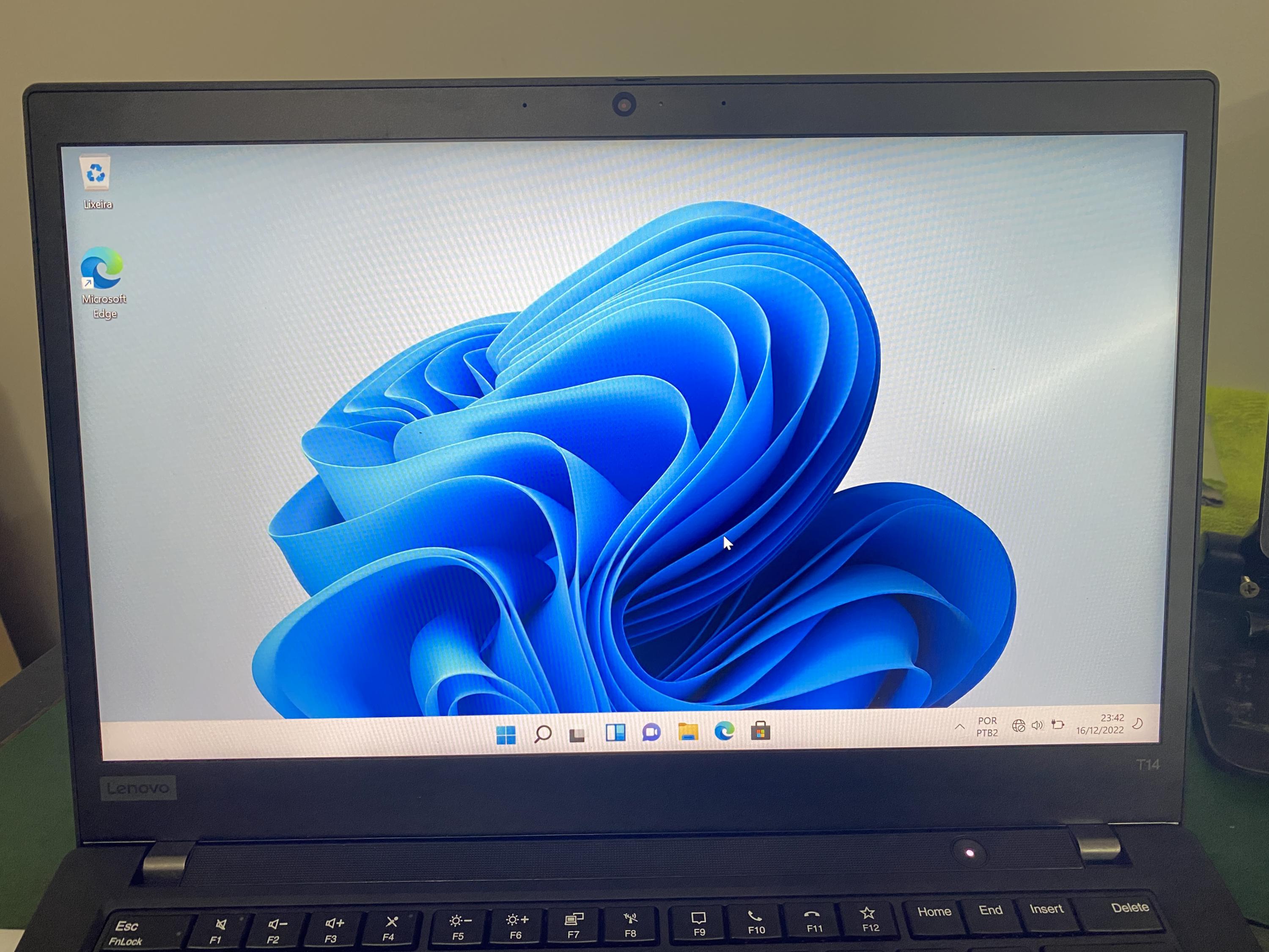

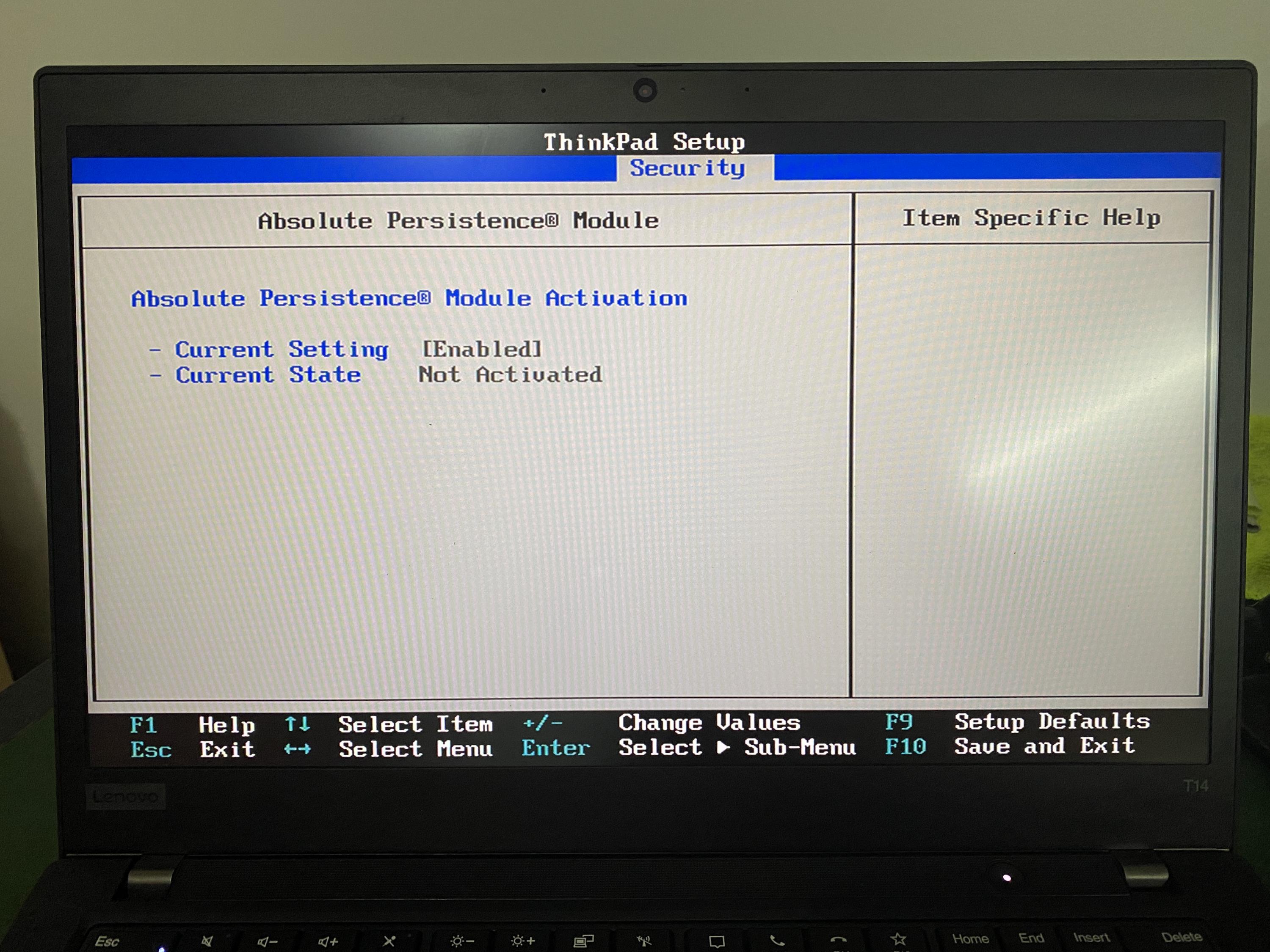

                                    #157
                                    After a lot of persistence I managed to remove the T14 bios password! I believe that few here know how to do it and no one shares it, I understand that certain types of information are not shared and are sold! But I persisted, and I come to inform you that the (Thinkpad T14 1st 20S1) was unlocked by an RT809H the only programmer I have, as I don't have access to a vertyanov. Here are the photos in the attachment, now I just need to invert the bios information, but I had taken a photo before.
