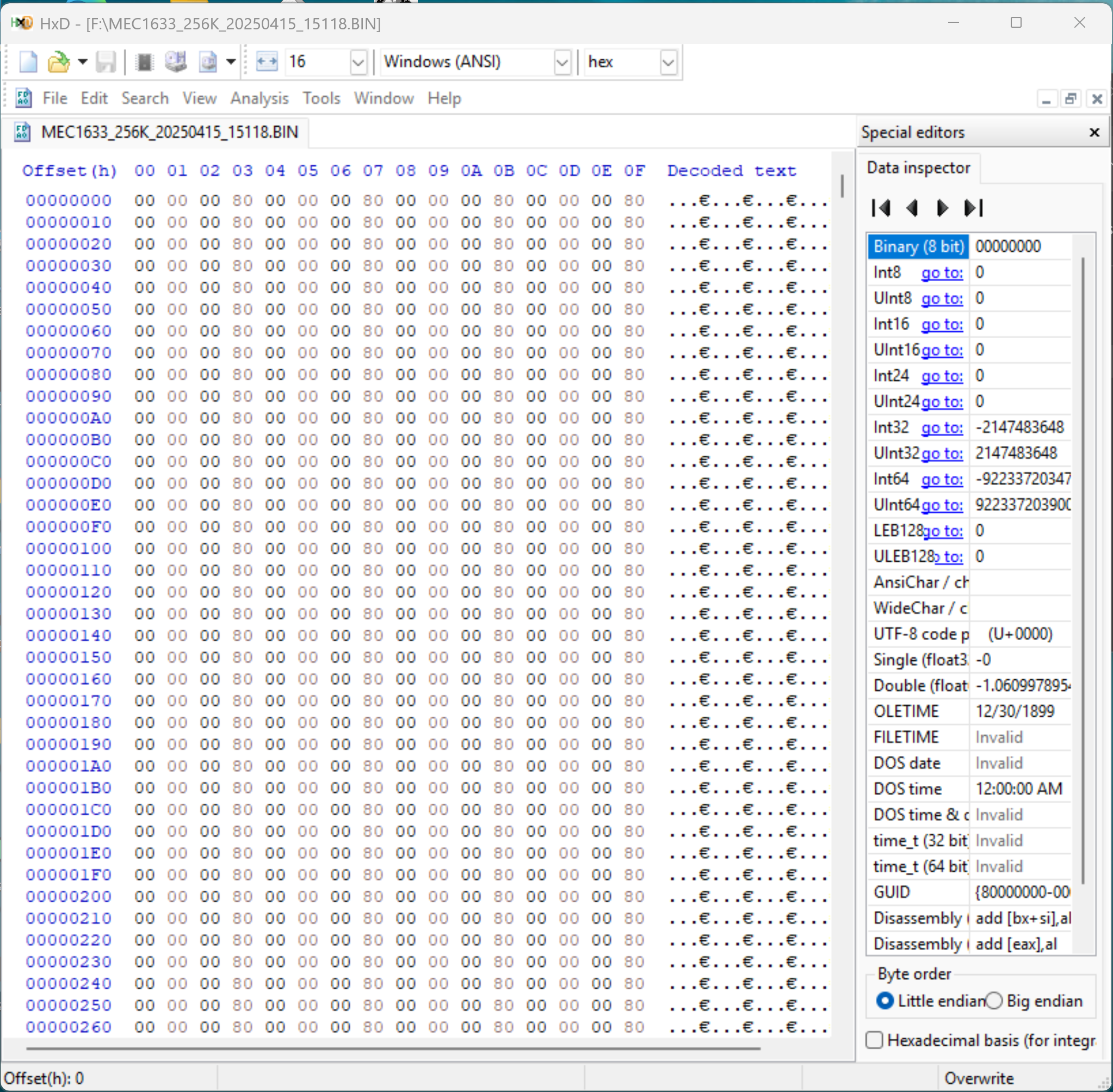

                        #451
                        Originally posted by pokyss1
                        SORRY I HAVE errer
                        sorry i have errer withe file this fil withe machin working good
                        This is what you read, from top to bottom.

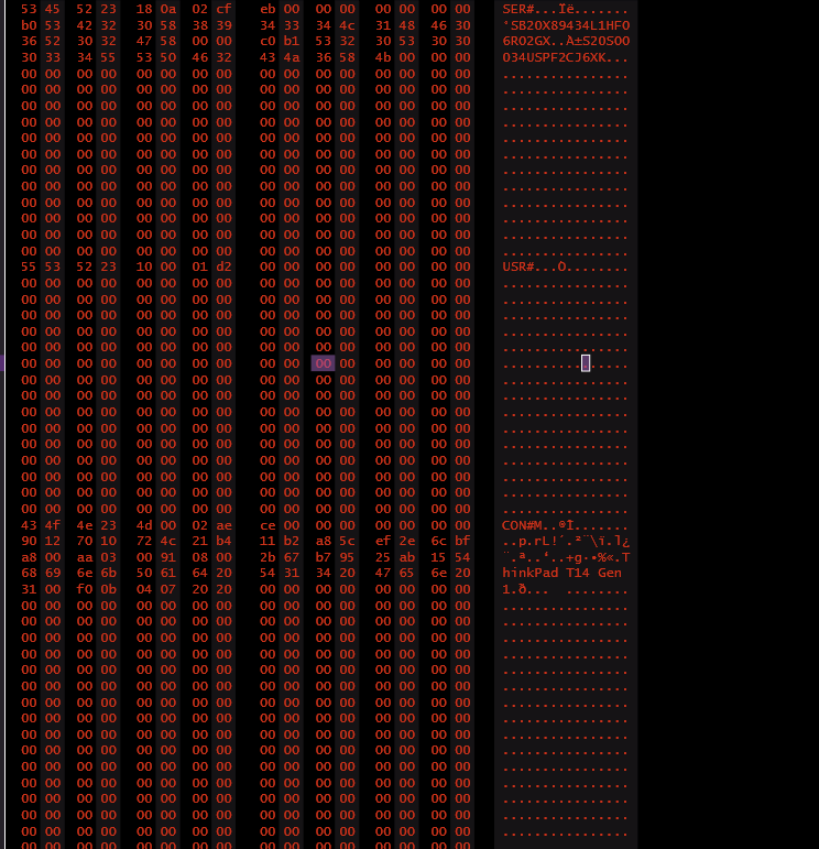

                                    I am posting the mec1663 Lenovo T14 nm-c931 1st gen intel 10th that I read, the eeprom address where the password is located is at offset 0x300.

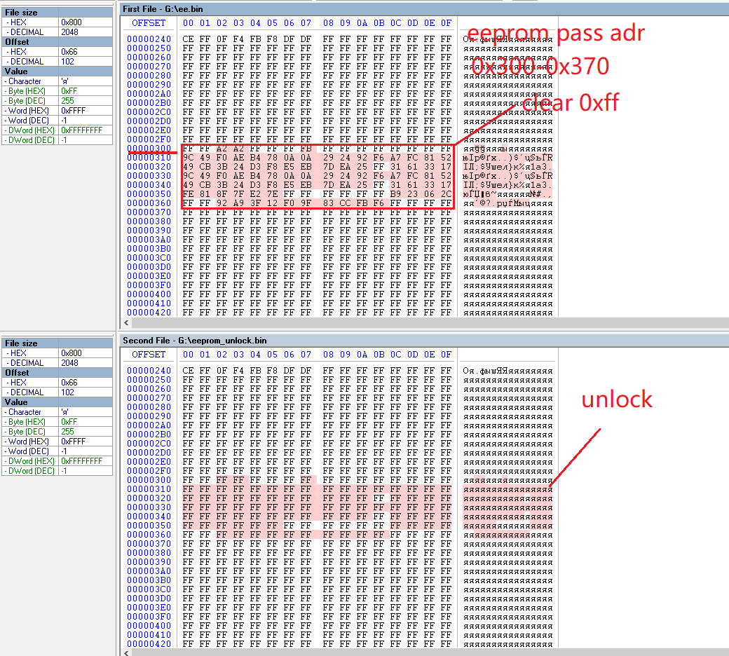

                                      lines 350 and 360 should not be deleted
                                      It's easier to find your way around with the decrypted file

                                        Thanks to everyone for the help.
                                        My case was a ThinkPad X1 Carbon Gen 7 with motherboard NM-C661. I used an SVOD3 and the pinout from the picture I’m attaching. The reset is not needed when using the pull-down resistor.
                                        In the SVOD software I selected EEPROM, and once the dump was read I changed the data from 0x300–0x34F to FF. After reprogramming, the password issue was solved.
                                        Many thanks again to all, and I hope this can help anyone else who has the same model.
