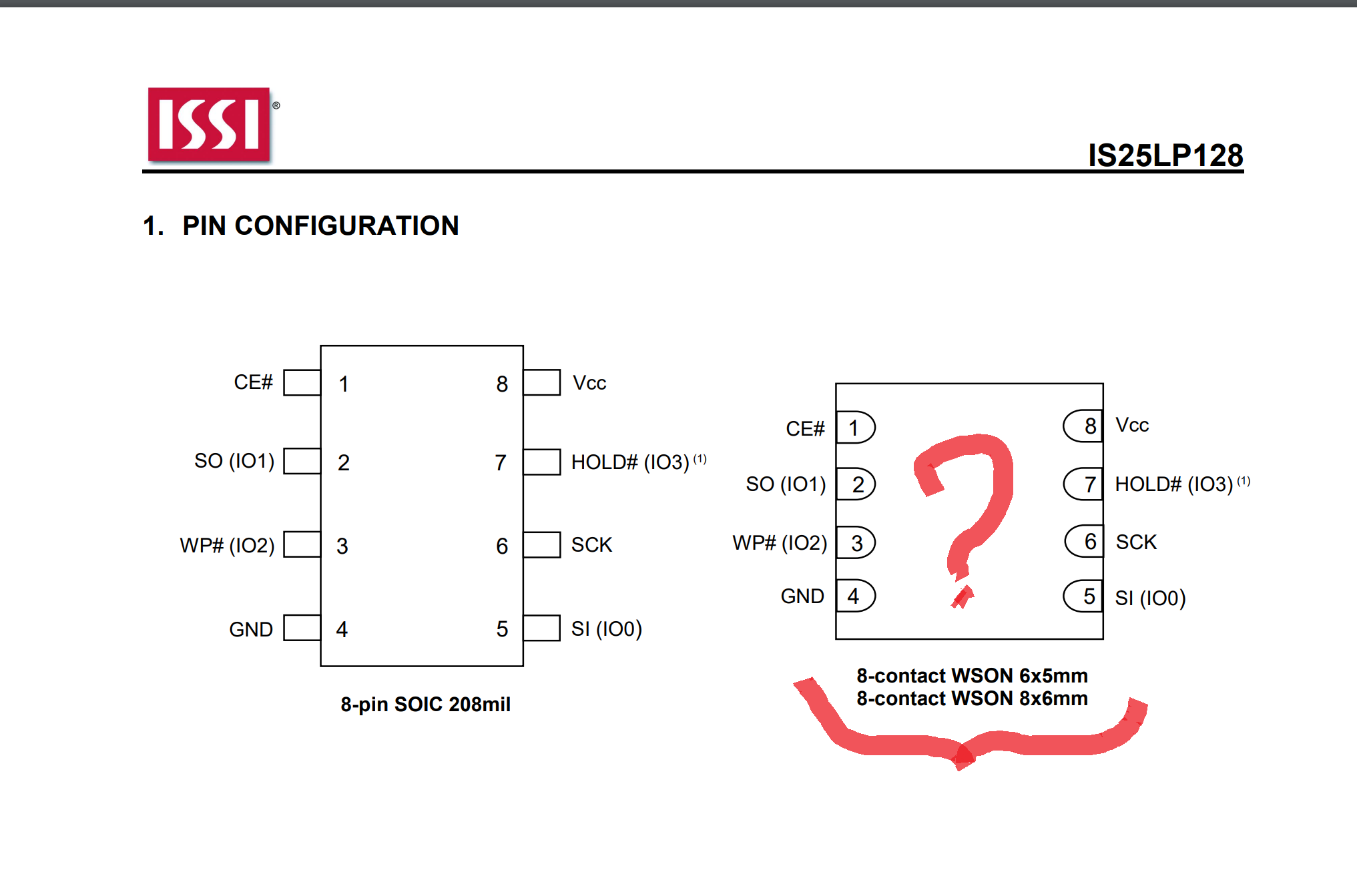

                                      Mine is wson8 6*5 and since I only have an adapter for wson8 6*8. I was asking if there is another way to unlock my bios.

                                      • hoaca388
                                        Badcaps
                                        • Jan 2022
                                        • 11897
                                        #359
                                        Only bios and EC, your computer can't be opened with bios then EC is the only way. Or you can solder wires to the extra pins to see.

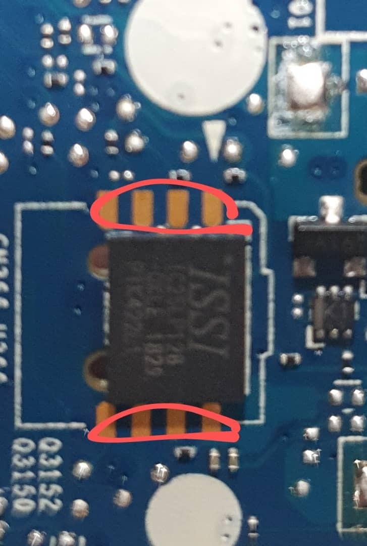

                                        • Bigherc07
                                          • Dec 2024
                                          • 13
                                          • France
                                          #360
                                          Originally posted by SMDFlea
                                          I solder wires to these pads. right?
