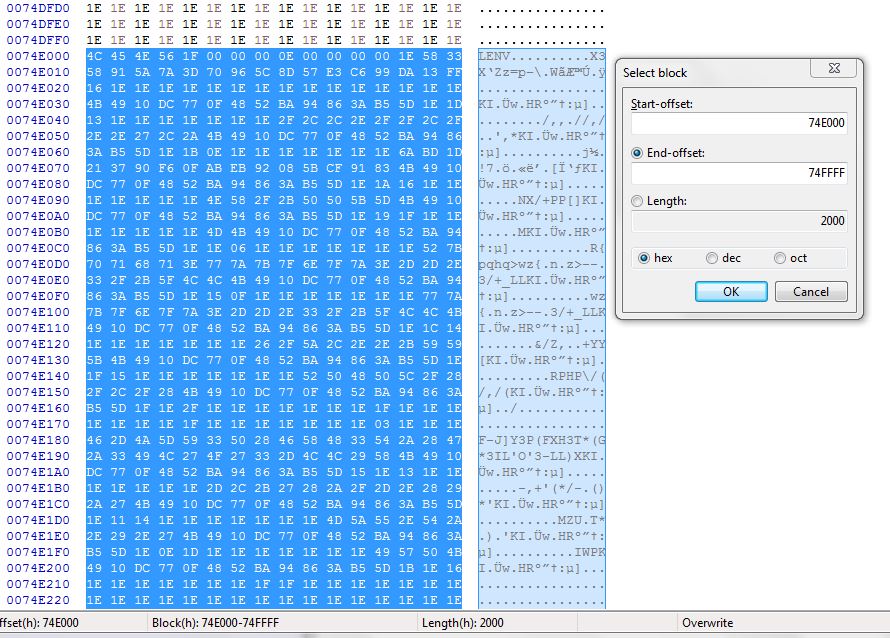

                            Re: Need bios Lenovo 300-15ARR
                            Hello
                            I created a bios yesterday exe to bin file
                            my laptop works but no serial, mtm and produkt name
                              • 22093
                              Originally posted by rifmann
                              Hello
                              Copy the DMI from your backup and paste-insert into the new bios using the off-sets provided 74E000 - 74FFFF .
