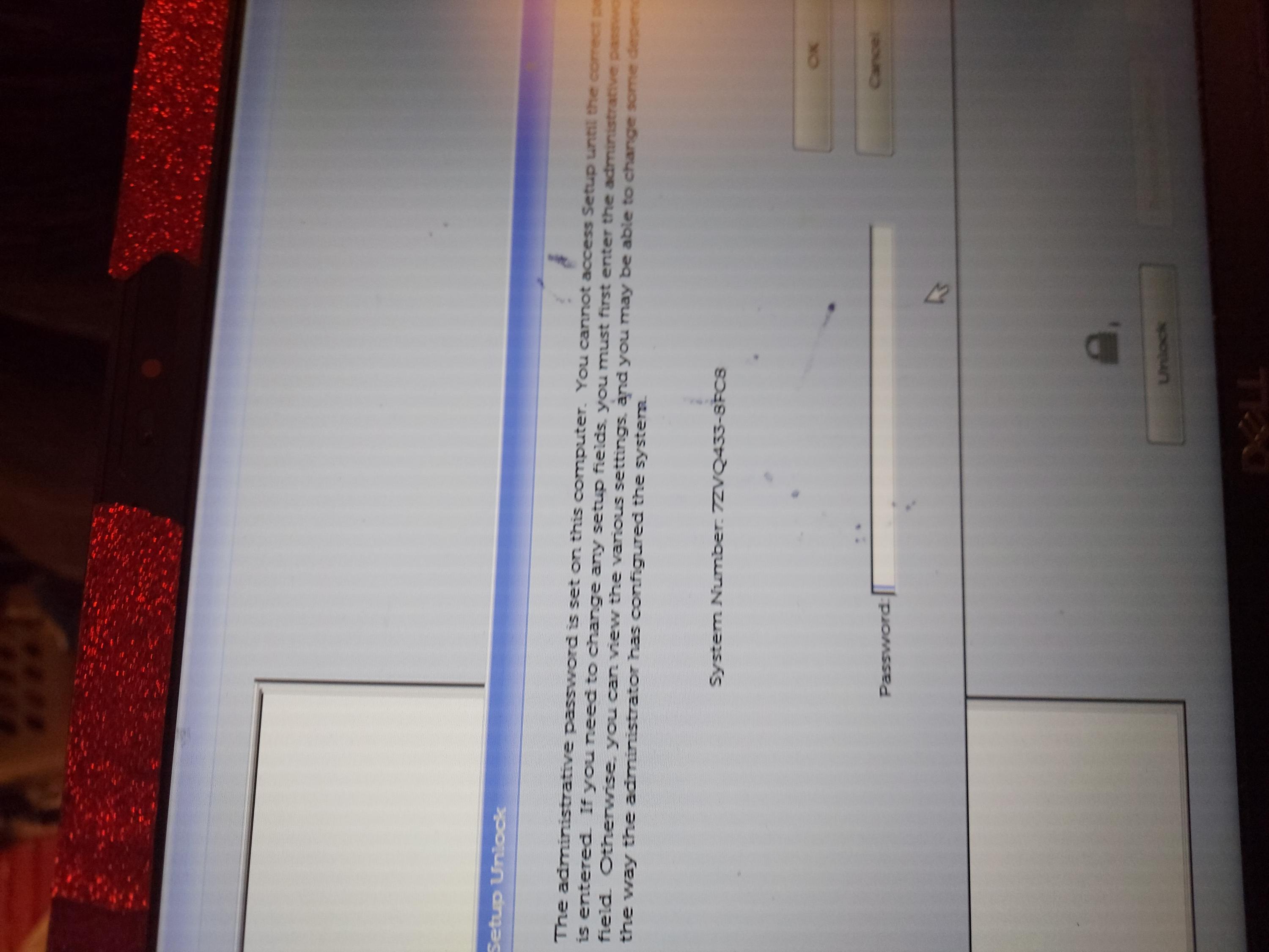

          @Imranromi Is this what you need? F72DP73-8FC8. Let me know. Thanks very much.
          • imranromi
            • Jan 2015
            • 1288
            • Pakistan
            #105
            Re: Dell Latitude 7400 Bios Password 8FC8 Suffix
            This suffix not possible to generate Master code.If you want unlock you need read bios chip find in motherboard or need bios programmer.

                        Greetings @imranromi, @karol and the many others that have provided such good info on this thread. It has been most useful and appreciated.
                        Please will you help me with this Dell 7400 bios.
                        The locked bios screen show this code: FTZ3YY2-8FC8
                        The BIN dump is attached.

                              the password bios has 32MB, not 1MB..look for the chip that has the 32MB bios on the motherboard, make a backup, check it with the HxD program to be ok, and write this bios on the 32MB chip, the 1MB bios which you posted don't go to it..if it doesn't work post the backup of the 33MB bios ..
                              • derekbez
                                • Feb 2021
                                • 4
                                • United Kingdom
                                #115
                                Thanks @peste. So far I can only find two chips that look like they are BIOS chips. 25Q80DV and 25Q80C. Both are quite close to where the SSD plugs in.
                                Please could you advise where on the board I might find the correct chip? Thanks

                                  Look for the UC5 chip, it is on the other side of the board. Marking 25B256

                                      I have a Dell LAtitude 7400 2TF11Z2-8FC8 i have managed to read the bios and created a bin file with the dump. can someone help please?
                                      I have attached the bios dump, can anyone remove the passowrd ?
                                      I am completely new to this and went through youtube videos bought a c431a programmer and after 3hours managed to finally read the chips. I have a winbond and gigadev bios chip both are on the file.
                                      Would really appeciate if anyone could help, i have been trying to get this sorted for over a year now and cant find any IT technician that is willing to help.
                                      Thanks !
                                      G

                                        Have you been able to figure out how to read the bios chip in the #uc5 position? as the format is different and the clip will not read it. the other bin files for chips 25Q80DV and 25Q80C are only 1mb so maybe i can assume these are not the ones?

                                          Hi were you able to read the chip marking 25B256? the clip does not fit as the size is different. does anyone have a solution?
