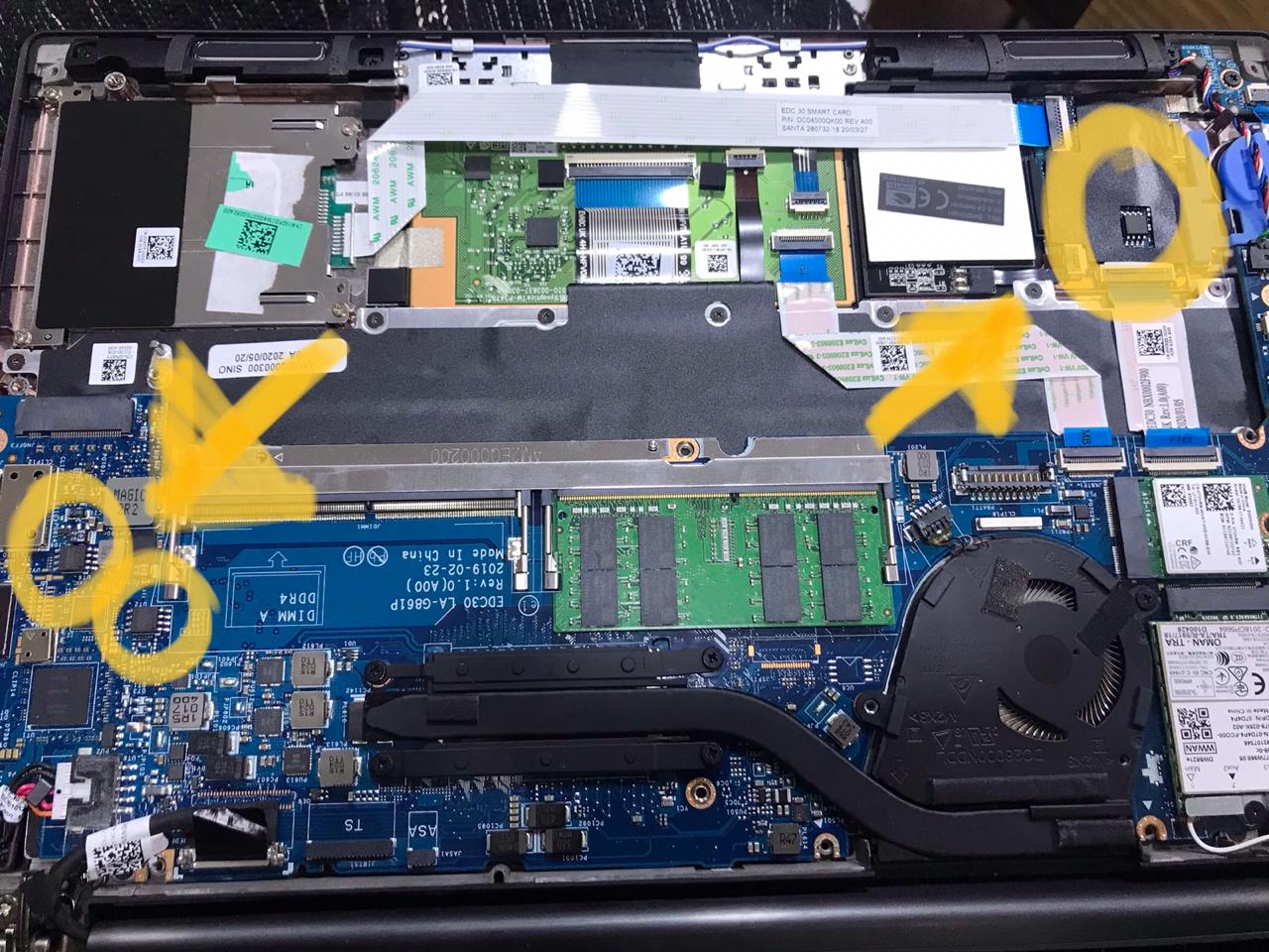

                    there is other flash chips in the motherboard is there any possibility that the password stored in one of them
                      the posts on all...

                          update:
                          it turns out that the old method work here
                          you just need a password clean dump, replace the ME region with the one from
                          the pc's original bios , flash the modified dump
                          and VOILA!!!! works like charm.
                          thanks for those who tryed to help and for anyone here in the forum.
