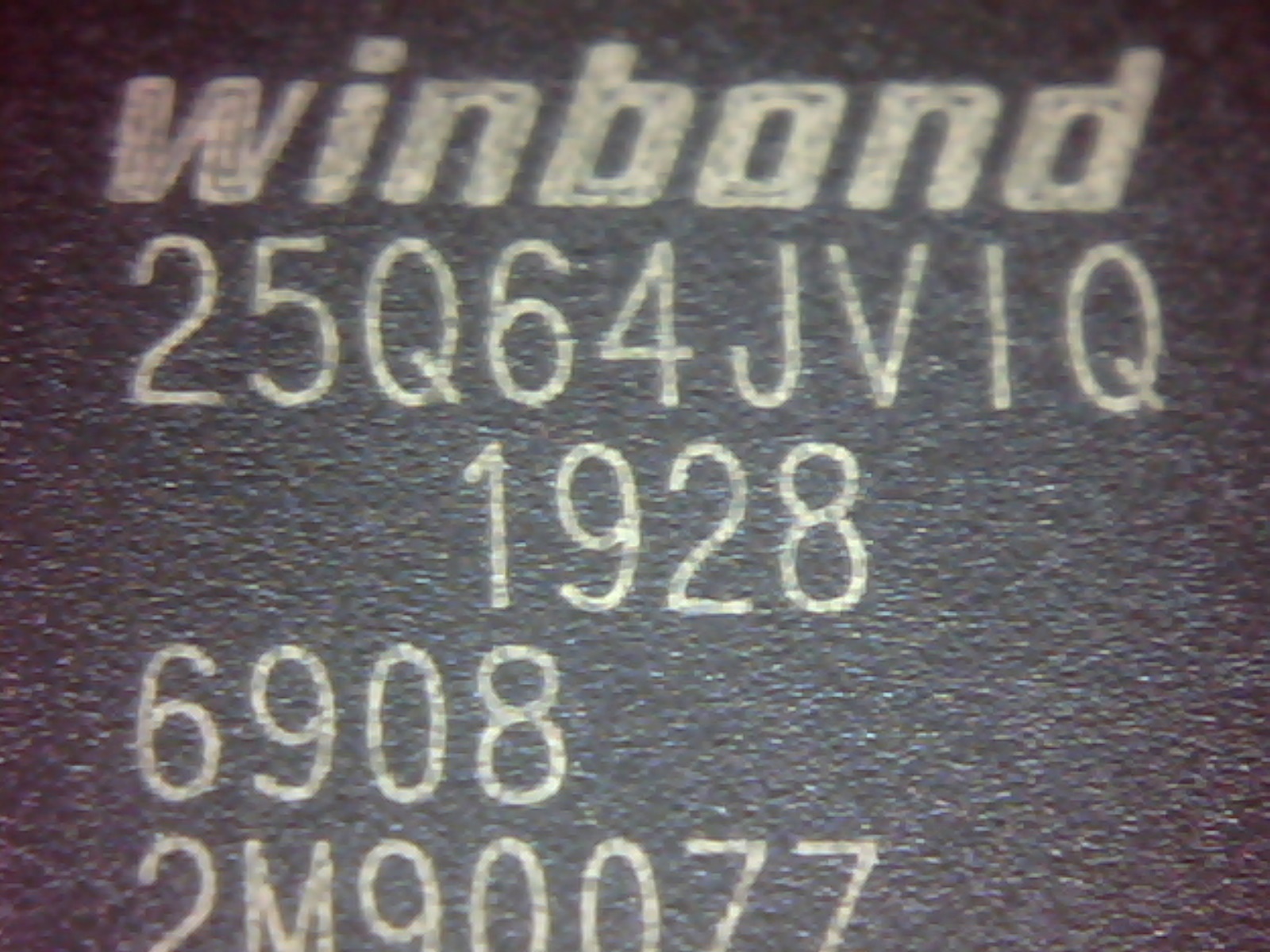

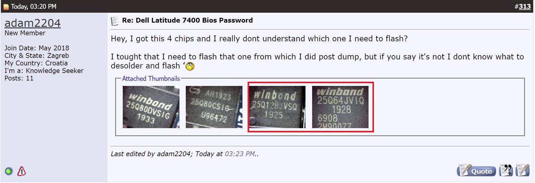

                          • adam2204
                            • May 2018
                            • 17
                            • Croatia
                            #313
                            Re: Dell Latitude 7400 Bios Password
                            Hey, I got this 4 chips and I really dont understand which one I need to flash?
                            I tought that I need to flash that one from which I did post dump, but if you say it's not I dont know what to desolder and flash
                            • hoaca388
                              Badcaps
                              • Jan 2022
                              • 11411
                              • Viet Nam
                              #314
                              Originally posted by adam2204
                              hey, i got this 4 chips and i really dont understand which one i need to flash?
                              I tought that i need to flash that one from which i did post dump, but if you say it's not i dont know what to desolder and flash
                              25q128jvsq = 16 MB
                              25q64jviq = 8 MB
                              • adam2204
                                • May 2018
                                • 17
                                • Croatia
                                #315
                                Originally posted by hoaca388
                                25q128jvsq = 16 MB
                                25q64jviq = 8 MB
                                I understand that, but all BIOS files that anyone from here post is 32MB so thats confusing me?

                                    #317
                                    Because their machine has only 1 bios chip. Your machine has 2 bios chips, total bios file size is 24 MB, it is divided and saved into 2 chips respectively.
                                    • adam2204
                                      • May 2018
                                      • 17
                                      • Croatia
                                      #318
                                      And is there any way to flash that chips?
                                      • hoaca388
                                        Badcaps
                                        • Jan 2022
                                        • 11411
                                        • Viet Nam
                                        #319
                                        Is it that difficult ? I see you have read a 16 MB chip already, the rest is to read the 8 MB chip and post it here. Where is your programmer ?
                                        • adam2204
                                          • May 2018
                                          • 17
                                          • Croatia
                                          #320
                                          Oh sry I didnt understand that I just need to post other BIOS.
