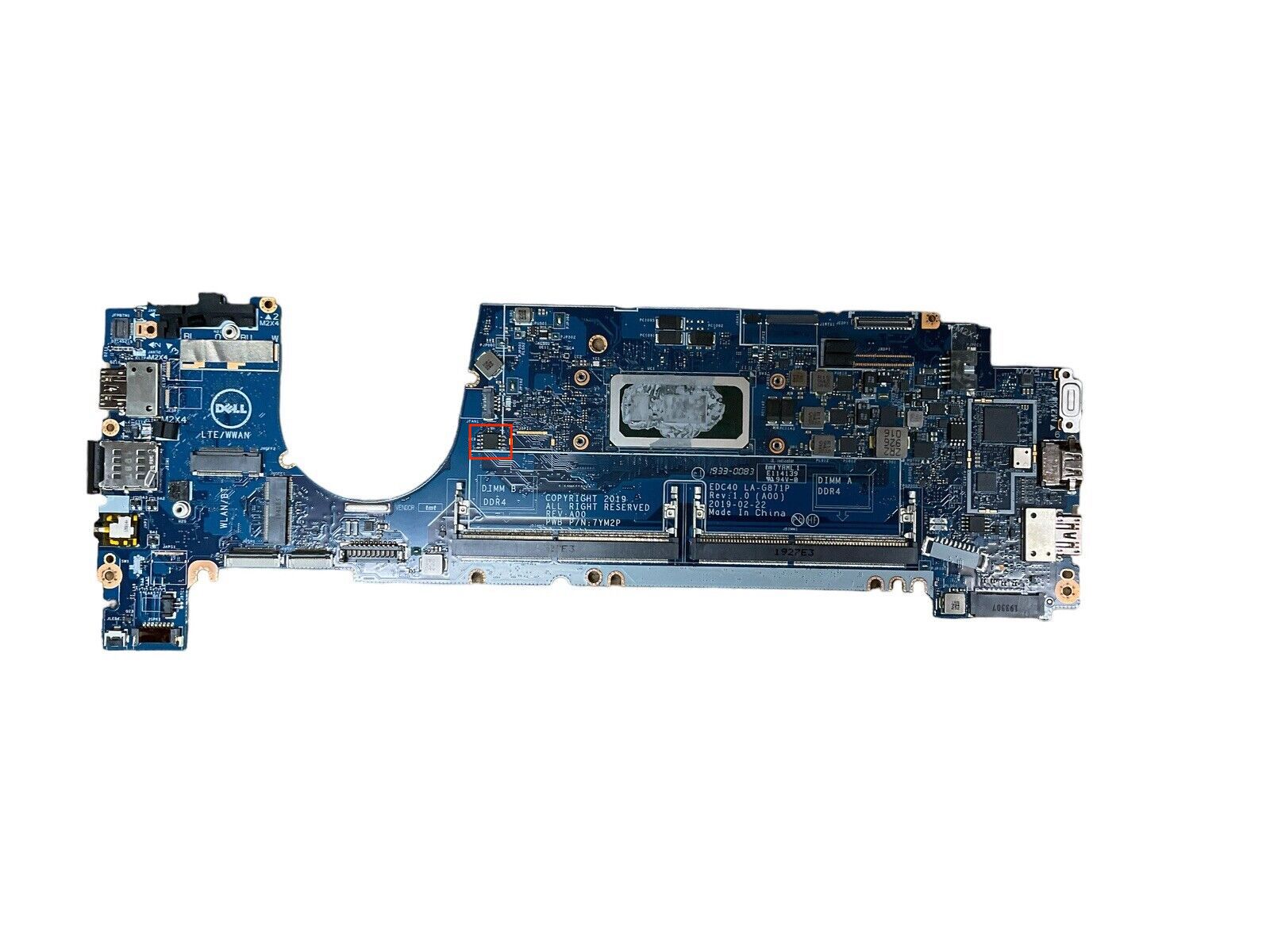

                                  • volinakis
                                    • Jan 2021
                                    • 2668
                                    • N/A
                                    #457
                                    Re: Dell Latitude 7400 Bios Password
                                    Originally posted by LeonCass78
                                    Think I have found it
                                    nope, try the one marked with red square.
                                    • LeonCass78
                                      • Oct 2022
                                      • 9
                                      • Hampshire
                                      #458
                                      not present on my board.
                                        • 20481
                                        #459
                                        You`re right it was the wrong chip,its the thunderbolt firmware,no wonder it compressed so much.I expected UC5 or UC6 would have been posted.
