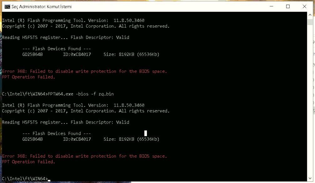

    Hi
    Battary Healt %98
    Ac unplug and system power off
    fix
    Serial Number : J4N0CV05Z931169
    X542UR-DM399
    Please help me

          Re: ASUS X542URR-DM399 Clean Me Bios Need
          put the original bios here ...
              you need the original, you sent me what's on the site at Asus.

                https://www.badcaps.net/forum/showthread.php?t=60659
                i read this post. but no any bin file BIOS_region.rng does it work
                or Where can I get what you want?
                  I need the original bios, the one who had the laptop ... the corrupt one ...
                    Yes, sir. with which program can I add a backup? with the help of which software can do it. ?
                    • peste
                      • Dec 2016
                      • 12621
                      • ROMANIA
                      you need to buy a programmer for reading and writing bios (ch 341, TL866, etc) ... find more information on the internet about programmers ... after which you get the job ..
