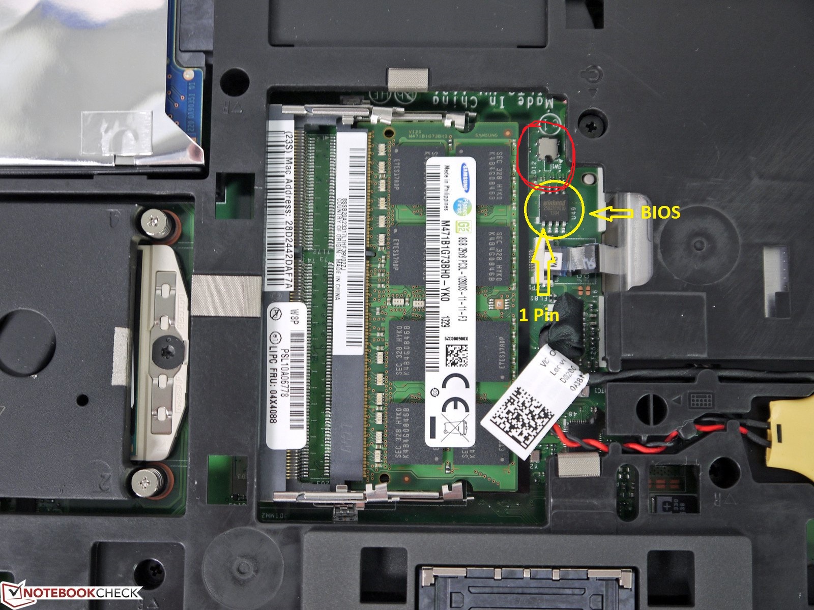

              • digitalpc
                • Jun 2016
                • 305
                • .DLL
                Re: lenovo t440p bios password
                Originally posted by 530v8
                Did you push the button on the Mainboard
                There is a small dip switch if 💻 body dissambeled it won't start.
                When not need to patch bios again just wait a lil bit
                dip switch? look my pic with red, is that

                  • 530v8
                    • May 2019
                    • 39
                    #29
                    yes this one also cmos battery and intern battery plug them out
                    this solved my problem
                    then start laptop and press f1 after that it says press space then press space again
                    it will say TPM certificate changed
                    _ -- this symbol will appear after that flash your original bios back and enjoy
