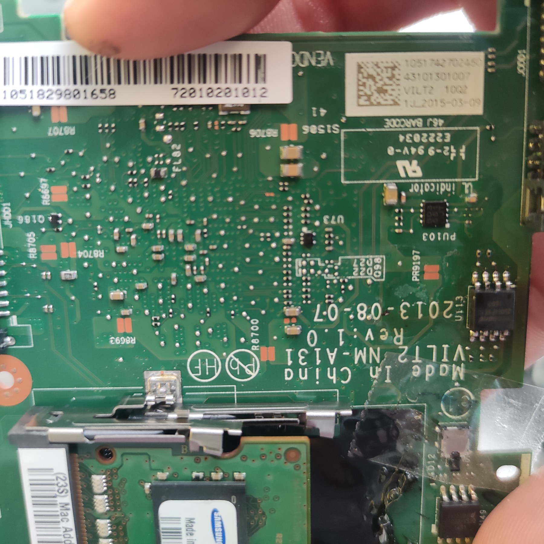

                                    Bios backup on lenovo T440P
                                    Hi guys,
                                    I'm trying to save/dump a T440P bios chip (winbond 25Q32FVS) however i'm not succeeding in reading the chip.
                                    I've use 2 different CH341A SOHIC8 programmer, i've tried the clip provided and also unarity clips to ensure the connection was proper. I've modded one CH341A in 3.3V, same result
                                    Computer and bios batteries are removed however, no way to detect/read the chip using the programmer software. Am i missing something?
                                    The laptop is working perfectly fine but i need to get ride of this supervisor password...
                                    Any help appreciate

                                      #118
                                      Re: Bios backup on lenovo T440P
                                      What sort of clip are you using, is the chip SOIC8 or WSON8
                                      • Grigan27

                                        Re: lenovo t440p bios password
                                        It's HP clips
                                        I tried initially with the black clip provided with the programmer but it was too complicated to fix it properly with my big fingers
                                        It's SOIC8 here

                                          #120
                                          It's HP clips
                                          It's SOIC8 here
                                          Interesting setup
                                          AFAIC see the chip is nor properly connected to the programmer, hence the problem.
