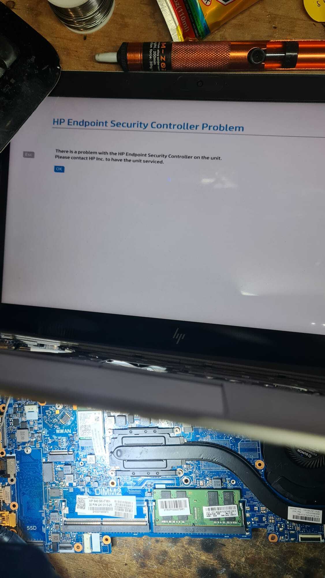

                • tiagofernandes
                  • Mar 2015
                  • 13
                  • portugal
                  #691
                  Please rework my original bios, i tested bios from internet and lapto is worked but "hp error endpoint securtity"
                  original bios
                  please rework my bios and link to pay please. Ths

                    #692
                    try and https://www.badcaps.net/donate

                      #693
                      thank you very match but "problem hp endpoint security controller problem" persist
                      i have write file 16mb original ?

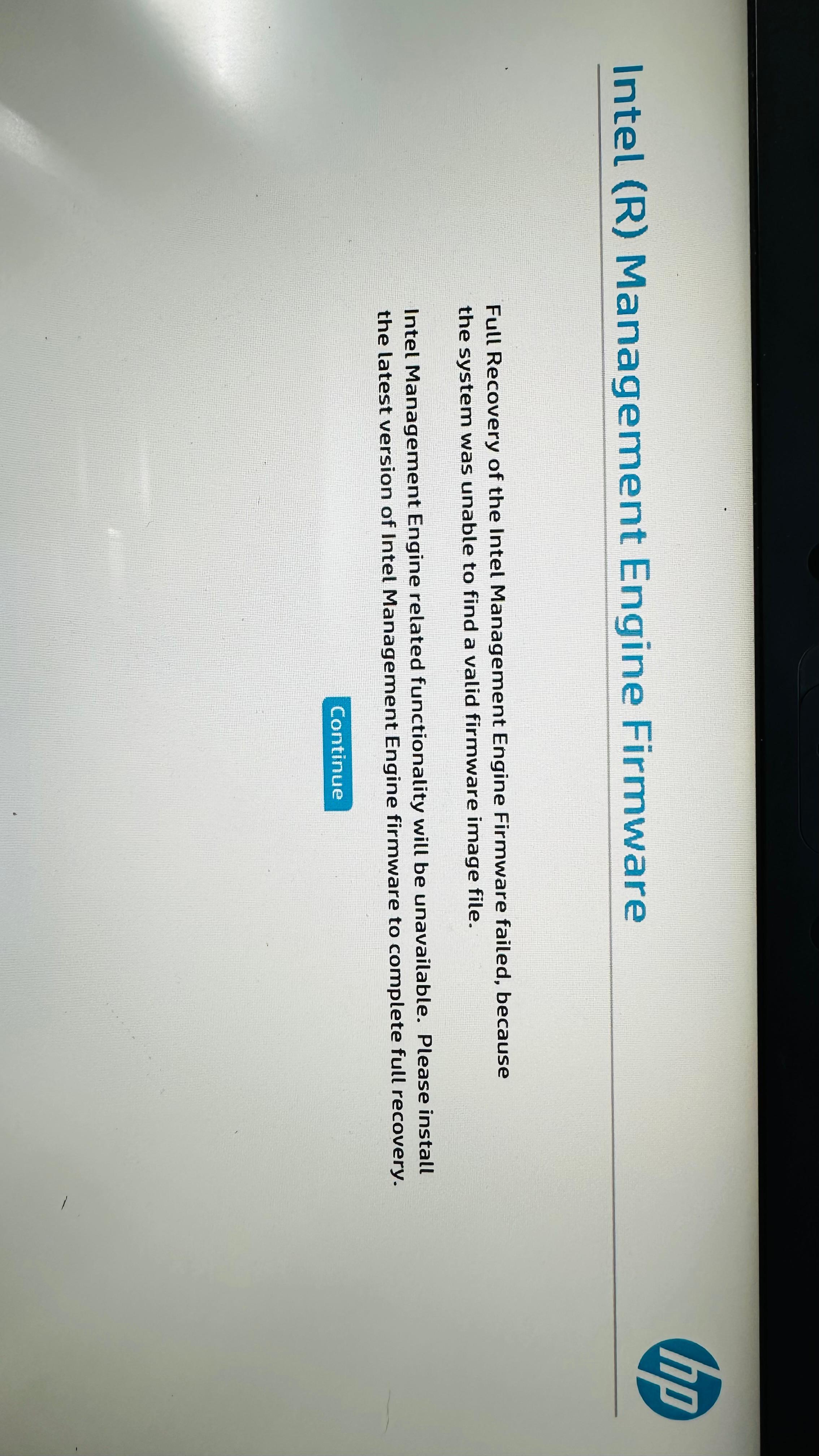

                        #694
                        dears
                        please clear this issue hp elitebook 840 g6 laptop this show the error below
                        "Full Recovery of the Intel Management Engine Firmware failed, because the system was unable to find a valid firmware image file. Intel Management Engine related functionality will be unavailable. Please install the latest version of Intel Management Engine Firmware to complete full recovery."
                        uploaded bios
                        sn 2TK948088N

                          #695
                          Originally posted by kodinabeel
                          dears
                          uploaded bios
                          sn 2TK948088N
                          Try clean ME 12.0.97.2608

                            #696
                            sorry m1ch43lzm the result is same

                              #697
                              This dump worked for me, please try and provide some feedback.
