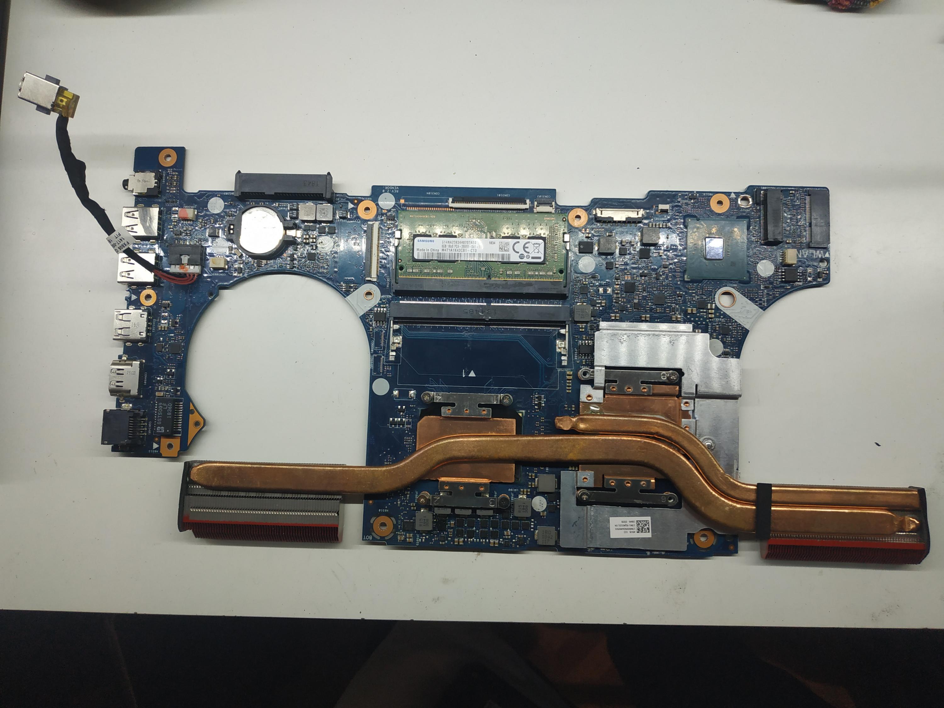

    Hello all friends
    I need bios for Asus FX705G, Motherboard Number : ( FX505GD/MB REV:2.0 ) Size : 16MB
    Thank you.

        Re: Please I need bios for Asus FX705G
        Post your bios backup .

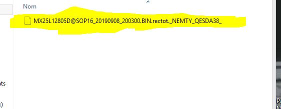

          Hi my friend, I kept a backup of the same device, and now that I need it, All my file is encrypted with virus ransomware, but I still have the file, but it is encrypted
            just rename your file cut all the content after BIN then u can use again this file.
            if the file size same then it should work

              My brother, I tried this solution before I put the topic in the forum, but to no avail.
              The file algorithm has changed completely.
              Thank you.
                      Originally posted by peste
                      try..

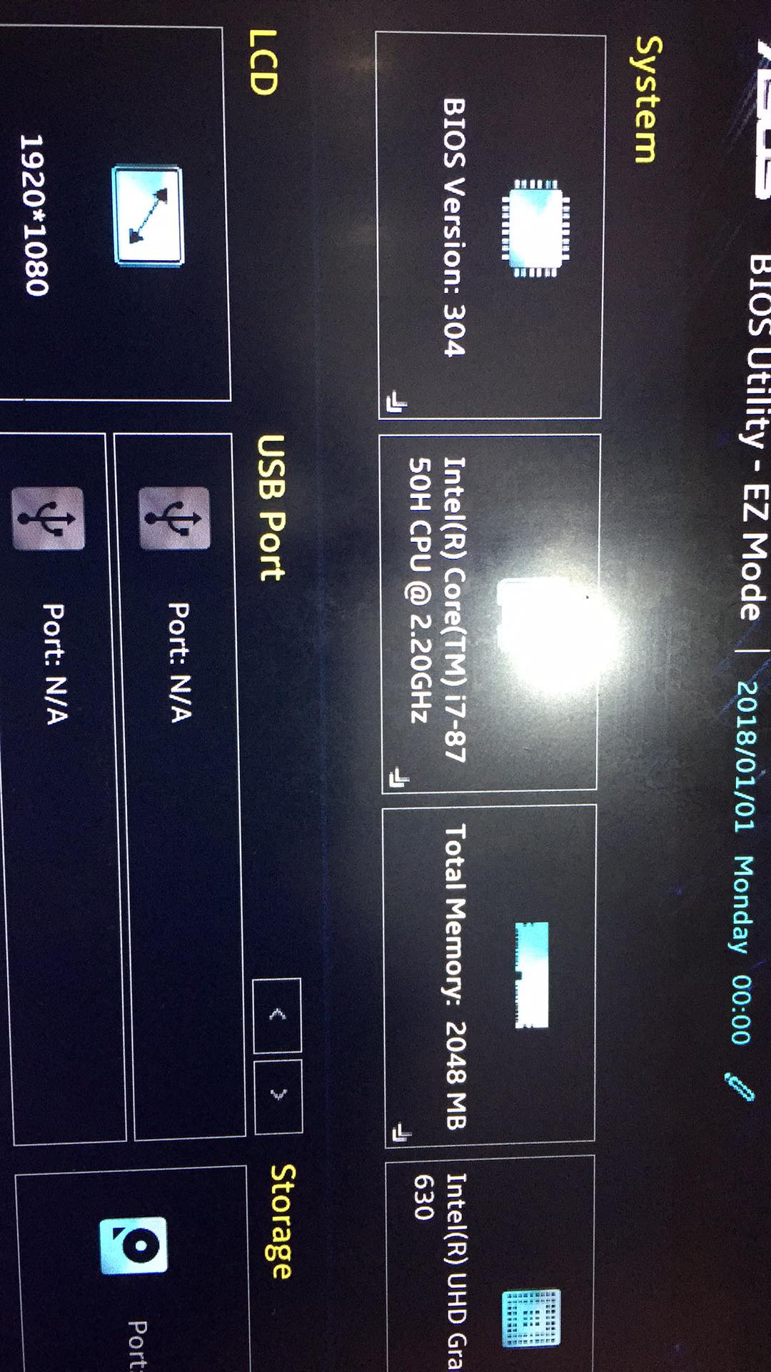

                      i tried your file and it's working but i need to wait for almost 20seconds for the display to appear. could you clean the ME region? thanks...
                          And with problem on NVIDIA chipset.. i can't install the driver... i attached my backup that if it's still fixable.. thanks.
                              try..

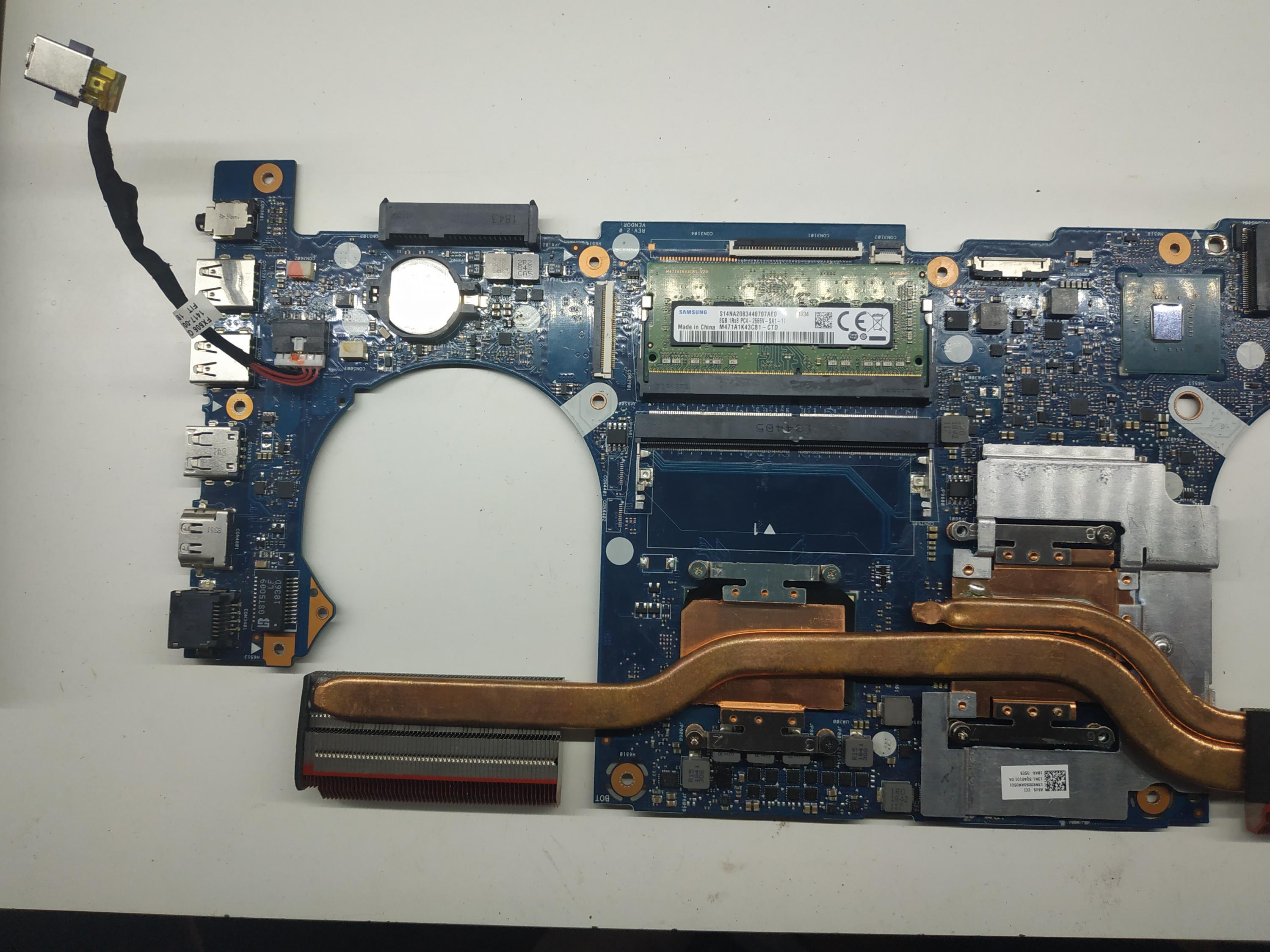

                              Tried but it won't power up. you just cleaned my backup? my dump is somewhat a damage file.. maybe it needs to be repaired first. i compared it on your file that you previously posted. but your file had a delayed image on startup and i can't install the nvidia chipset driver.. thanks
                                • 22293

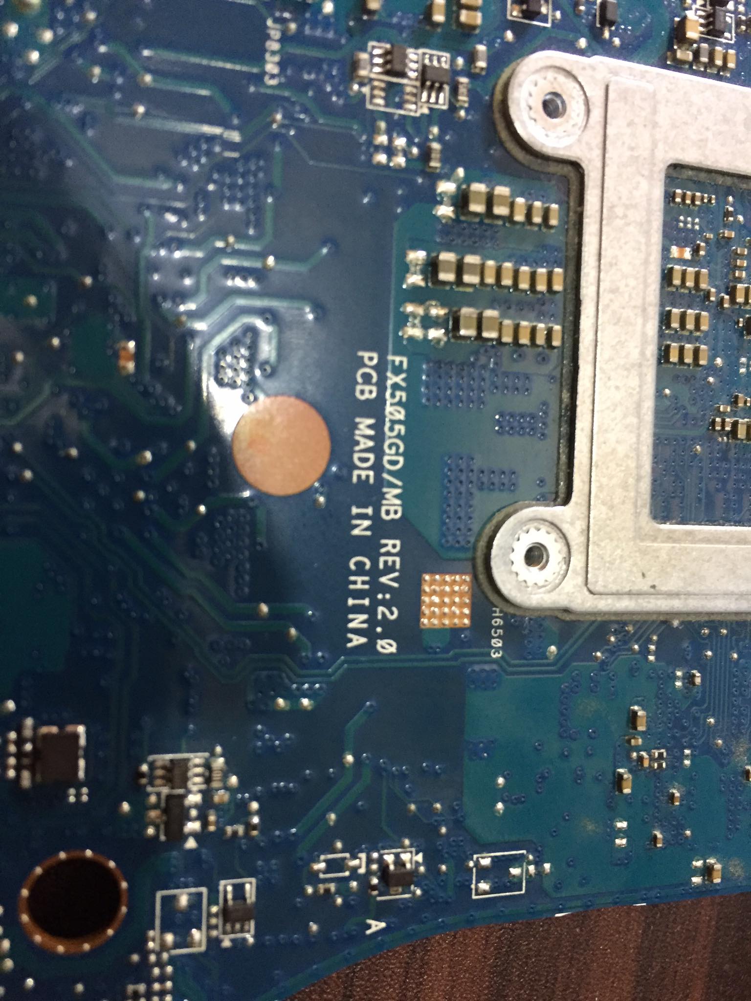

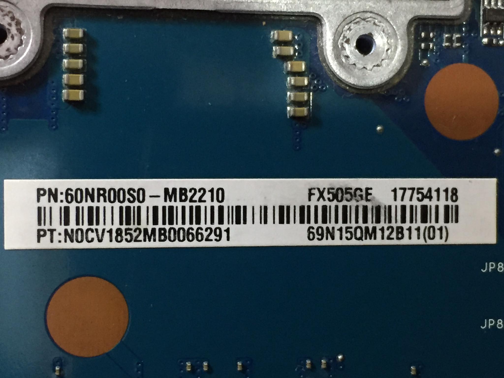

                                Post the silkscreened motherboard part number and revision, also post pictures of any barcode or QR code stickers on the motherboard
                                    try..
                                    This one is working and the startup is now normal... i'll try if it fixes the nvidia driver issue.. thank you very much for your efforts...
                                      try..

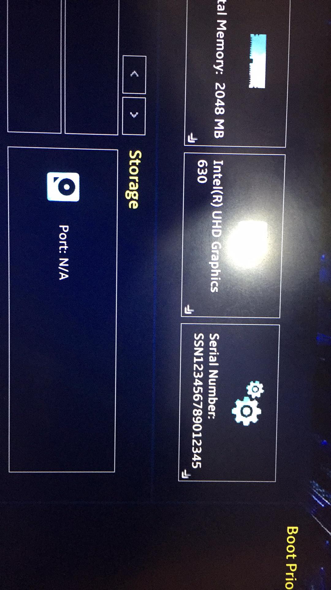

                                      with this file it can't detect HDD nor SSD nor M.2 SSD.
                                      • rbvndonh
                                        • Mar 2021
                                        • 162
                                        • B
                                        Guys, what effect of bad BIOS do you had on this board? No light, no switch on reaction or something?
