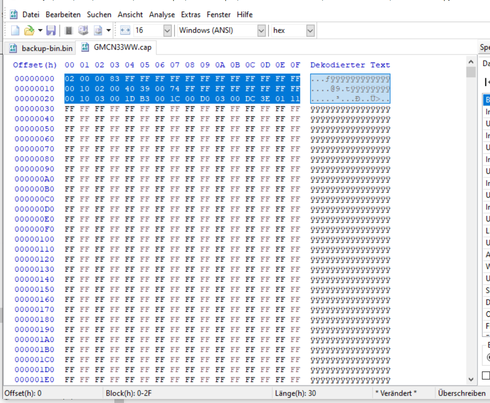

            Re: How to extract and edit a Lenovo Phoenix TDK Bios
            Originally posted by SMDFlea
            Just a sidenote: Some other phoenix bios headers need cutting from 0-1E7 (length 1E8),after selecting the bios/bios update length check the last hex line of your backup to make sure it matches.
            NEW SIDENOTE:Some newer phoenix bios headers need cutting from 0-31F (Length 320)
            How do you determine where to cut? Or do you HAVE TO have a dump from a working IC first to match up to? Please tell me that's not the case!

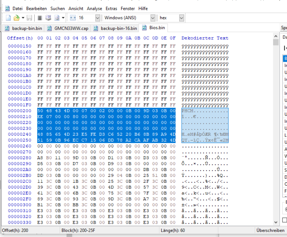

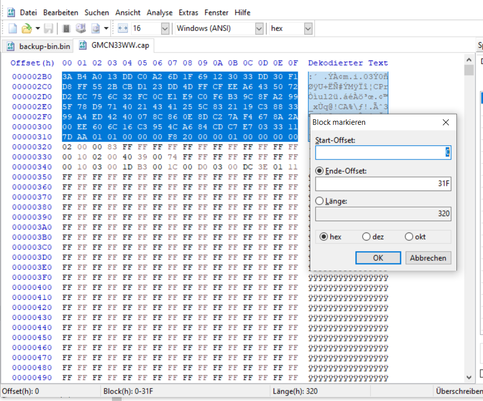

              SMDFlea, thank you for this guide! It helped me to extract a BIOS bin file for my Thinkbook 13s G3 ACN that got bricked due to a failed BIOS update. The BIOS on my Thinkbook is a 16MB large file, so i had to adopt the process in the Hex editor in order to make it work. I read the old bricked bios bin with a CH341a programmer.
              As a noob i found this forum post through google. I will leave some notes for other noobs, hope that it helps someone to unbrick their device after failed bios flash.
              1.) extract cap file from Lenovo BIOS exe installer like described above
              2.) open cap file in HxD hex editor, select area to cut (strg+e). Set start offset to 0 and end offset to 31F (Length 320). Delete selection.
              3.) compare the first three lines of your backup bios.bin file with the first three lines of the file you are editing. This step is to be sure that the cut point 31F is the right one in your case.
              4.) select 16MB of Hex data: strg+e, offset 0 to FFFFFF , copy selection to new file
              5.) in my new hex file i did a comparison with my backuped bin and checked line 200 to 250 to see if both looked the same
              6.) after i was sure that the beginning of my new bios file had the same structure like my backuped bios bin i saved the new file as bios.bin.
              I flashed this bin using the CH341a programmer tool. I used the software version CH341A v1.31(1.4) (CH341AFree). After setting the chip size to 128Mbit/16MByte the chip was detected without fuss. The Bios Chip on my device is a Winbond W74M12JW with an additional authentication layer. But for flashing it is the same as any Winbond W25xx SPI flash. Source: Reveltronics Forum - W74M Authentication Flash (W74M12JV, W74M12JW)
              Flashing the bios worked like a charm. My laptop started and showed the lenovo logo. I was able to enter the bios.
              Few flaws after flashing the clean bios file to my device:
              - I had to set model and serial number with Lenovo U1 tool and create a new UUID
              - My windows oem license key shows got lost
              - Fingerprint sensor seems to work, but my old windows install won't log in through Fingerprint anymore.
              - Keyboard backlight toggle through FN + space doesn´t work anymore
              - some online services (like google drive) that use the UUID for authentification had to be set up again
              - I am still in Bios setup mode and don't know how and why to switch to user mode

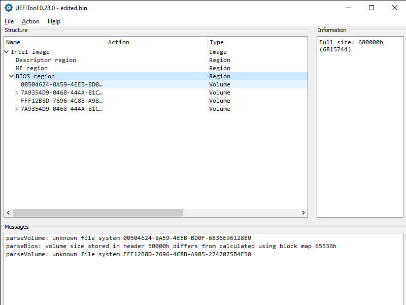

                          Originally posted by ranixon
                          Hi, I have a Lenovo Ideapad U310 Type 4375 and I extract the BIOS to flash it with my programmer (CH341a). This notebook's BIOS has a really awful bug, when Windows enters in recovery mode, the BIOS becomes inaccessible. This was solved in the 65CN99WW version (you can see it here, in the update notes), but as you can imagine, this notebook has an older version (65CN13WW) that now is inaccessible due a Windows problem. I tried to update it from Windows but it impossible (Windows 10 x64 in UEFI mode, as the readme says).
                          I followed the instructions in this thread but it didn't worked, I don't know if was because I did something wrong or because this BIOS has a different header size. I tried three times without success, the notebook doesn't power on, just a few leds and then it power off. So I re flashed the backup again and the notebook still working, but with the bug.
                          In the attached zip file there are various files. "backup_65CN13WW.bin" is the back that I made with my programmer. "65cn99ww" is the newest BIOS from the Lenovo site and in the "ext" folder is the previous BIOS extracted.
                          Scroll all the way to the bottom of your backup and copy the hex from the last line: 0F 09 E9 6B F9 00 00 00 78 56 34 12 00 00 F5 FF ,search in the 65CN99WW.cap for the same hex.Thats the end of the bios.The line below starts at 8001D0 ,we can delete 0-1CF (Length 1D0) at the top,thats the header.It gets a bit more complicated after that as you might expect the top of the file now to match the top of your backup with similar hex but its all FF`s.Scroll down until you find the first big chunk of hex,its starting at 1D0000 .The end off-set of your 8MB backup is 7FFFFF ,select 1D0000 and 7FFFFF off-sets in the update,copy and save into a new file.It isn`t a full bios image,only a bios region.You can copy that over your old bios with a hex editor or use UEFITool 0.25 to replace it.The update also has an EC update, offsets 800000 - 81FFFF (length 20000). To copy your DMI,the serial number etc,open the bios with UEFITool and copy/replace the first padding area, or use a hex editor using offsets 180048 - 183FFF
                          • ranixon
                            • Oct 2020
                            • 3
                            • Argentina
                            #33
                            Thank you for your answer. I selected the regions, but both sizes are different. 6815744 for the backup, and 6488064 for the region. Should I replace only a part of it or I selected more than I should
                            Copied section
                            Backup
                            The padding area in the BIOS that I copied?

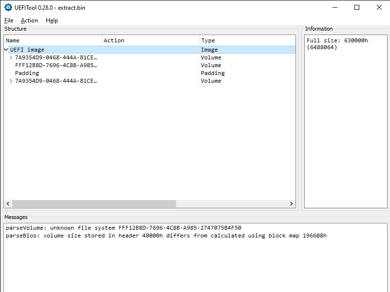

                                  great thread, I followed the procedure to extract the bios but ended with a file 8193bytes, and I understand its supposed to be 8192, where did I mess? tried it twice, will cut one byte from the top, then one from the bottom, and check. just asking this as a curiosity. thank you. sorry to resuscitate this one, not trying to necropost, just thinking other people might have the same issue in 2023, thanks. (Lenovo B80 40 LA2092P Rev 3.0)
                                  • peste
                                    • Dec 2016
                                    • 13377
                                    • ROMANIA
                                    #37
                                    yes... the extracted bios is longer... use the HxD program (which is free) and cut it to the correct size (cut the header)... keep reading.. you also have pictures .. SMDFlea explained very well.
