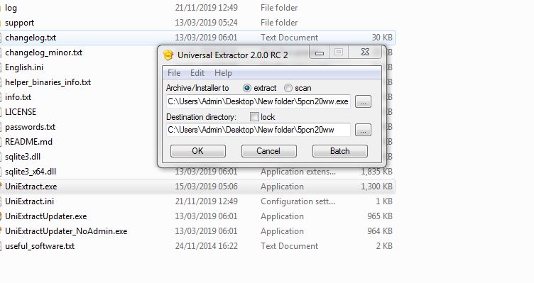

    Extract the 5pcn20ww.exe using UniversalExtractor RC2 ,or innoextractor from github.
    https://github.com/Bioruebe/UniExtra...ExtractRC2.zip

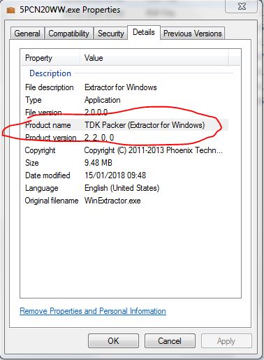

    After you`ve extracted the first exe check if the 5PCN20WW.exe is a phoenix TDK bios by looking at the file details,right click on the exe - select properties then the details tab.

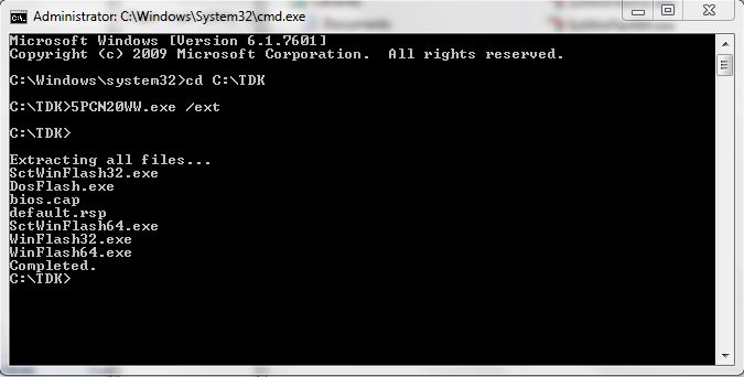

    Next,make a new folder on your C: drive called TDK,then move or copy the 5PCN20WW.exe into that folder,then you need to use the command line,as admin, and change to the directory of the TDK folder.Press the enter/return key after each of the commands:
    cd C:\TDK
    5PCN20WW.exe /ext
    Now you should have a bunch of files inside the TDK folder including the bios (bios.cap) capsule.The capsule header needs removing but cannot be extracted using UEFITool,which is one of the popular methods to remove a capsule header from some bios vendors so it needs editing with a hex editor.

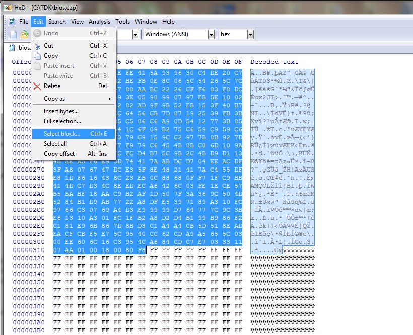

    I use HxD,its free and the latest version includes a portable edition: https://mh-nexus.de/en/downloads.php?product=HxD20

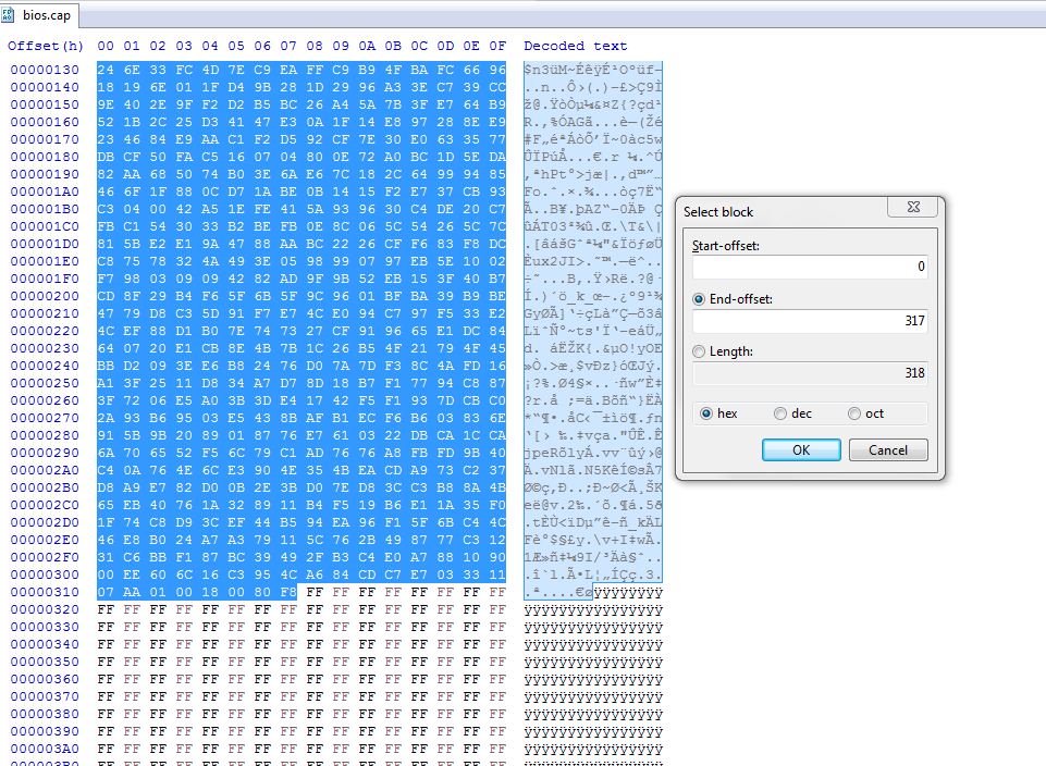

    Open the file bios.cap with HxD. Click on Edit - Select block or use Ctrl+E .The length of the header we need to remove in hex is 318 ,set the Start-offset at 0 and the End-offset at 317 and click on OK . Delete the selected part using Edit - delete ,or the Del/Delete key on your keyboard.

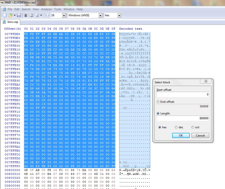

    Next, select Edit - Select Block or Ctrl+E and set the Start-offset at 0 ,click on the Length button and enter 800000 (as the length), or choose the End-offset instead and set to 7FFFFF.
    Next, select Cut or Copy. Make a new file using Ctrl+N or File - New ,then select Edit - paste insert or Ctrl+V to paste into the new file.
    Select Save or Save as to save the new 8,192KB 8MB bios.
    Just a sidenote: Some other phoenix bios headers need cutting from 0-1E7 (length 1E8),after selecting the bios/bios update length check the last hex line of your backup to make sure it matches.
    NEW SIDENOTE:Some newer phoenix bios headers need cutting from 0-31F (Length 320)
    Another new sidenote: Some older bios updates have a header from 0-1CF (Length 1D0)
